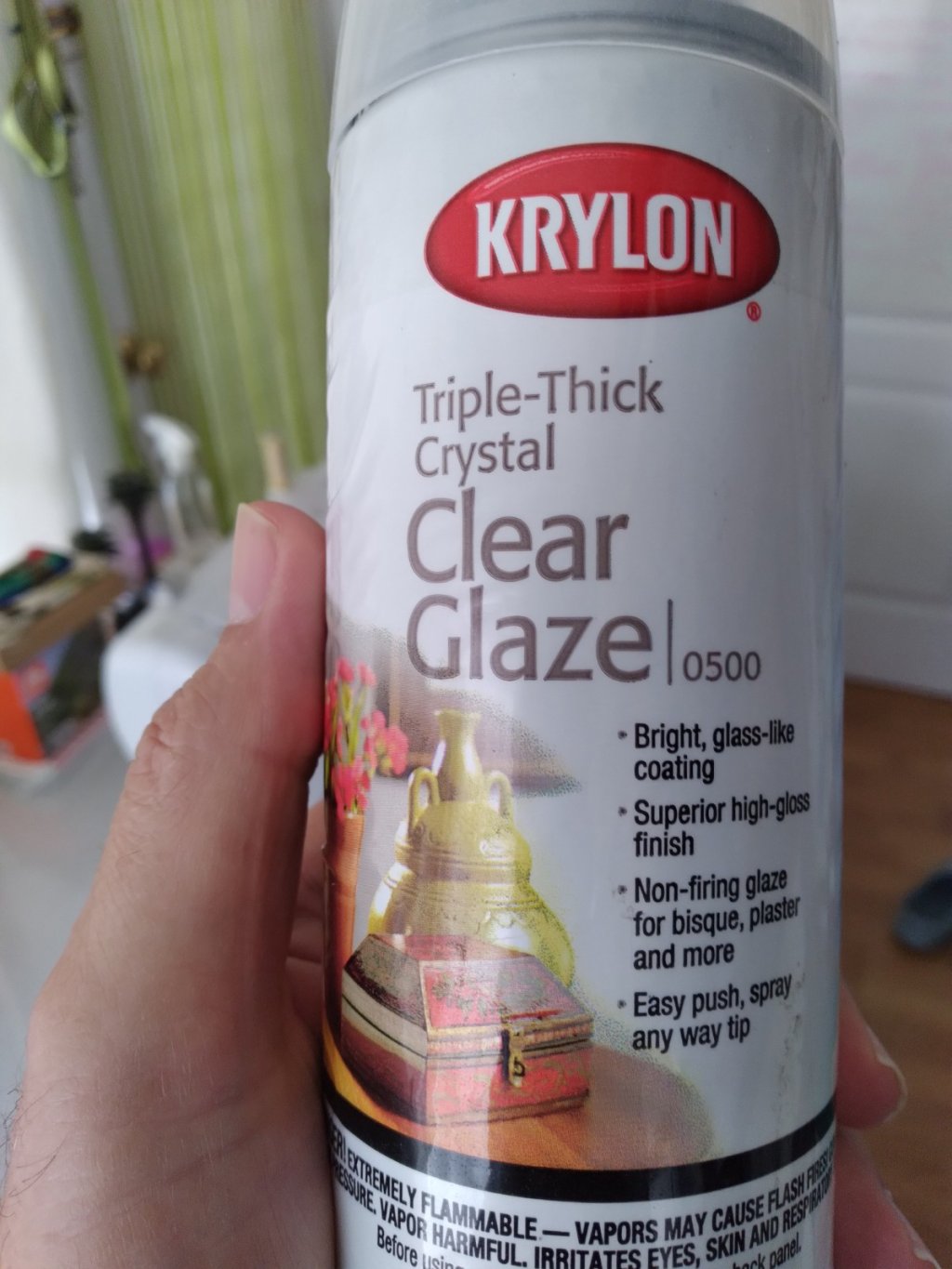

I've had good results using Krylon triple thick glaze.  The only thought I had about the peeling clear coat would be how old is it? Chemicals could break down and change as they age.  That and not shaken well enough. Triple thick is good and where I would use 5 coats of testore I would use 2 triple thick.  Available at wally world.

I have tried that triple thick glaze and have had reasonable success. I found this article about other rattle can options... although I would prefer to stick with the airbrush.
