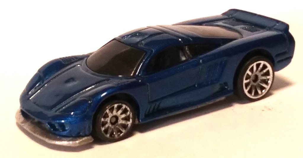

The other Saleen S7 has left the garage on route to the start. I was tempted to leave it factory silver (like in the movie), but went with blue. I put a few extra coats of clear acrylic after seeing how poorly the paint from my last car held up on this track.

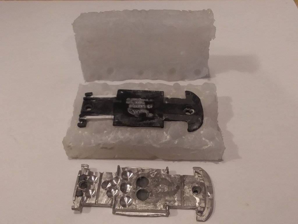

This was my first attempt at casting a chassis in low-temp alloy. It ended up a bit heaver than I intended, and needed some work to get it balanced and under the limit. I still have a ways to go to refine the technic, but the upside is full interior!
- Oh wow, cool! Any tutorials on how to make them metal bases? — Underdogs_Unleashed
- I've been getting all my molding ideas from https://www.youtube.com/@TheCrafsMan. The metal is Roto202 (melts at 202F) which is Bi/Sn. This mold was a "two-part", but I think a "cut-mold" is an easier/better way to go. — TheMakersBox
