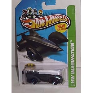

I saw one of these new Batman cars at Walmart today. They have "GASSER" wheels/axles on both ends!
It's like getting two axles for the price of one.
awww-right!
