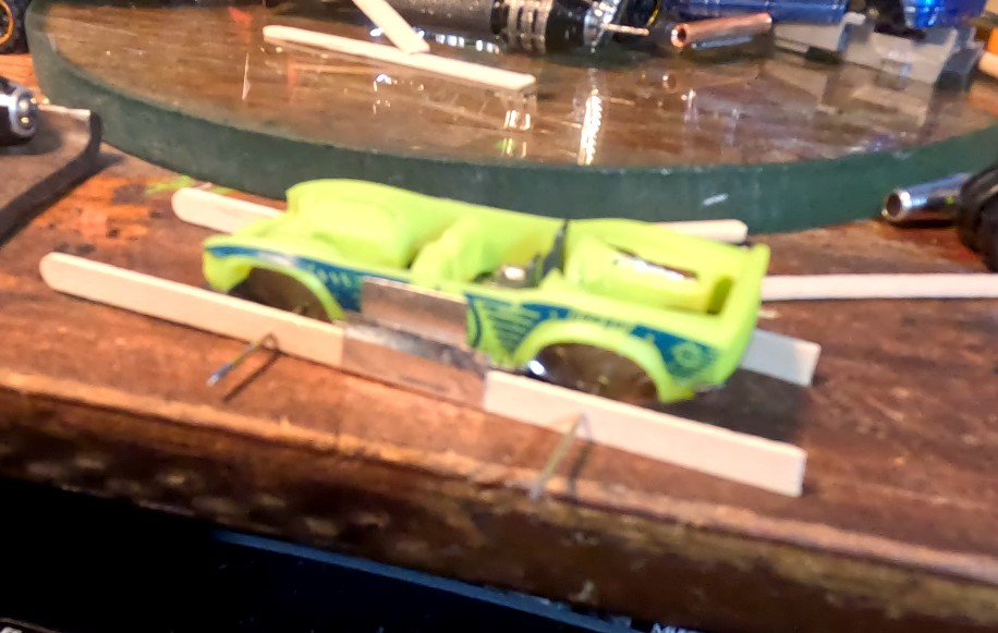

for marc_d
this is the body setup for pouring
vid with added before/after info tool and metal at the end

Now I want to see the results of the run. Good job on getting that melted and filled.
