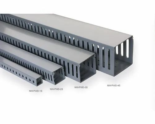

Well my track it's made out of slot tracks, just because I'm on quarantine and I can't get choroplast right now. I've thoug of using electrical trunking like referred above but it lacks the turns. Aluminium trunking could also do the trick but I think it will damage much more the cars than plastic. The orange track it's cool but doesn't allow contact between the cars, and if not correctly mounted one track will always be shorter or longer than the other imo.
Still think that choroplast it's the best solution for those that can't buy or get Sizzlers fat tracks etc in Their own countries like myself.

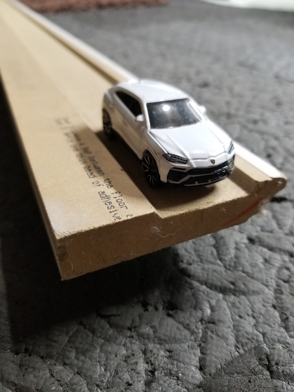

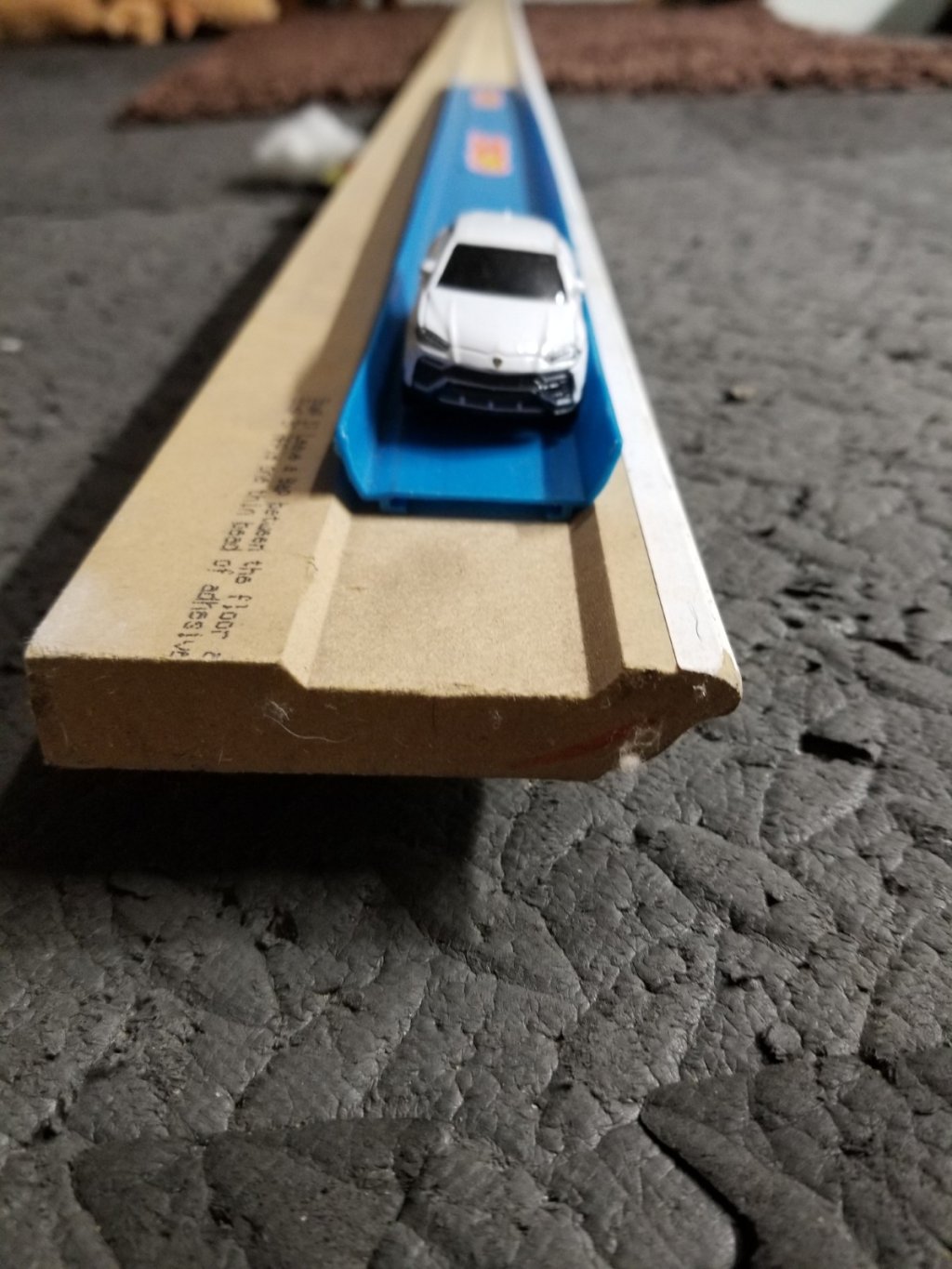

Dj2112yyz 9/7/21
I was going through the garage   Looking for Alternative track material. And I came across this baseboard The backside has a perfect cut out for a hot wheel track or just the Hot Wheels itself. Now if I can figure out what I'm gonna build and where I'm gonna build it.youtu.be/F2hdzZa4c8Q
  • Good catch! Take 2 of those baseboards and put them side-by-side and you a nice 2-lane with a nice boulevard. — redlinederby
  • Since you're already in the garage, start there. — SpyDude
Dj2112yyz 12/6/21
Well I used  48' of the baseboard I had found  in  my garage. It's just hot glued to the wall for all my straight runs .The baseboard is also  wide enough to park some extra cars along the sides on the flats.

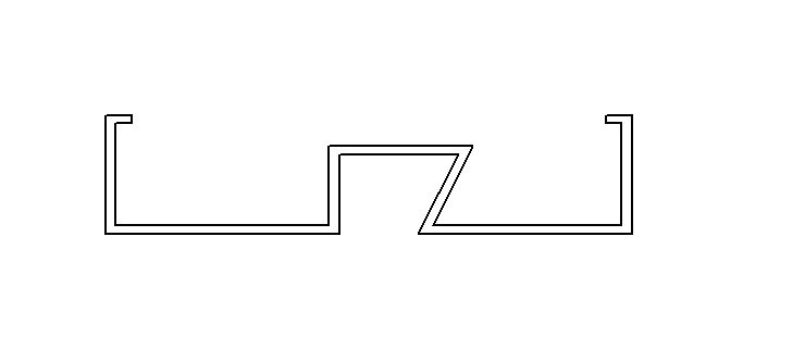

20 years ago I built this.
dragged out of the weeds this weekend as good track building mojo
tilt launch
(does anyone use a tilt launch now?)
extruded aluminum.  the bad part that made it a poor race track
the shape was like this
so one lane would drag the top of the car
we  would still load it with 8-10 cars and launch
lower flat track was basicly a steel 2 x 4 with no holes in it
we called it houston traffic, because the chaos at the open section was great to watch,
and reminded you of the insanity of the freeway
  • Pretty awesome memories there! I believe at one point, Chaos Canyon started with the tilt gate (they actually used a railroad bridge), but decided to go with a static starting gate. Apparently when the bridge banged down into starting position, it would jostle the cars out of position and hang up. — SpyDude
  • Now, looking at your old track, if you got a second piece of that railing and bolted it alonside the first so that the outer lanes were the racetrack and the inner lanes were the Z'd parts, that might be serviceable again. Point the Z's at each other, run bolts through the sidewall all the way down the length of the track, and only use the two outer lanes. — SpyDude

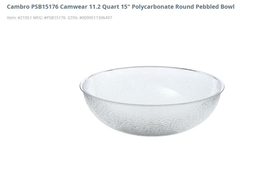

has anyone tried to make curves out of a bowl?
like this:
15" diameter, super slick, and the acrylic could be painted, and glued,
maybe you could backlite from under
cut in half for a 180°
  • There's a couple of YouTube videos where guys used big salad bowls to create curves for their drift tracks. Seemed to work okay after a lot of fiddling. — SpyDude
  • Where can i find those vids mate? — fhk_diecastracingmalaysia

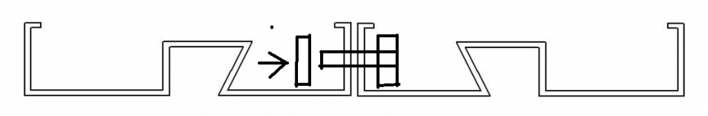

SpyDude 10/17/22
You could rebuild the track so it looked like this:
....... and then your two outside lanes would be the actual racing surface, with the inner lanes being bolted together
  • the vertical wall was too square, too. I think the cars need an edge for the wheel to hit first, before the body — dr_dodge
