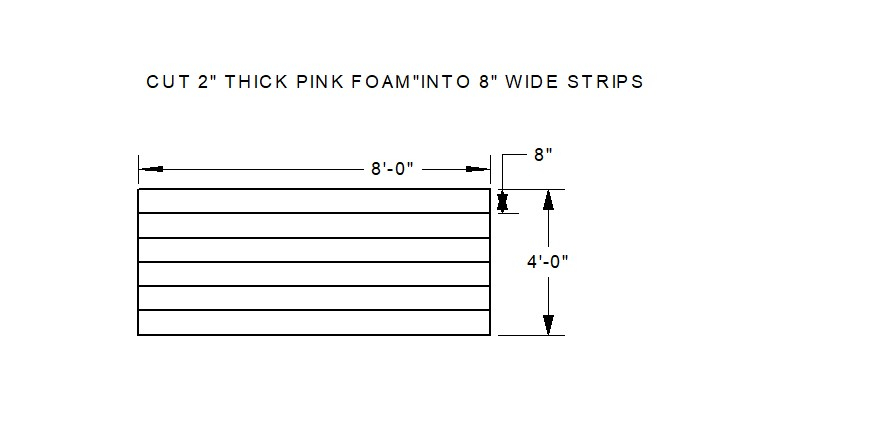

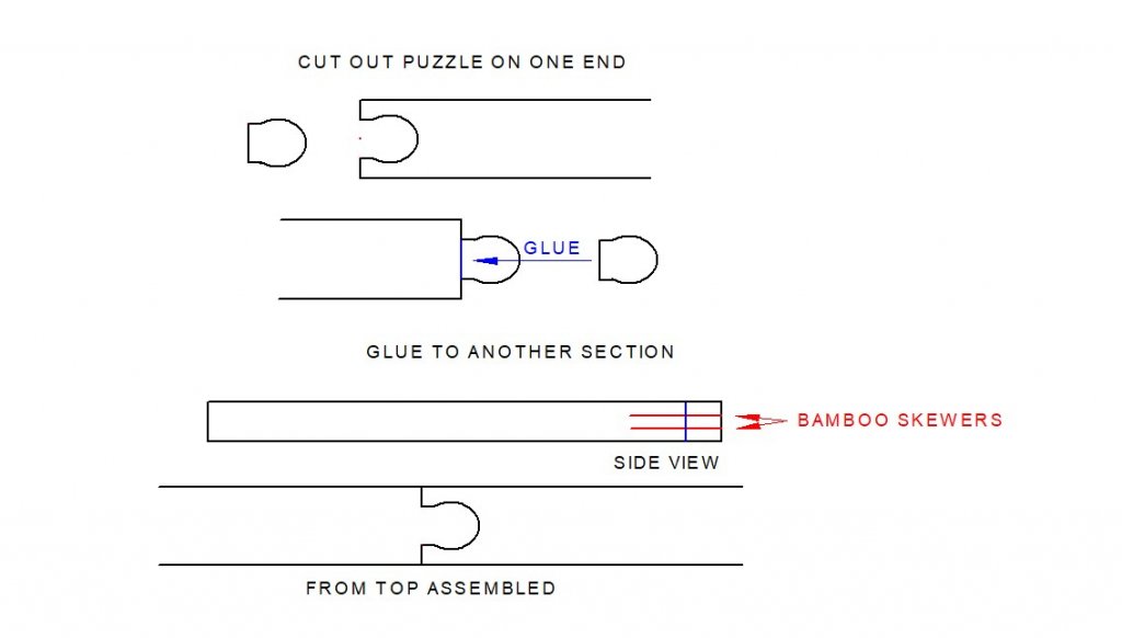

dr_dodge 7/20/24
I think a short track can be interestion, and a flat sloped one would look just like looking down a real track,  nice for film angles, and some realism.
While I was on vacation, I took track to do some outdoor stuff, planed a simple mt, drag, and joust
the mt track worked OK, but drag would not at all. (failure but learned alot)
Long story short, was real hard/impossible to make 2 lanes run the same in the grass. one was always faster.
So, I am going to build some portable sections to support the track
the design would also work for inside, disassemble-able track
It's a constant slope drag strip, like my micro track
I made some meme'- structions
For home use I'll use some 8' long ones,
and make 4' ones that will fit in my trunk
My scroll saw or jigsaw cuts the foam nice, I'd bet a fine jigsaw may do OK, too
Unsure on holding the track, but probably will mount washers or connecters on the foam to keep the track centered,
