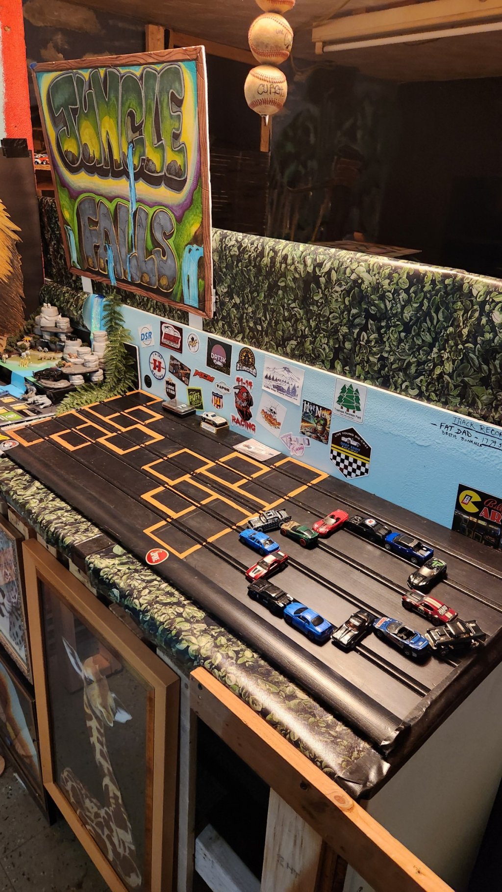

Hello, I'm not a car builder. I am however a track builder. I run Jungle Falls Raceway.
My question to all is... How can I help you guys(builders) make the best car for my track?? Would a video of track be enough? Would you need to see some example cars going down track? Since I'm not a car builder I don't know what goes into the process for you. I just want to see best races possible. Jungle Falls Raceway is a long track. A total of 112 feet to be exact. Lot of turns with some really nice straights for good action.

As far as track schematics.. No clue. Other than distance and starting height. This was all trial and error until it was close to no errors. I will try to take some measurements and put together a video.
Before I post next event I will have sample races, with actual model cars in video. Weights of cars etc...

It might be helpful to tell us what cars and weights you tested with while building. It also appears that 60 gram max weight class is the most often used in open track racing. If you use that as a basis for testing, most folks will be ready. Also, you could just request folks send in a few of their already built racers for testing and maybe share shipping or make other arrangements as to holding cars for testing then have a race to run only the test cars, for fun and braging rights...
You have an interesting and challenging track, lots of folks here support you and appreciate the effort and are willing to help if asked!
Maybe you could reach out to some builders on here, perhaps some who were in the Beetle Bonanza, and ask for a few test cars at various weights and see how they do. I bet 60 - 70 gram cars that ride at a standard to low height ( Mustangs, Govn'rs, Chevy and Tbird stockers..etc) would handle the track well and probably be very quick.
Despite not being a builder, I think if you purchased a few heavier cars like from the Hot Wheels Nascar Pro series that are usually 40 - 50 grams, you could get good results from them.

Thanks for everyone's feedback. Looks like I got some work to do. Think I will pick out cars I currently have from some resident teams currently at Jungle Falls already. Weigh them, race them on video and hopefully give some builders an idea of what Jungle Falls Raceway is all about.
A Lil clue to what's upcoming.

Hello all. New racer and hopefully track host here. Not sure if this has been posted somewhere else and I didn't see it. I'm definitly no mathematician, though I believe dividing the track length by the total drop from start to finish would give you the average of how many feet of track are in each ft of drop (L / D = ft of length per ft of drop). Dividing the total height of drop in the track by the total length would give you the average ft drop in track per ft of length (D / L = drop in ft. per ft. of length).
Example: Track is 40 ft with a total of 5 ft in drop. using method two - 5(D) / 40(L) = 0.125 of a ft drop per ft of length in track.
Using this one could approximately replicate the track drop average at home to test cars. Even if the length and amount of turns differ from the actual track being raced. Of course vehicle weight/race max weight would have to be taken into all this. Thought of this because I have lighter unmodded cars going faster on certain testing. I believe it has to do with the afformentioned equations and length of start needed for heavier vehicles to pick up speed possibly. A steep drop start in the track could also affect all this, more so before the first turn. So if an event host list the track length and total drop it would help with at home track testing for racers. Total drop in first 5ft in track would also be useful for tracks with fast starting lines.
Beautiful track, I gotta give you an attaboy for this one.
It would be interesting to know the track angle at the start section

Perhaps certain measurements like Track width and Hill grades would help use gauge what cars would be best suited for your track. By the way great way to kick off your track with the Vw beetle tournament
