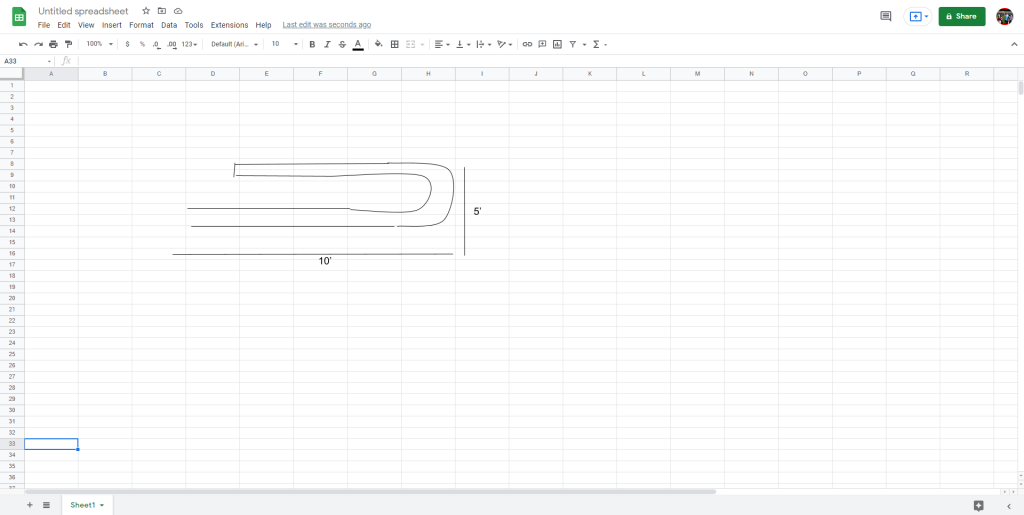

use excel spread sheets

the above is obviously not drawn to any sort of scale but you get the idea
