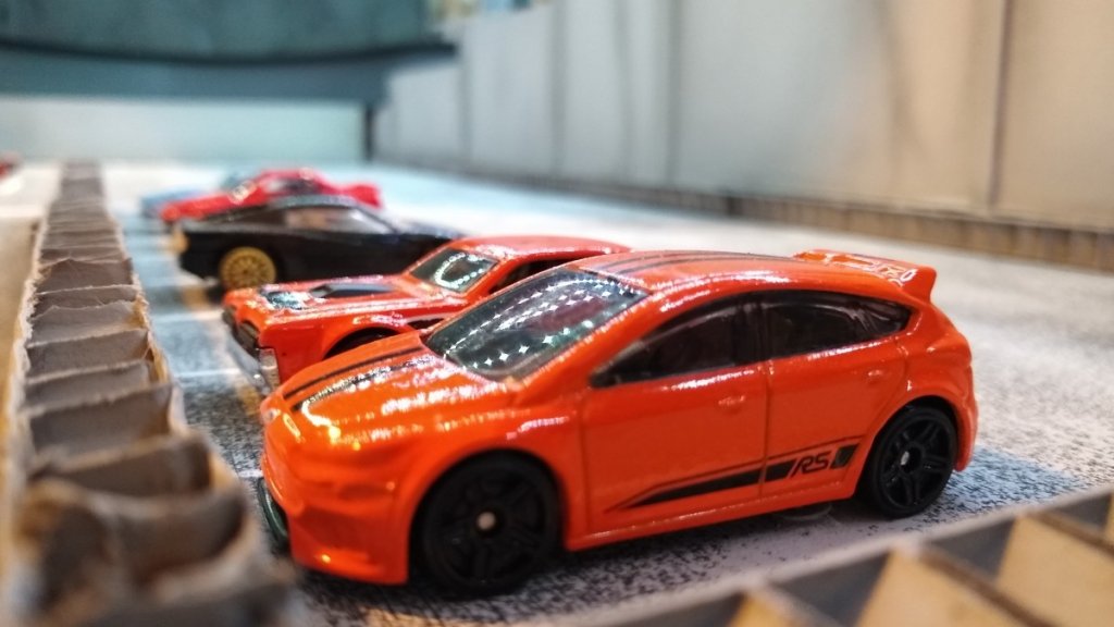

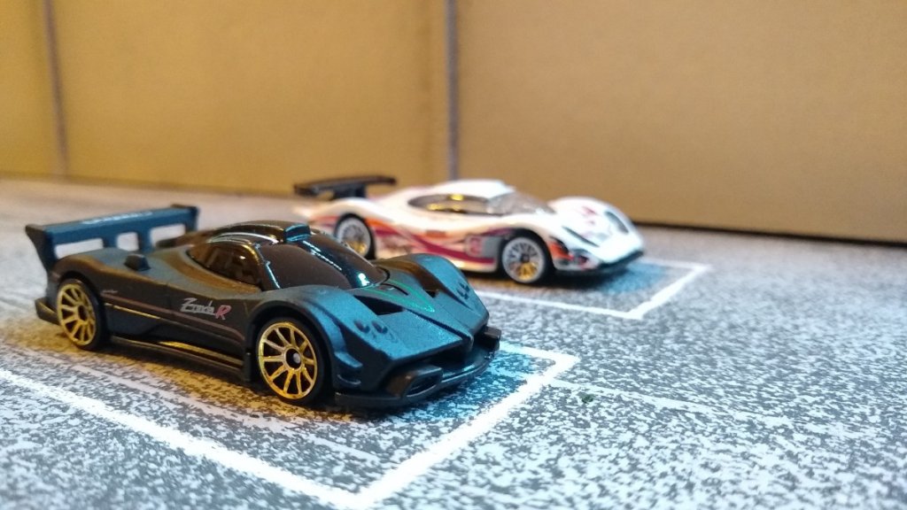

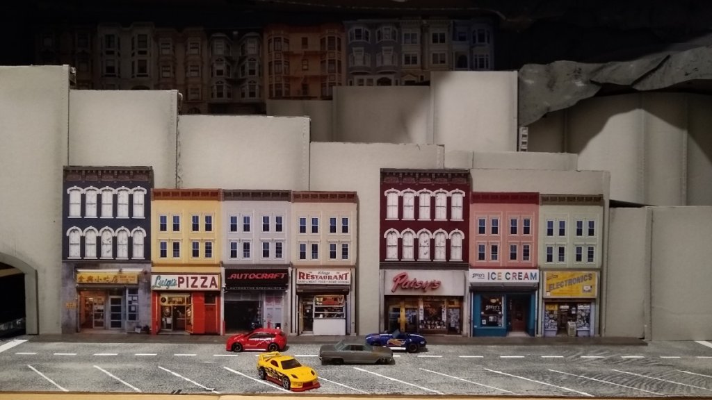

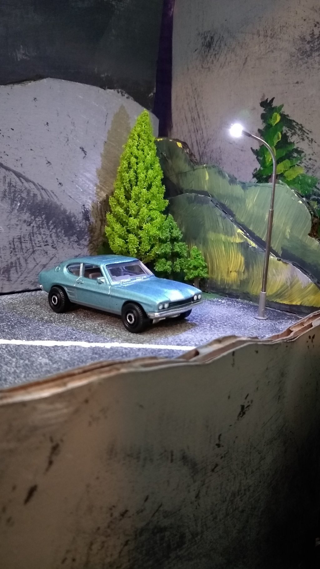

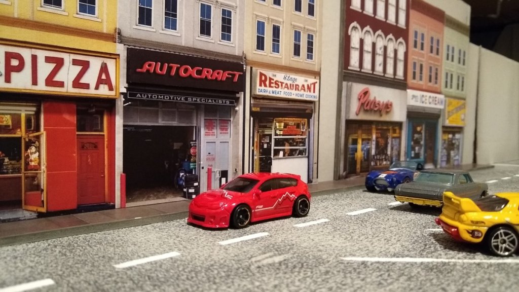

Here are just a few more detail shots of the track with cars. This is part of the reason why the look went more detailed and realistic, it was just too fun to stop. I'm also hoping to get some video footage up on YouTube at some point. I may even capture a 4 car tournament to see how it turns out. I'm also working on a new name for the track now that I've changed the theme.

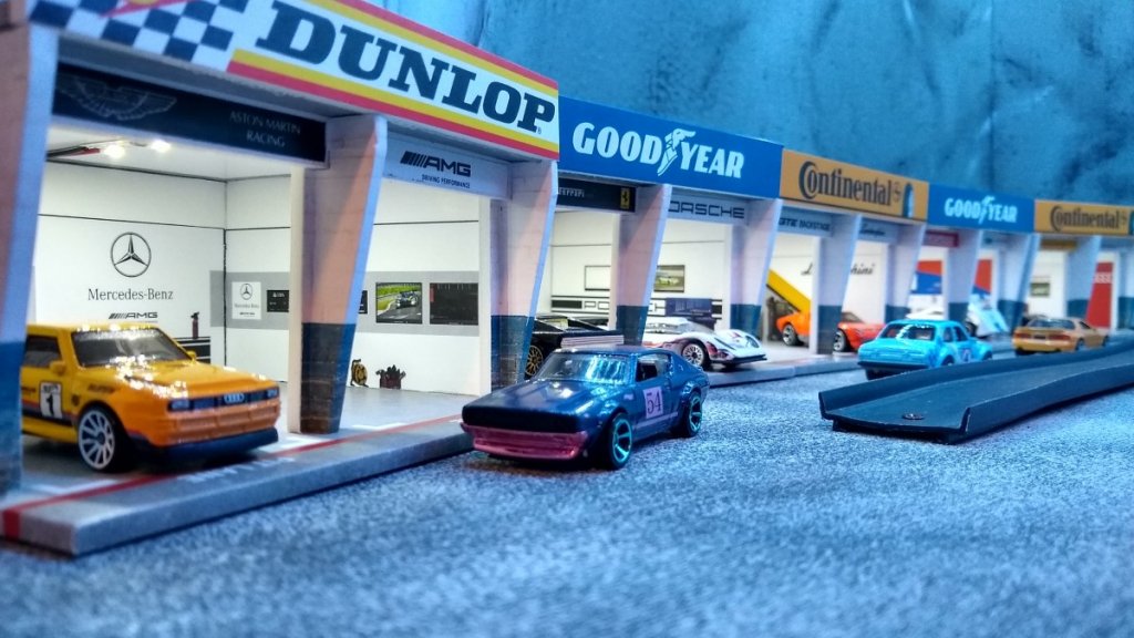

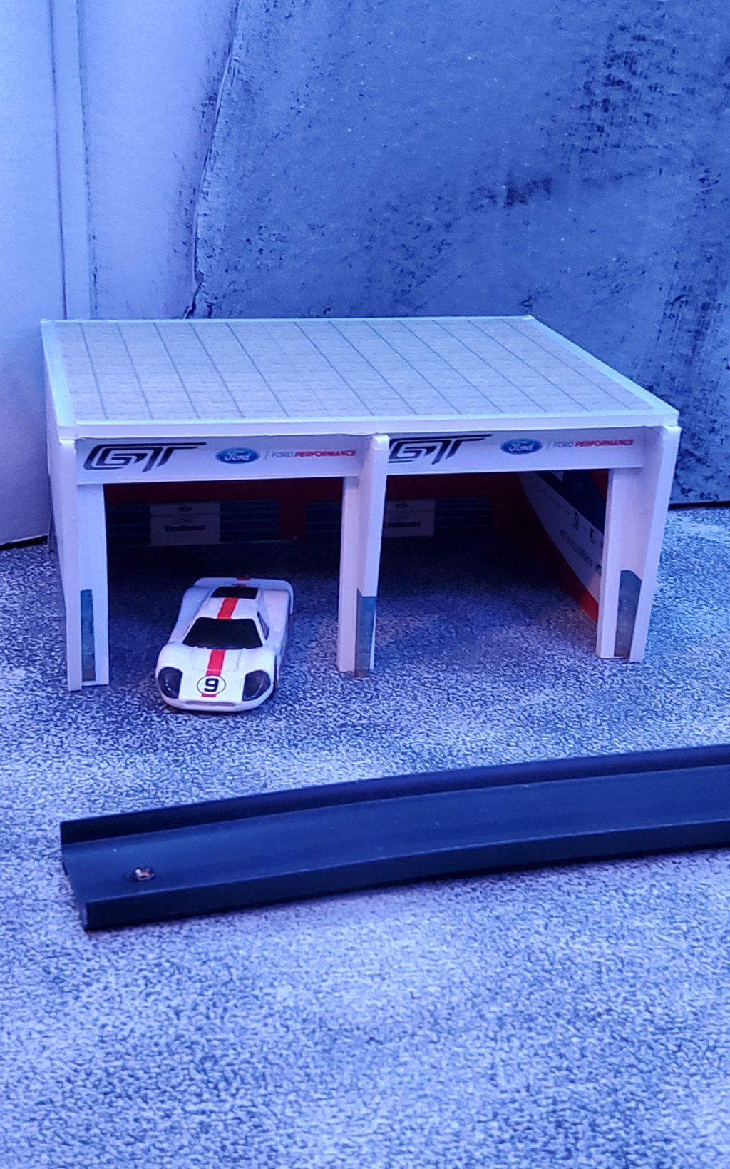

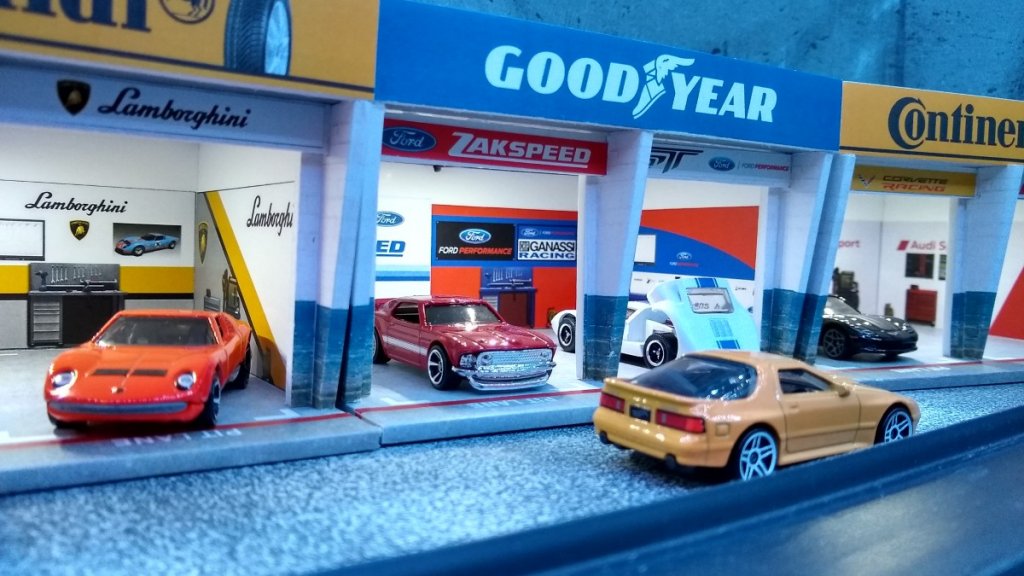

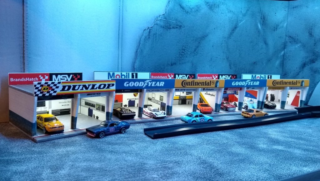

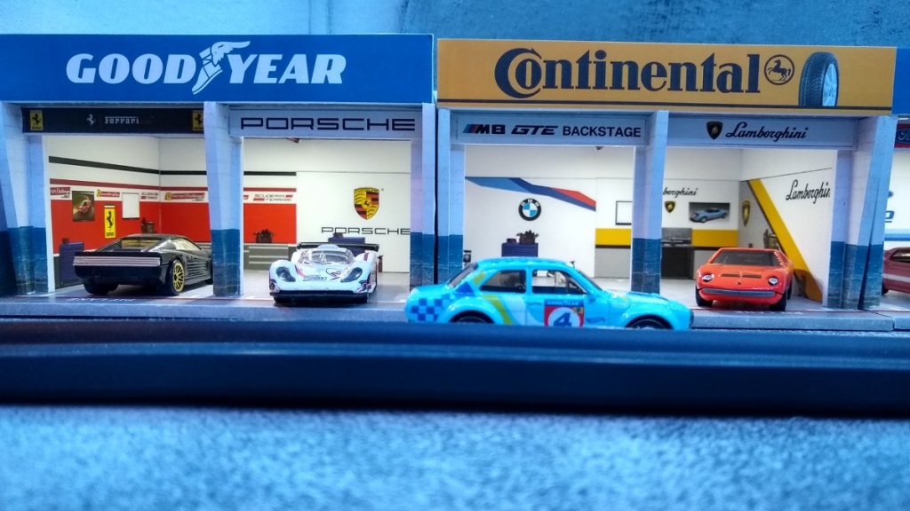

Finally got the garages finished and installed. I scaled it down a little from my prototype. I used 1/8" foam core board. First I printed out the garage interior and exterior patterns on self adhesive label paper, then transferred the wall, floor, and roof patterns to the board then cut them out and glue up the walls. Next is gluing in the front supports and installing the lights. Last is gluing in the roof and floor. I used primarily hot glue, but tested some with super glue. I think hot glue holds the best but dries pretty quick, so trickier to work with. These just wire into the existing PSU board for the other lights on the track.

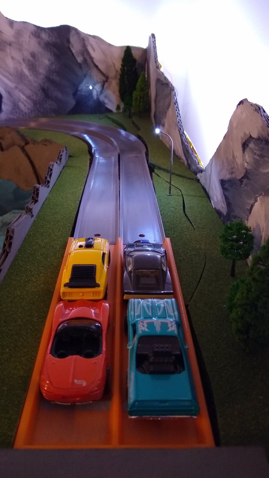

I've finally worked out an arduino based timing system and start gate and have it installed. Everything works fairly well, I would call this track substantially complete. From here I'll continue adding to the scenery and I'm toying with the idea of swapping 3D printed parts in the first turn. But as is, the track is finally ready to formally race. I'll be re-branding this thing hopefully soon and try to get some real video footage together, stay tuned.
Here's a test video of the timing system and start gate.

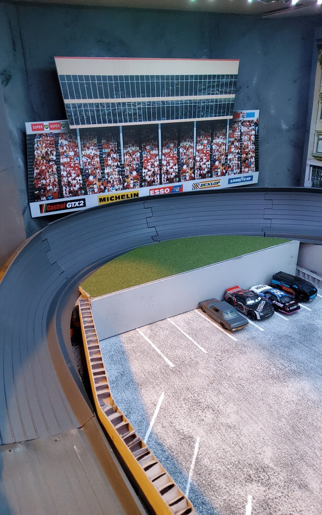

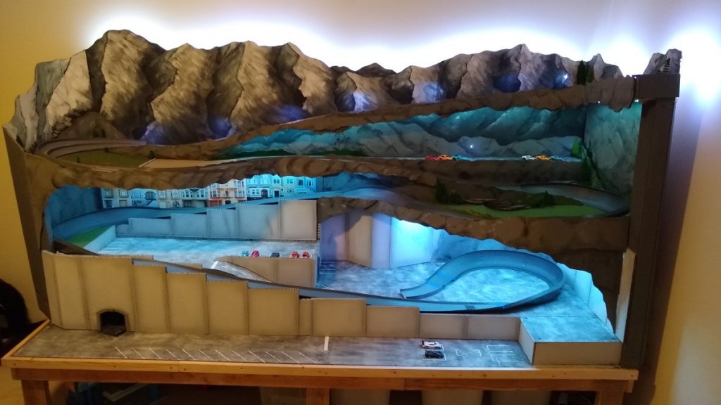

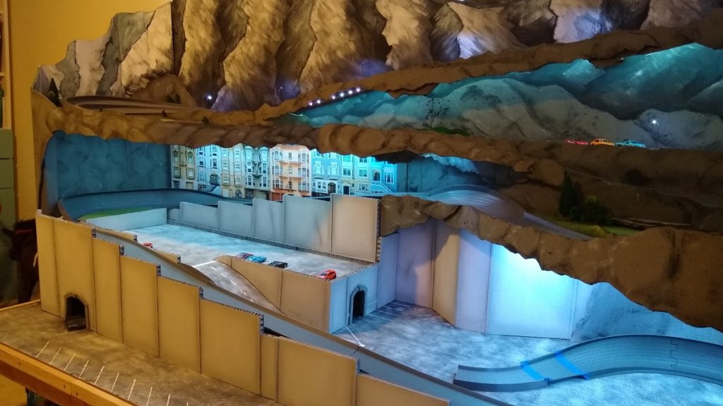

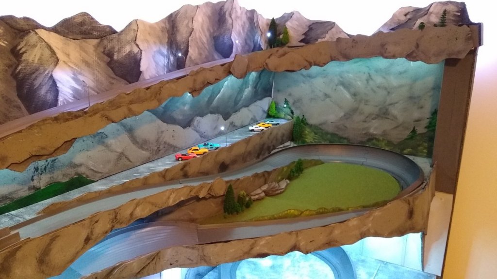

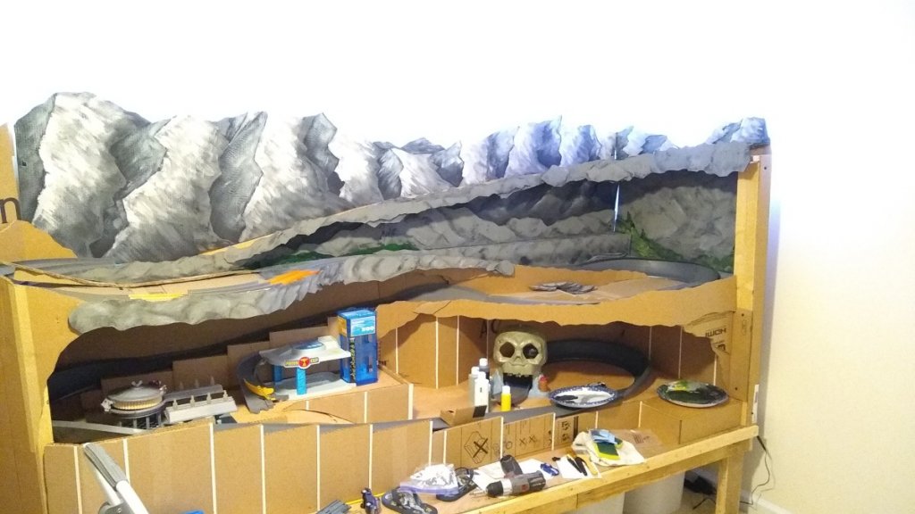

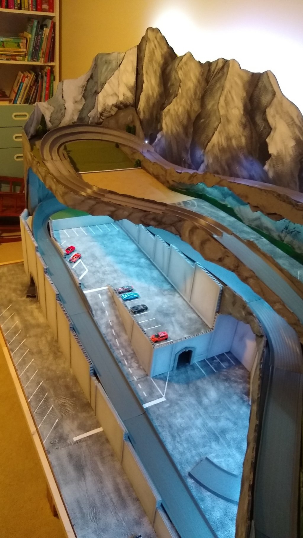

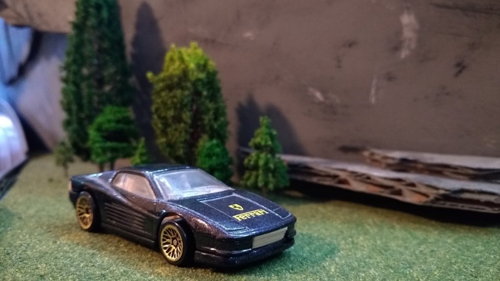

So my theme and scenery has taken on a more realistic approach, partly in the interest of time, but also I was surprised at how well cardboard has worked out. It made it difficult to not add more realistic features and the kids don't have any complaints. Eventually though I may figure out a way to incorporate some of my original ideas. All the scenery is painted cardboard and Lauan plywood except the grassy areas, which is model railroad paper glued to cardboard. Painting took longer than expected (I see why 3D uses his approach), but I felt I had no choice because kids will be crawling and banging on this thing and so far it's held up well.
This is a shot in process.
Here is the final product. I like that it's basically a blank slate with room to add whatever we can think up as we go. Also I've replaced the finish line and turn with a better one which I'll post pics later for.
The LEDs are a 32ft RGB strip light set from Amazon. I'm fairly happy with them though they could be a tad brighter. The street lights are model railroad LEDs.

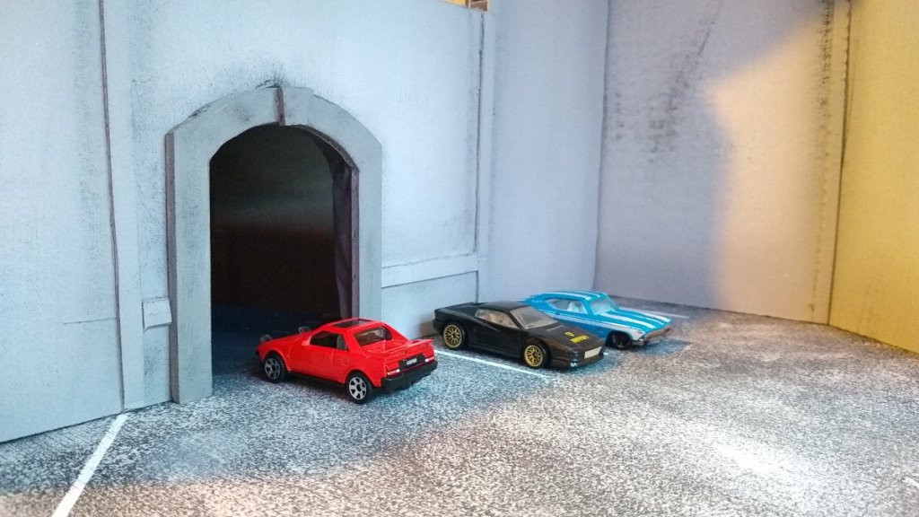

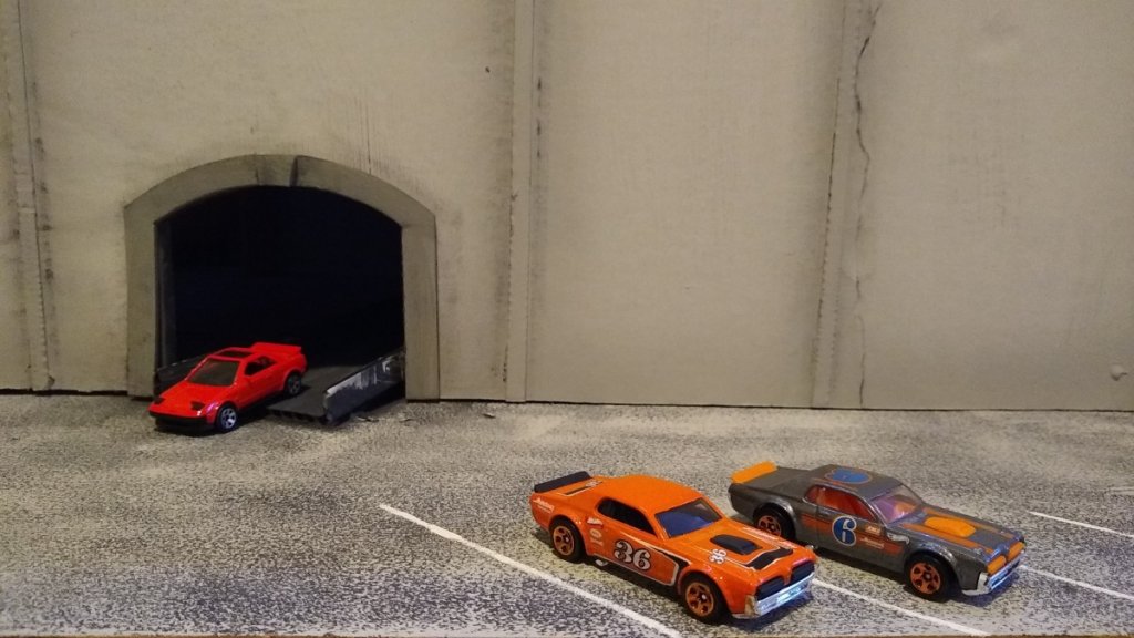

I'll be turning this into a little city so the kiddos can still play when we aren't racing. Here is a little tunnel to push cars through to the lower level.

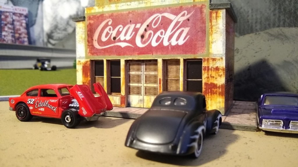

I've been adapting some papercraft models I found online as well as making my own to add detailed components. The papercraft is printed onto self adhesive label sheets then transferred to 1/8" foamcore board, then cutout and hot glued together. Pretty happy with how some of these have turned out.
This Pit Garage is my current work in progress.

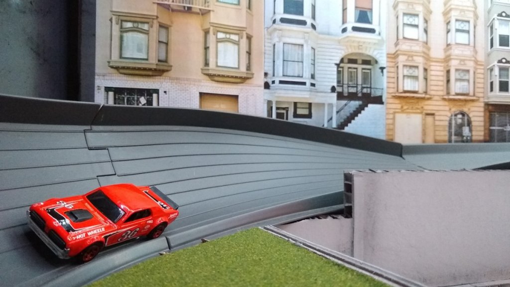

I'm also making some 2D elements which help fill out the scenery and can be built pretty quickly. These I made myself with found images.

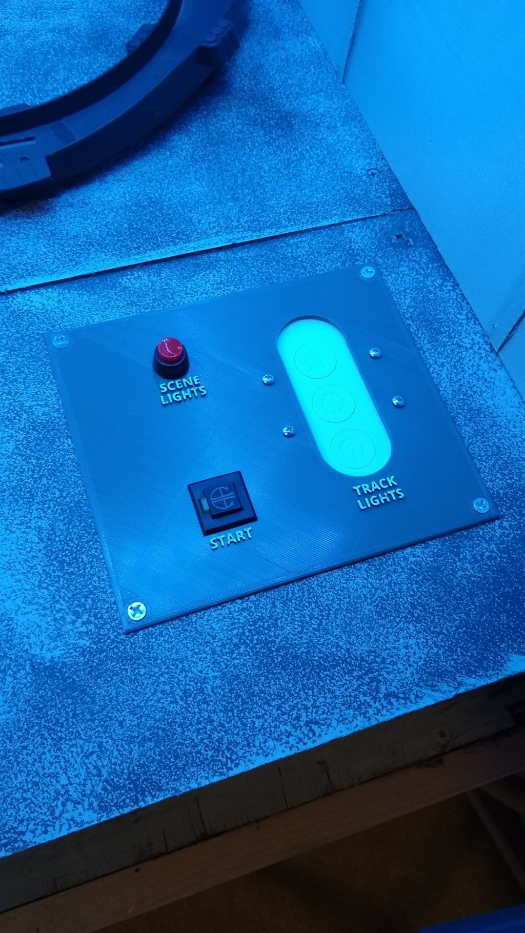

This is the control panel I 3D printed for lighting and eventually a start gate. You can see part of the new finishline.
