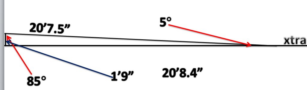

I'll be starting work on the 1/4 mile track at Homestead Farms and I was wondering IF there were set standards for the amount of fall and the amount of track used in a fall?
I am considering an equal, continuous drop for the entire track. So the cars will continue to accelerate until they hit their max speed or the finish gate. I wanted to make the grade steep enough to cause a realistic time for a quarter mile. I was thinking an 8 – 9 second time for winners was pretty fast. This means the grade may be a 1/12 pitch or a 4.8 degree drop.

Basically 20' 7" continuous drop...I'd start it at 40" and let gravity take over from there....PM me if you need anything or want to bounce ideas off me.

actually LOS and big poppy the track would be 20'7.5"

big poppy I could do a sketch 4 u if u want
SavageSpeeder 12/16/19
here's ur track
  • Thanks so much. I was going to get the measurements over my Christmas break, this'll save me time in the set up! — Big_Poppy
  • Psssh...math. Is that some of your fancy trig? ;P — redlinederby
  • yes — SavageSpeeder
