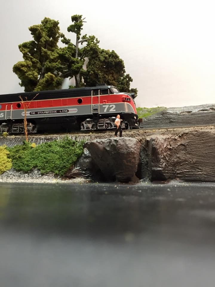

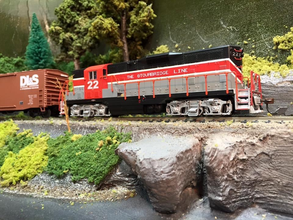

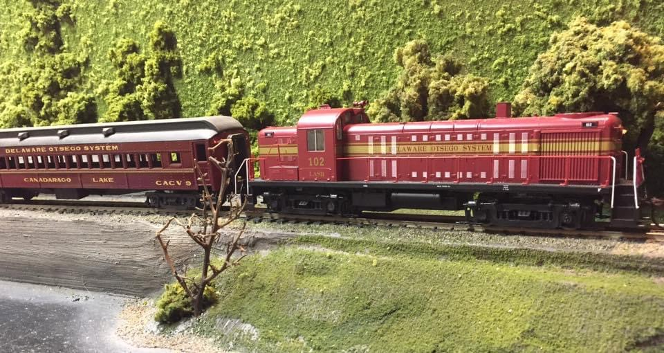

When I was building model railroads, I often used bush branches for the trunks and ground foam for the foliage with contact adhesive (like very strong rubber cement) or Walthers Goo to hold the ground foam to the branches. I've bought many premade trees from Woodland Scenics and other brands too, but they cost and time to paint them to look real made the bush branches even more appealing.
A few samples of the scenery I was doing for an HO scale photo module. It's got a combination of store bought and home made trees. It's based on a real railroad in Pennsylvania that adopted the name I came up with for my model railroad that was based on that railroad's previous names and location.
