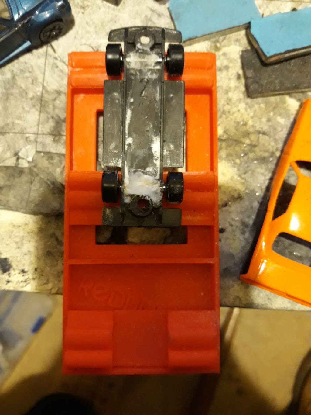

- Try on something small you can even put on a little drop on a piece of wood make it two and then on one drop spray alcohol on top of one and blow the alcohol off, the next drop sprinkle some baking soda on top of it let stand for at least a minute and blow off the excess baking soda let's stand for about the same time as the quick weld. — Chrisw
apologize for late post. This is a little example of baking soda and super glue gel together on plastic Which is one of the best binders for plastic and a little bit of metal. Strong bond.
I've used superglue and baking soda for years on plastic models. It's a good gap filler, but I do find that the baking soda can make just the outside of the glue set fast, and you have to wait for the inside to dry. I just apply the glue and sprinkle with the baking soda. Multiple thinner layers are better for faster drying.
