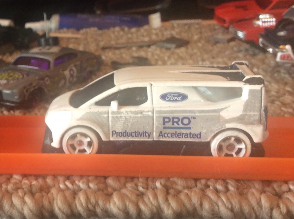

Once all my work is done I make a race car sandwich with JB Weld and cross my fingers. If I miss perfection it’s no big deal because I have many cars being built at once. Sometimes they turn out awesome, straight and fast.
Solid 54g, rolls straight and fast. I really like this one, she was an easy build and even the white wheels don’t look stupid.
