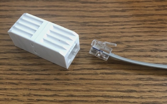

I have a dragtracks racing system that I want to mod to make it longer for more feet of track. I noticed the finish line cable is like those of a telephone cable but it has 6 colored contact points instead of the traditional 4. Where can I get a 6 contact point cable that's at least longer than 30 feet? If anyone has done this modification on your dragtracks I would greatly appreciate if you could shed some light on how you did it as I'm not familiar with this type of electronic work.

For our extended length DragTracks we hit up Amazon for a RJ12 6-pin phone line and in-line coupler.  Cheap, easy, it works, and you can buy the cable in all kinds of lengths. You can even buy the cord, ends and crimping tool separately and make your own. (Tried to find these locally but no store had the 6-pins)
  • Thank you for the insight! I'll be sure to look for those materials so I can get to racing — Ralph_Technology97
