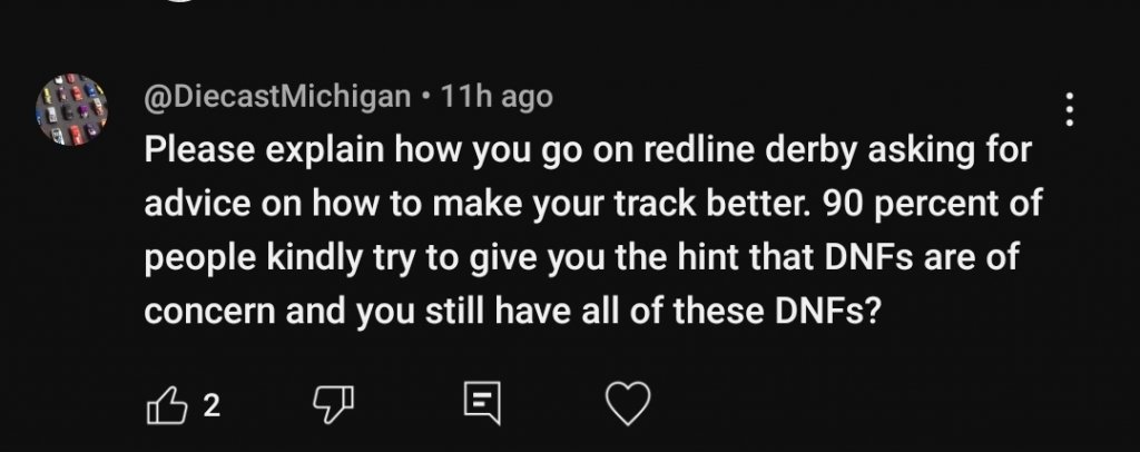

Hello all. My name is Jason. I built and operate Jungle Falls Raceway.  I have hosted multiple mail in tournaments.  I've learned a lot since my first official race. I've upgraded my track with help from slanman customs and my own elbow grease. While I know it's not "perfect", I am also aware it's really an awesome track.
I know my efforts and track are appreciated by most, there seems to be a few people who think i can better. If you are one of these people that dislike the Falls, this is your opportunity to tell me why!. Im a grown man, im asking the ones  that think there are problems with the track to speak up. Please feel free to speak your piece. I will respond to everyone.  Im not here to start a fight with anyone. I want to discuss what you believe to be the problem.  Any valid complaints can be addressed like adults, and hopefully it will make for more enjoyable racing for all. I know some will post there opinion but not respond on how to fix problem.  Lets talk about it. For example i posted picture of comment from someone unhappy with a video they saw. What they didnt include is a solution.  The floor is yours. Lets talk.

You're doing great over there, thank you. Not finishing happens in racing, it's called racers luck. 4 out of 4 DNF's is probably the car.

Personally, I'm not really seeing a problem with your track, and certainly not what this guy is saying. As BadWool pointed out, yeah, you had that problem with CatZilla destroying part of the track--accidents happen--but you fixed it. Moreover, THAT section of track was a bad one, so it needed to be reworked, anyway.
The Jungle, being an open course, is not really too forgiving on taller builds, so I've learned low and lean work best. You can't really flatten out the corners much more than they are, or cars will start flying off the track more frequently. At the same time, you can't jack them up higher, because then the cars  will start rolling off the inside of the track. Six of one, half-dozen of the other .....
Now admittedly, rail slides are a problem. Cars come out of the corners, hop up on the rails, and slide to a stop. What's going on there? Don't worry, you're not the only host that has that problem. Maybe, where you're noticing the rail slides a lot, either a barrier fence or jack up that edge of the track a little more? (Not being a track buiilder, I can't really say what to do, but offering a suggestion as requested..)
Start a collection of different weighted cars. Go from the lightest to the heaviest, and run each down the track several times. Make a couple of REAL heavyweights (like 70g+: throw a 100g on there, see what happens!) and run those down the track, as well. See how everything does, and take notes on where the cars are having problems: rail slides, tumbling off corners, overshooting turns, whatever. Then you have an idea of where the problems are starting to lie, and for what weights are making it and which ones are not. You're not going to get it perfect--if you get it above 50% of your cars make it to the bottom, great! That at least tells you that you're on the right track (pun intended,) The better you can dial it in and get those percentages higher means less DNF's and more racing action. Tweaking and testing, rinse and repeat ... that's about the only way to dial it in.

Some people seem to really enjoy belittling tracks without a valid reason. As many above have said, the rebuild address most of the "valid" previous complaints.
That being said, I would be interested in seeing the 3rd to last curve being checked out. Since it's blind from the camera angle, it's extremely difficult to tell what happens when racers dnf or slows down through it.

You know me, Jason, I'm thrilled with your work through every iteration of the main track and the few secondary courses you've built. We learn, we grow, we adapt
So weird to be called out for asking for advice on a site dedicated to racing and gather thoughts from racers and fellow hosts. What, were you going to write a letter to the Los Angeles Times? The instances where I offer constructive criticism, it's in the vein of "I see you're doing X, have you considered doing Y to achieve goal Z?" Provide some concrete guidance instead of a mere complaint, and something actionable within a host's current capabilities
I feel some out there on the other side of the screen still don't know AFCR track is a product that was never intended for gravity racing with plastic wheeled cars, so if anyone is getting the results I see at the Falls, cars finding the finish on a track of this size, that sure deserves respect.
DNFs are part of the game regardless of track build, the best anyone can do is tack down any consistent problem areas whether it be a section that often has joint separation or a turn that visibly flexes a LOT when multiple cars careen through them simultaneously

To be honest, I take it as a badge of honor just to make it to the finish. My first attempt didn't, I changed how I built, my second attempt made it. Us builders need challenging tracks. How else are we to learn and become better? I take it as they wanted you to make it easier so they don't have to put out the effort...
