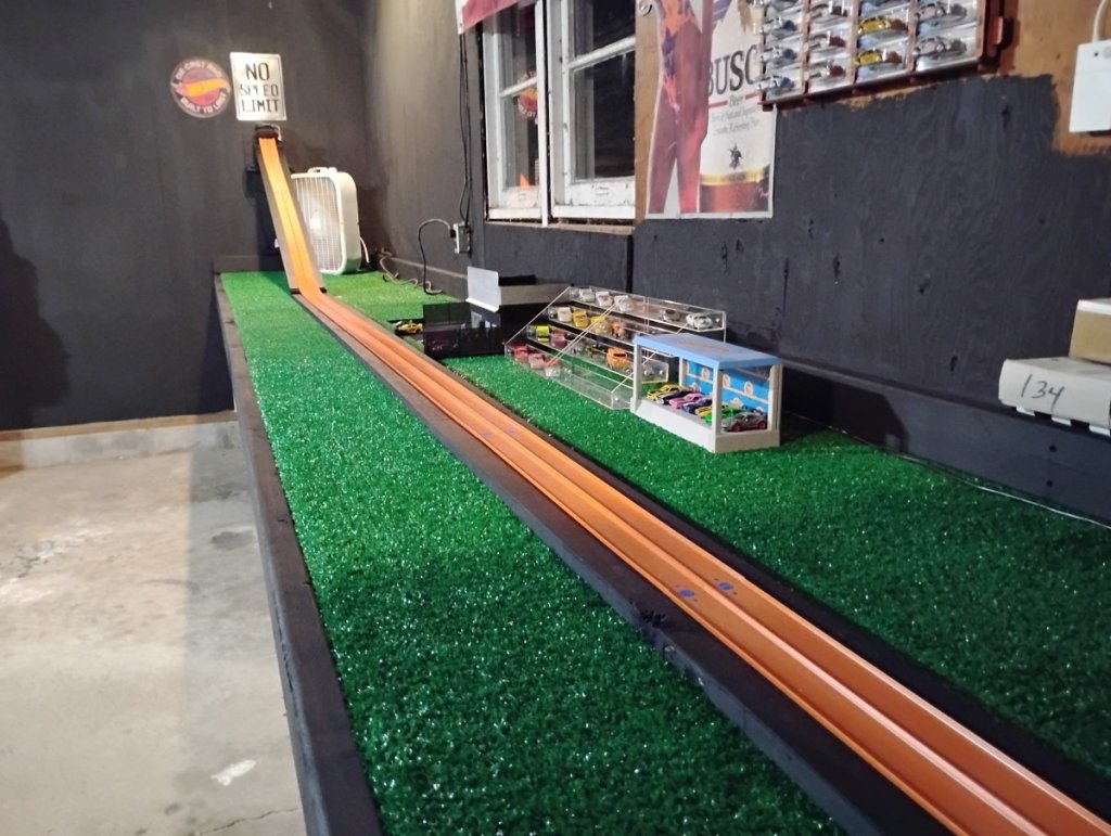

Hey everyone, it's Drift!
So now that my track is set up and I'm ready to film I'm just wondering about any tips or suggestions about camera angles, editing and stuff. I have watched an extensive amount of diecast racing on YouTube but it's mostly downhill track courses. Being that my track is a '18 drag strip I have to believe it'll be different than how they film the downhill courses. I've seen some other people's videos and it looks like they just follow the track with their camera for the most part. I am going to be using an iPhone 13 Max for the most part but have considered getting a go pro to set up more near the end of the track to capture finish gate in slow mo gor really close races. Any and all suggestions and tips are appreciated ????
