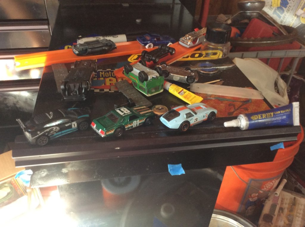

The Jaguar I-pace has a good reputation. This one was very smooth out of the package, my second one had a bent axel. I haven’t seen anymore since. 81 Fairmont is a $3 Ultra Hot metal body/metal base. My plan was to do everything to her but so far I’ve only tapped the wheels with the $4 Boy Scout lead from Hobby Lobby. She rolls real nice. The number 3 Cobra out of the package with a little lead and wheel tapping is a good car. I see a lot of these at Dollar Store, Walmart and Target. Big potential. Good luck, you have an awesome looking track.

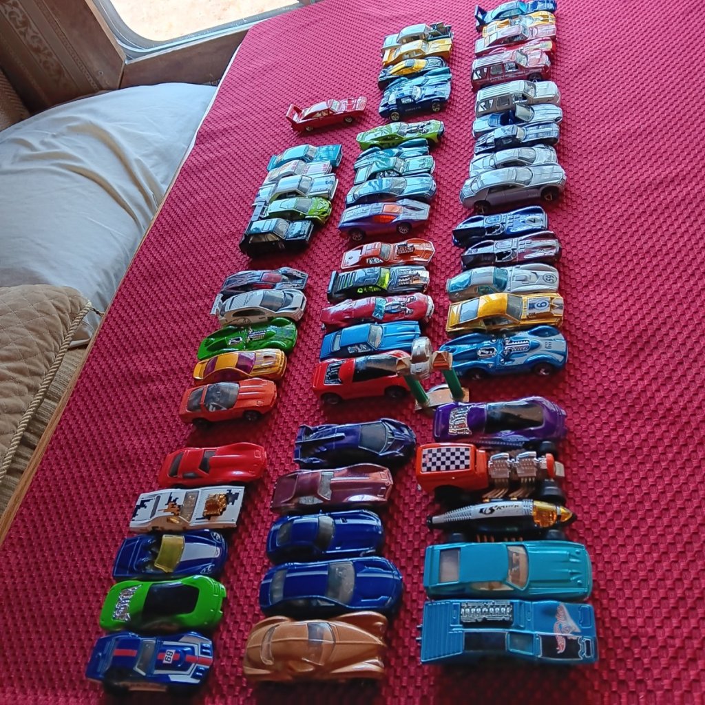

Here's my latest Quick 56 out of 300 cars. 10'6" orange track. 1.5 foot drop. The fastest is Sidekick at the front right. A dozen of these cars have been modified but I mostly lube and sand wheels. There is a half car length difference between 1st and 56th.
- Formula Firebird is my favorite. Great pic, thank you. — alva1370
- Some of these cars are on the pegs right now. Mach 1 Mustang, 67 Shelby GT 500, Shelby Daytona coupe, Jaguar XKE, Benz AMG, Rivited, Nitro Doorslammer, 69 COPO vette, Stingray vette, Rodger Dodger, 99 Mustang, Jaguar I Pace, Nissan Skyline 3000GTX. My storage space is limited to about 300 cars. I keep adding faster cars and getting rid of the slow stuff. For potential speed I look for medium 12.5 mm wheels size, wheel clearance in the car body, wheels extending beyond the body sides, FRONT and rear ground clearance, longer wheels base. If I dont like the car but it passes the fast car checklist, I will buy some just for parts. Check out" The golden one" thread... racer buys 10 of the same car, one is very fast, one is very slow and the rest are grouped together creating the base line performance for that casting. Happy hunting. — Vulfgang

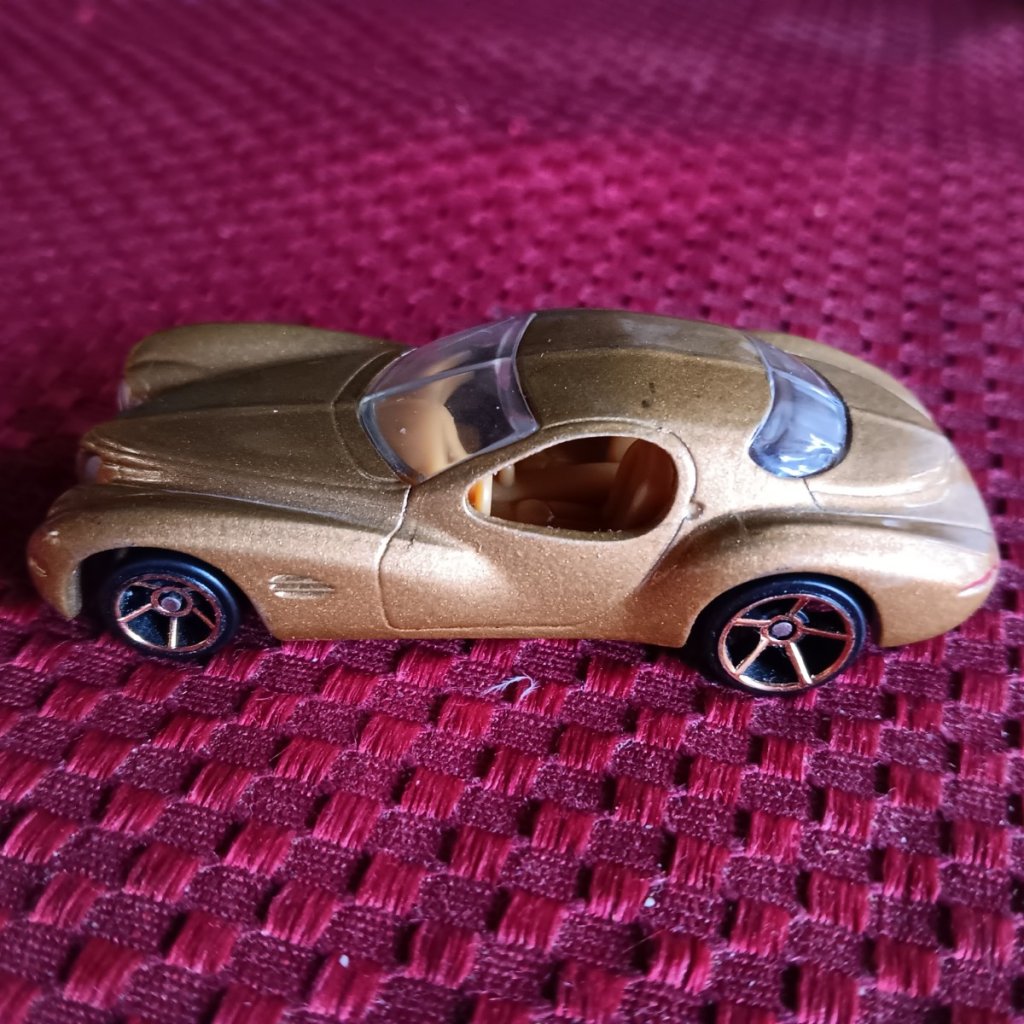

- The copper Tucker on the bottom is Tight! What's the make? — LordSyosset
- Its a Chysler Atlantic by Matchbox. Released in 1998. In 1985 Chysler revealed this kick butt concept car. Body by Gaffoglio Metalcrafters of California. I put some FTE axles on it, currently ranked 21st in my quick 56. — Vulfgang
- That came out nice! — Object52
- Its one of my favorites. It was super slow when I opened it. Lubed the wheels and it wasnt fast enough. So I spent a hour sanding and swapping FTE wheels, polishing the axles, coating the axles with gun lube, waxing the chassis and body... now one of my fastest cars. The real Chrysler Atlantic was a tribute to the Bugatti Atlantique of the 1930s. Designer guy Bob Hubbach sketched the concept on a bar napkin. They built a straight 8 motor for it by mounting a couple 4 cylinder motors from the Chrysler Neon. — Vulfgang
