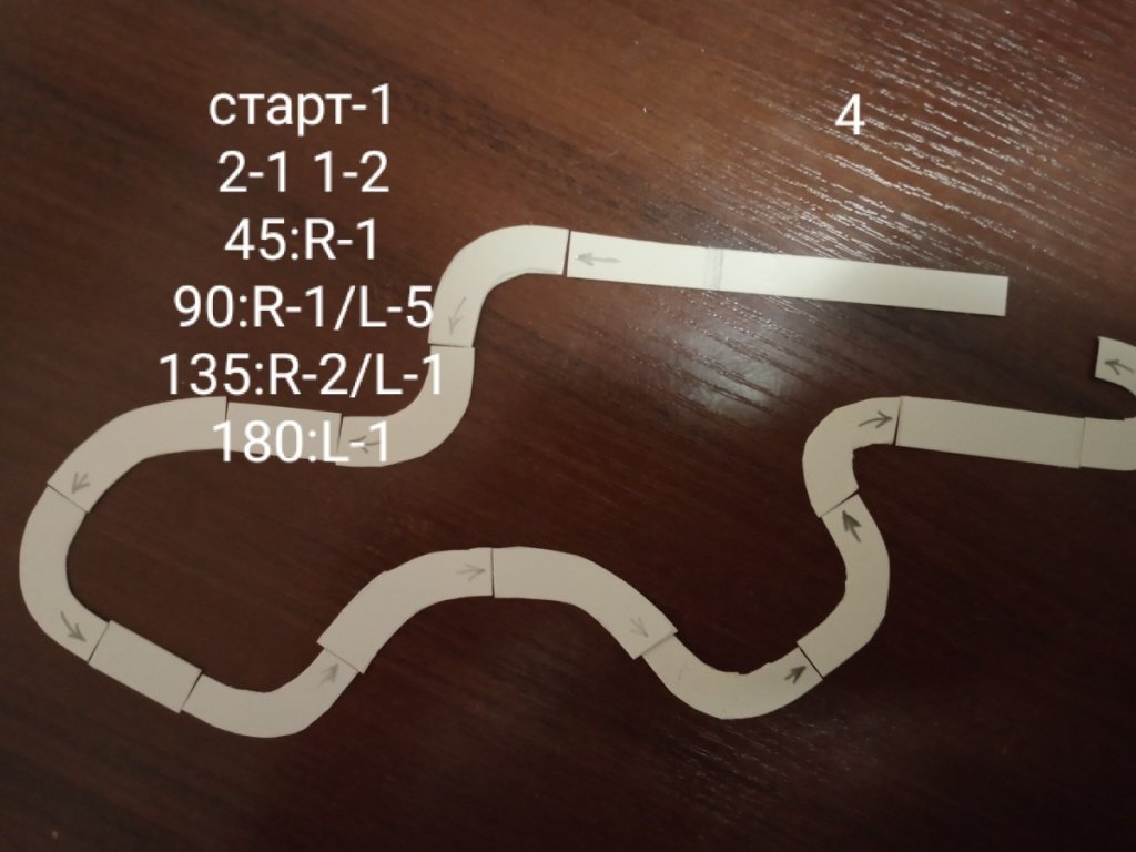

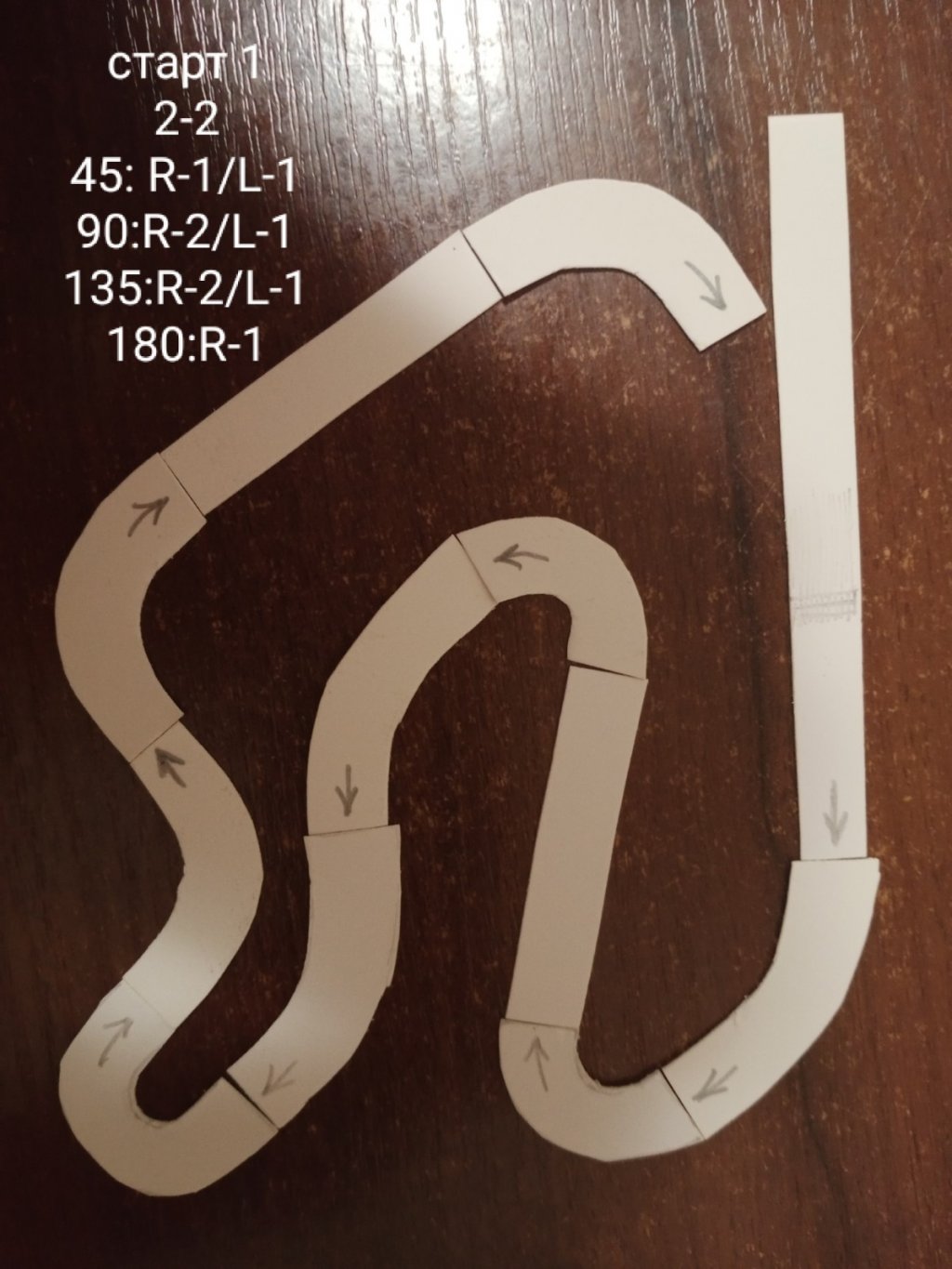

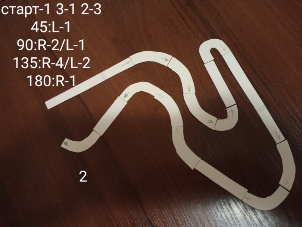

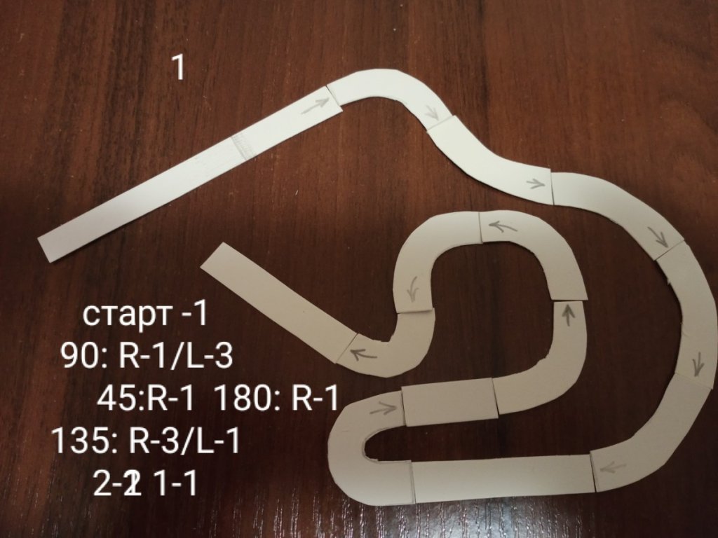

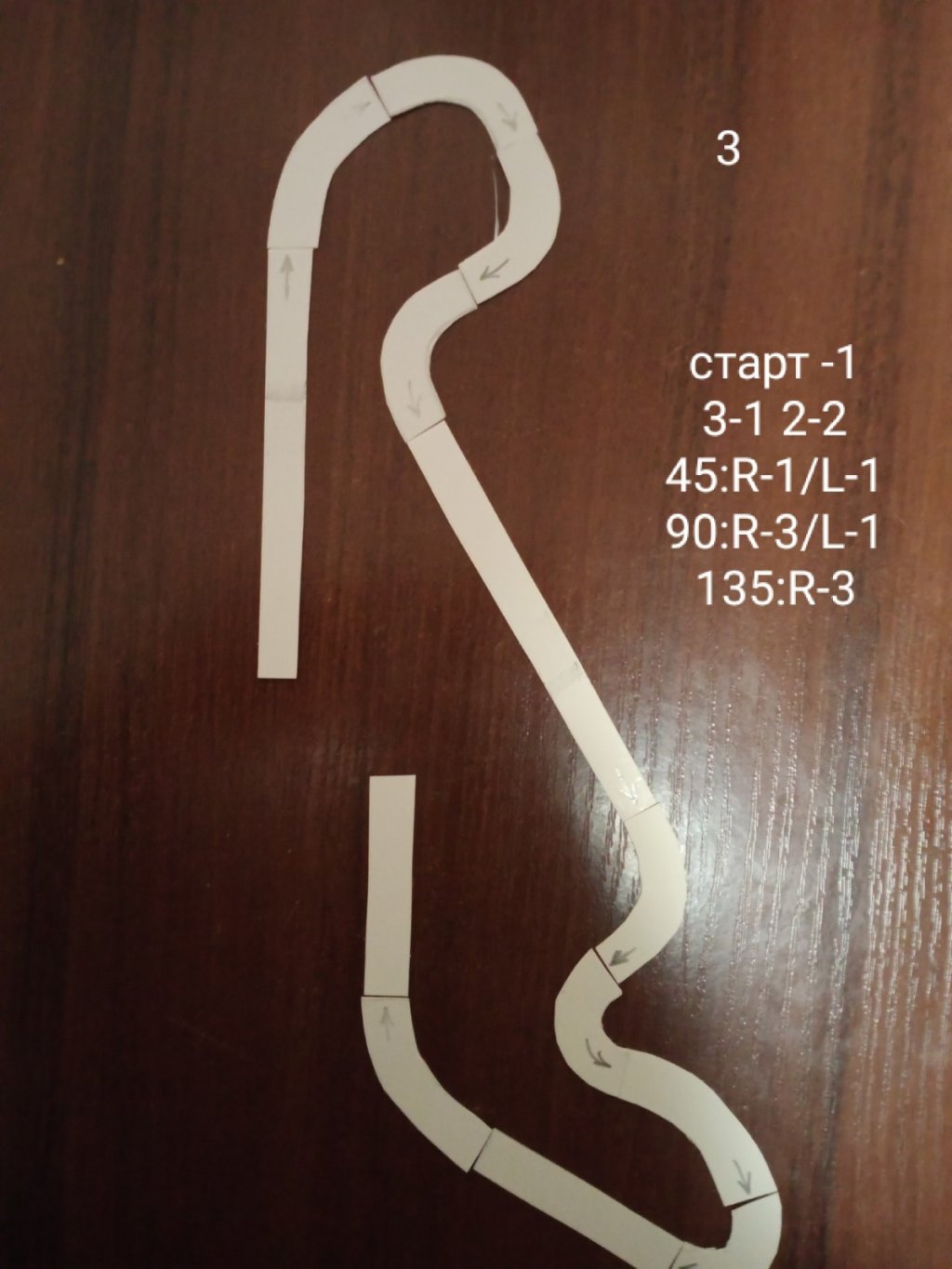

Hello everybody.
I listened to your advice and started building a modular track out of cardboard.
In the first stage, my goal is to test the correct slopes of the starting line for acceleration.
And goal number two is to test combinations of turns. So far, I started with the combination of Right 135 + Right90. The result is one successful per 10 attempts. Cardboard gives its nuances.
youtu.be/d3ibz3XC9II
  • You could also try adding a small slope between the two corners, to allow the cars to carry the speed a bit more, it could also allow you to flatten out the tradition from your start ramp to the first flat section — Chaos_Canyon
