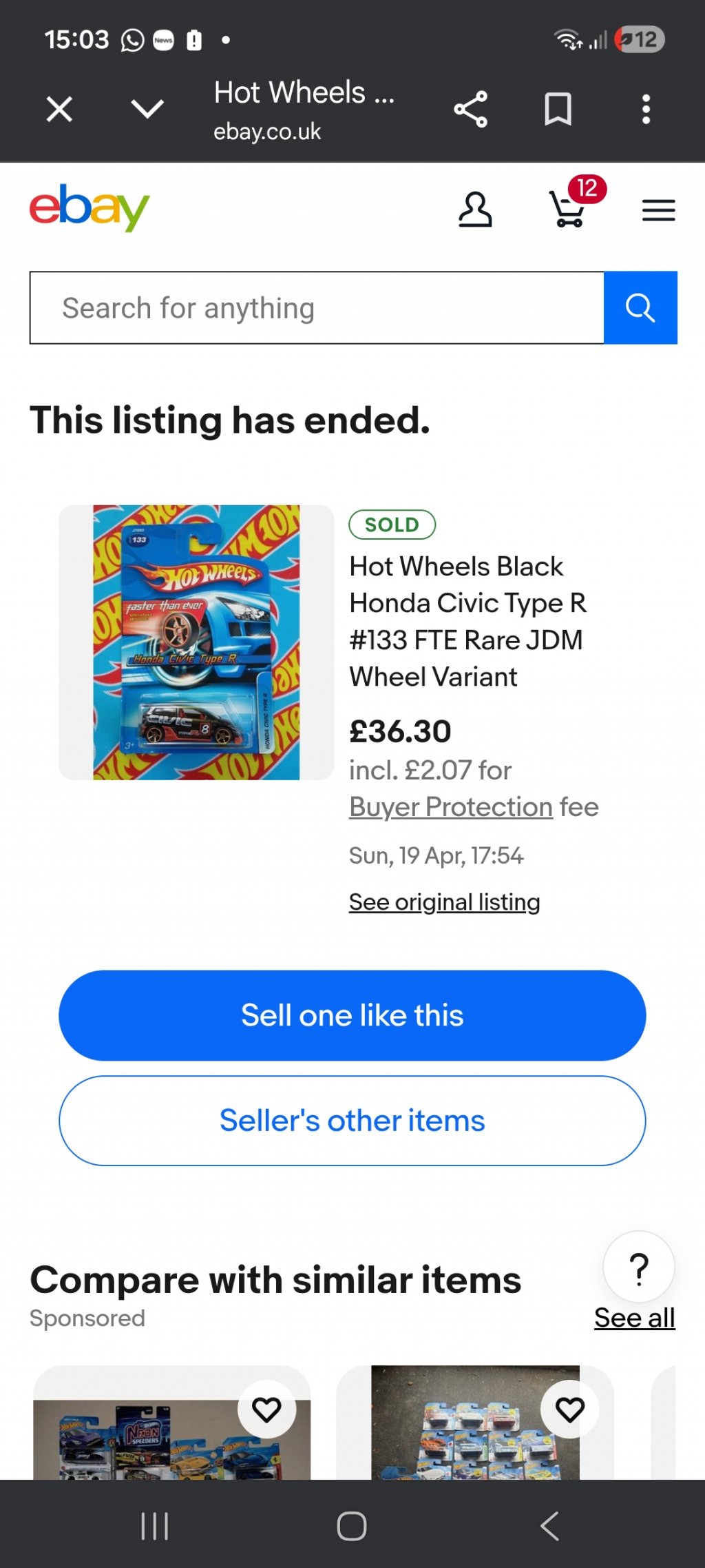

I have got a few fte cars recently,mostly still unopened,and have seen a few cars fte going for silly prices.what are your best fte cars from experience,I know some are hit and miss. Have you modified any cars just by changing the wheels to fte?and did it make them faster even before adding weight etc.what is your slowest fte which really screams what's the point in Mattel putting fte on .looking forwards to replies

found this one on ebay,I have the casting but not fte,and of course not having the fte version I can't compare it if I wheel swap
