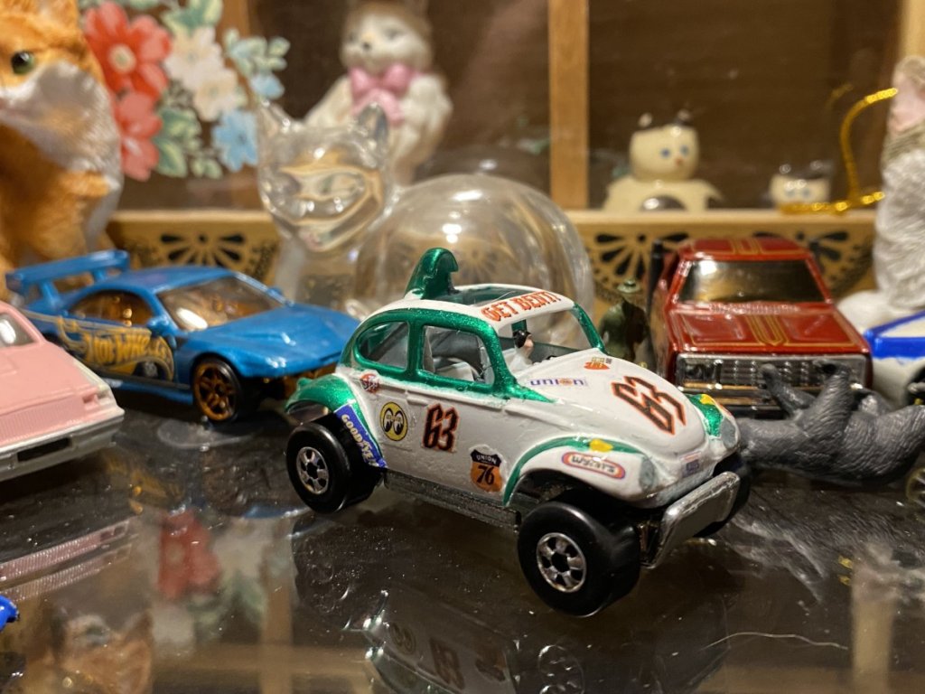

The Wagon was painted White first, Green second and Red third.
