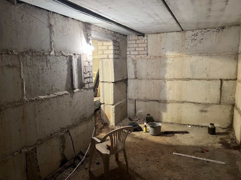

For a few years now I have wanted to develop my own racing track. I just needed a space. I had been away in the US and Austria for a few years and, on my return, rediscovered the unfinished basement under our house.
I guess this was originally meant to be a sauna. But I feel maybe I can use this dark, dank space for racing. I have spent the best part of a month dealing with the mould I found there. Obviously using a basement poses its own challenges:
  • the floor and external walls have gotten damp in the past and threaten to do so more if the climate keeps warming the way it has to date.
  • It is not an appealing space.... yet.
Still, on the plus side, it is big: 4m x 2.5m.
I am of course wary of how to proceed. I originally thought I could use the walls to place supports up high to start things off, but several articles on how much damage someone like me with a hammer drill can do has put me off that option.
So at the moment I am considering a series of large simple workbenches with supporting struts. To cope with a potentially wet ground I was thinking of raising everything up off the floor on locking wheels. Alternatively I may be able to find some kind of pipe and joint system that is waterproof. Or maybe I can find something to hang from the ceiling? This may be best for the initial straights, but I have no idea what exists in this way.
The decor would also need to be plastic. Still, I have to give it a go. I have a some track now from the very helpful Russ at Spoolheads V 2.0 and some old Hot Wheels track. I will try to keep a regular diary, though this could be slow going at first as I work out how to do this.

Good evening Mike,
To start, I'd get a de-humidifier eating. (a big one)
All mold is solved by dry.  You have similar challenges to my shop track.
I have an interesting "free standing support structure concept" that I plan on using.
I'll start a new thread in a day or so on it.  For now, I'd suggest just getting it dry,
and you are correct, don't drill holes in foundation or basement walls,
unless you want real problems.  just dry it out.
heat, air movements, and dehumidifyin' is where I'd start
masonary holds alot of water.  If you can find a brick layer for advice, (free estimates)
see what they have to say, too
and welcome to the greatest community ever!
and thats a great space to take over!

I agree with the good Dr. Get a de-humidifier or 2.
Looks like you have space to put up some 2x4 framing and add some drywall. I can't tell if thats a dirt floor or not but something simple like 2x4 frame with 3/4in plywood on top and your good to go.

  • I have tried to monitor the humidity levels for the last 3 months. They peaked at 70% in the early autumn and currently hover at 40-50%. I am not sure what to make of this, but assume that the cold winter air is dry. I had a basic dehumidifier on the case pretty early, It knocked 6-7 percentage points off the humidity levels of the day. — Mike_W
  • I am not sure how to explain the floor. It looks like a mix of concrete and the stuff they lay on roads these days before the final tarmac ‘asphalt’ layer — Mike_W

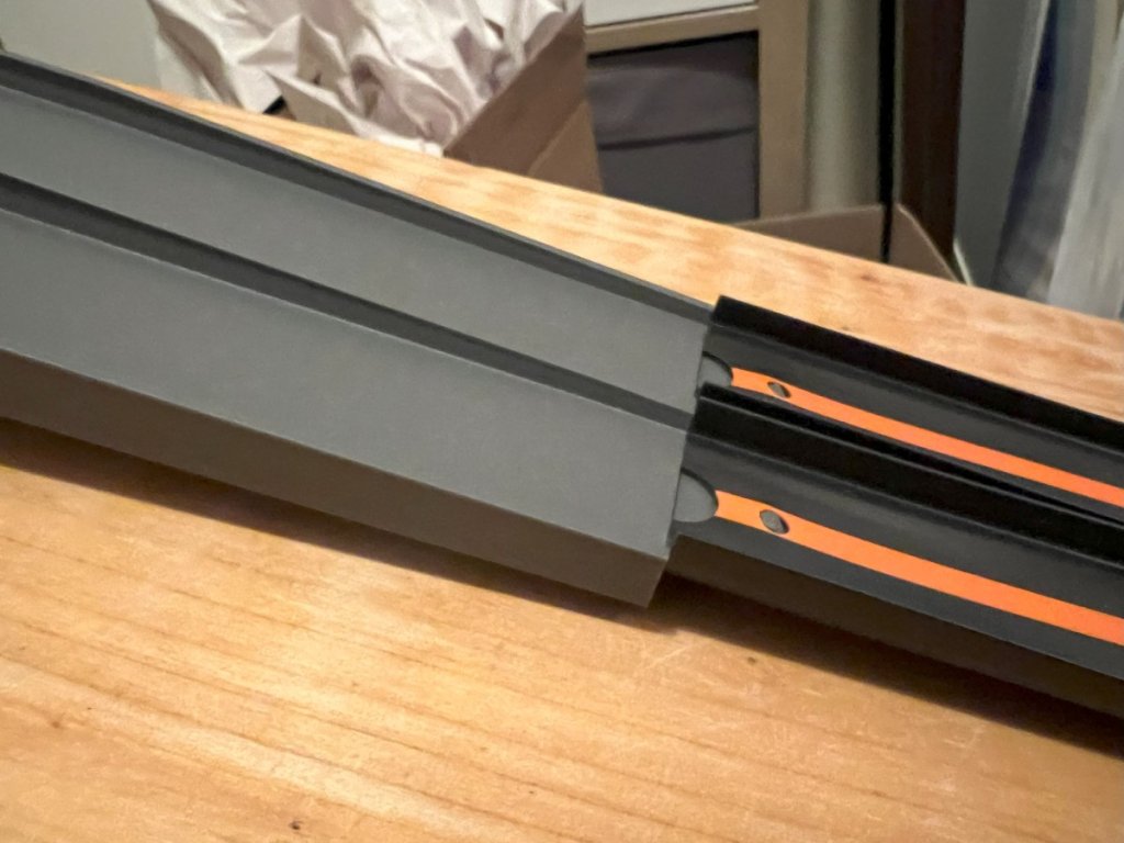

I finally got some time to test some track out. The first question I wanted to answer was whether using hotwheels track upfront was a good mix with the Spoolheads track later on. It seems with some minor work this will be just fine.
As the photo shows the only issue is that the sidewall on the hotwheels track is higher than the Spoolheads track (it is perfect in terms of width, with a tiny bump when the cars go over the connection). During my test runs it caused a problem with just one car, which had lots of extras attached to it (more on this later). I figure that shaving down the edges so they match the height of the printed track will do the trick.
This is great news if so. It means I suddenly get two more turns and a tonne of track to play with, meaning the track could be about 16m long with 5 turns.
Still, on the flip side, is that what I want? I mean I got all this lovely new track as I wanted to experience the wilder side of racing with no lanes. So my first question to you guys is: what's your experience suggest?

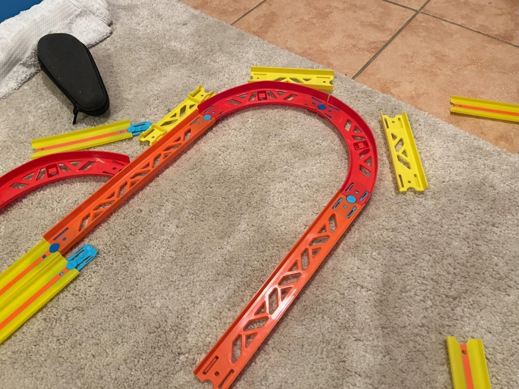

The hotwheels corners are slooooooow. So the opening of the race will need to be very controlled. Also one lane of the corner track will need to raised up to permit the other to fit under it (the problems of fitting two separate roads of the same size side by side - it also seems to preclude a 90 degree turn, after which the natural lie of the track is on top of one another).

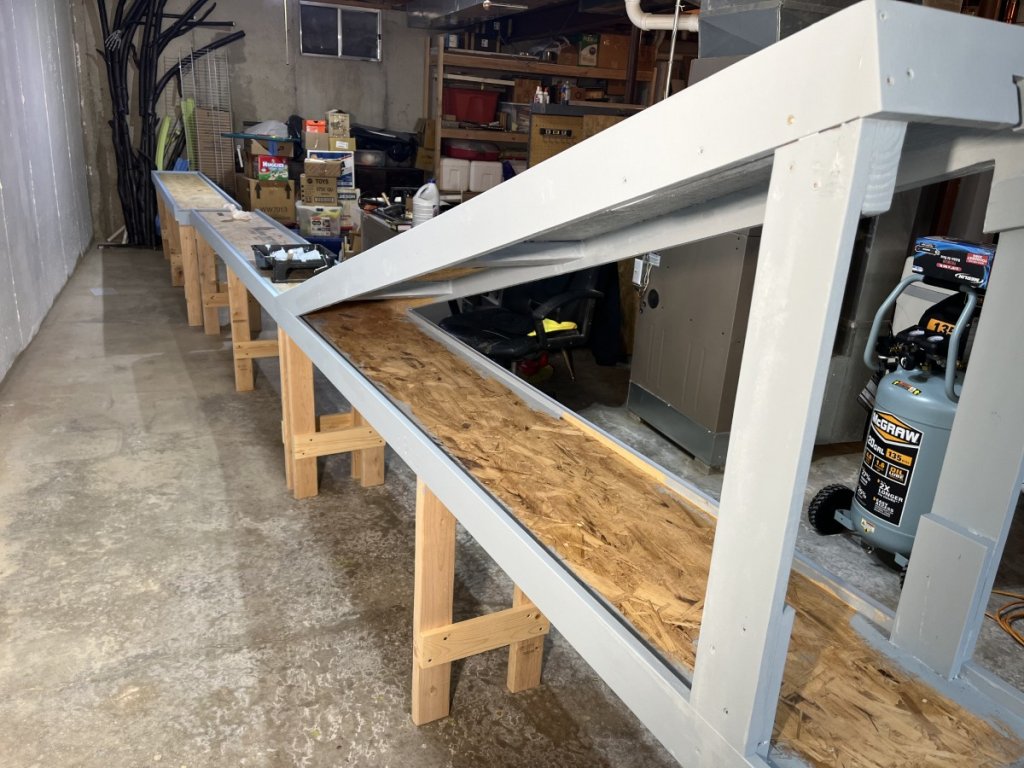

  • Not gona lie, those hot wheels corners suck. I used those at first for my 180 crossovers but struggled to keep them straight and level. the holes in the track also caused some cars to get stuck or loose a ton of speed. Once I upgraded to the Spoolheads crossovers it was a night and day difference. — JBlotner42
  • I use those as "slow 90's" on the jamestown bypass. they won't handle much speed, Interesting idea on the brick cars for testing weight placement — dr_dodge

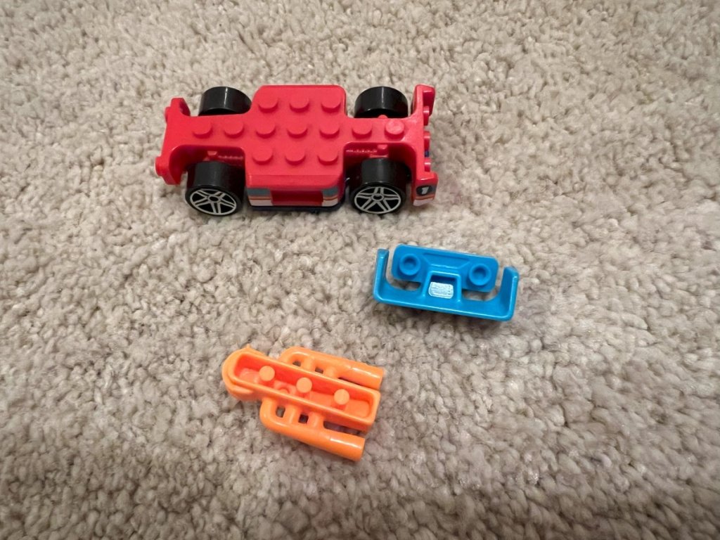

  • Yeah. The extras that come with the cars (in the photos) are very light. But it should be possible to 3D print something heavier. I might look into it if it were allowed. As I said.. it is a H/W car. — Mike_W

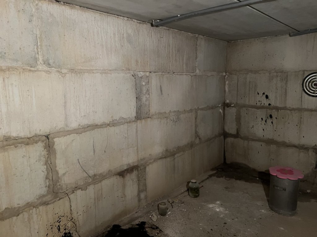

Molds a very bad thing. Friend of mine lost his house, but What about those solar lights to kill the mold? And then those air filters to keep out the allergens. But I can see your vision, good luck and can't wait to see it.
  • Yes. I have kind of been stressing about it. One Humidier has brought it to 60. We have had no real winter as of yet, so rather than the freezing and drying air, we have had near constant rain this Winter. I seem to have the mould under control. *fingers crossed* but yes at 60% it may be back. — Mike_W

Mold is a problem in my house if the humidity is not controlled constantly
I know you didn't get into it much but I'm curious about the floor
there is an old trick, with homes on piers to keep it dryer under them
you'd spread dry portland concrete/lime on the ground, (not redi-mix cement)
It absorbs the moisture, and slowly hardens.
something like that may help dry/stabilize your moisture
when I renovated our house (a stryofoam geodome) and I removed the carpets,
it took 2-3 months to get the humidity under 50-60%
then one day it started dropping, and I can now keep it 35-40%
that difference between 40 and 60 is huge, mold wise
get a mister sprayer, and run 10% bleach/water, and anytime you see mold, spray it.

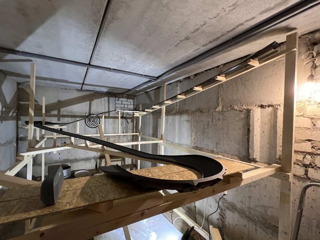

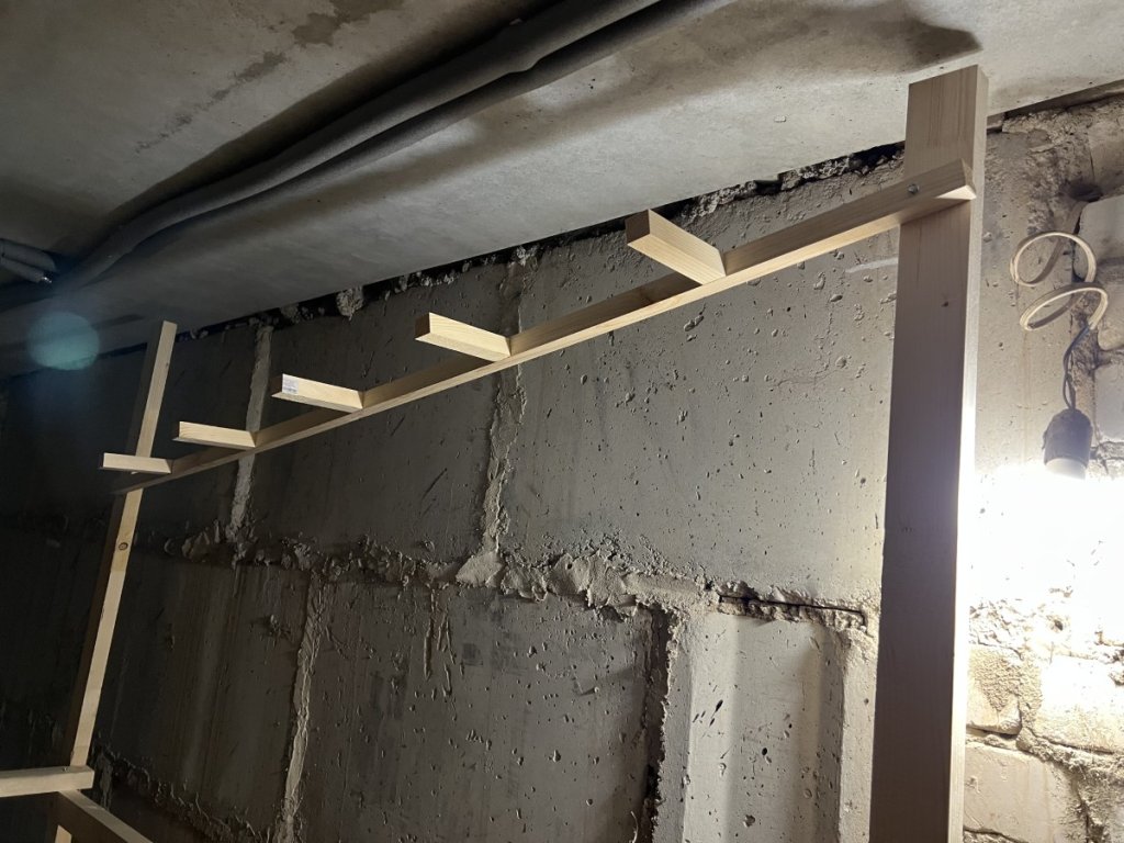

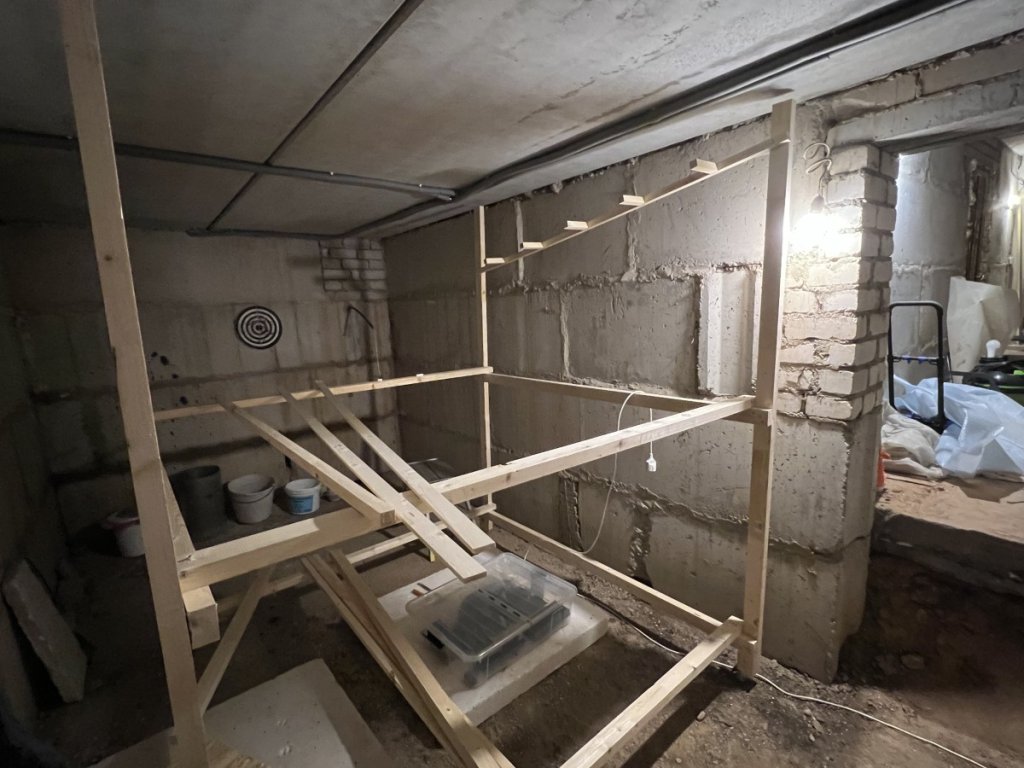

It had been a while since I posted an update, reflecting the time taken to work through a few important decisions. First up was a more realistic determination on the size of the frame upon which the track will be built. In the end I opted for a 310cm x 200cm frame, with a height of 235cm.
This will keep the track away from the walls, while some wheels keeps the frame from touching the ground - both important considerations considering the mould issues I dealt with at the outset (update: no problems for several weeks now).
Now the frame is complete, I have started with the track layout. Through a series of tests, I determined how deep the starting slope should be, worked out an angle and put together a supporting frame for the starting gate and straight.
I decided against using the Hotwheels orange track. The track from Spoolheads helped provide a better start, especially when using the two-land 90 degree corner.  Also, I had a fortunate run in with a friend who had discovered some Crash Racers track and bought me 2 sets as a gift. This meant perhaps extending the fat track portion of the track.
I enclose a few photos of the work done, with commments on what seemed to work best sat each step.

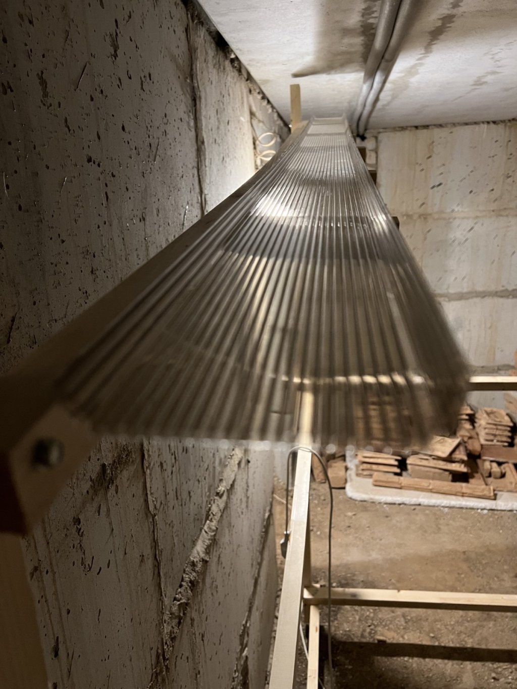

This was the frame minus an extension I built subsequently. You can see the first part of the supporting beams for the track up top.

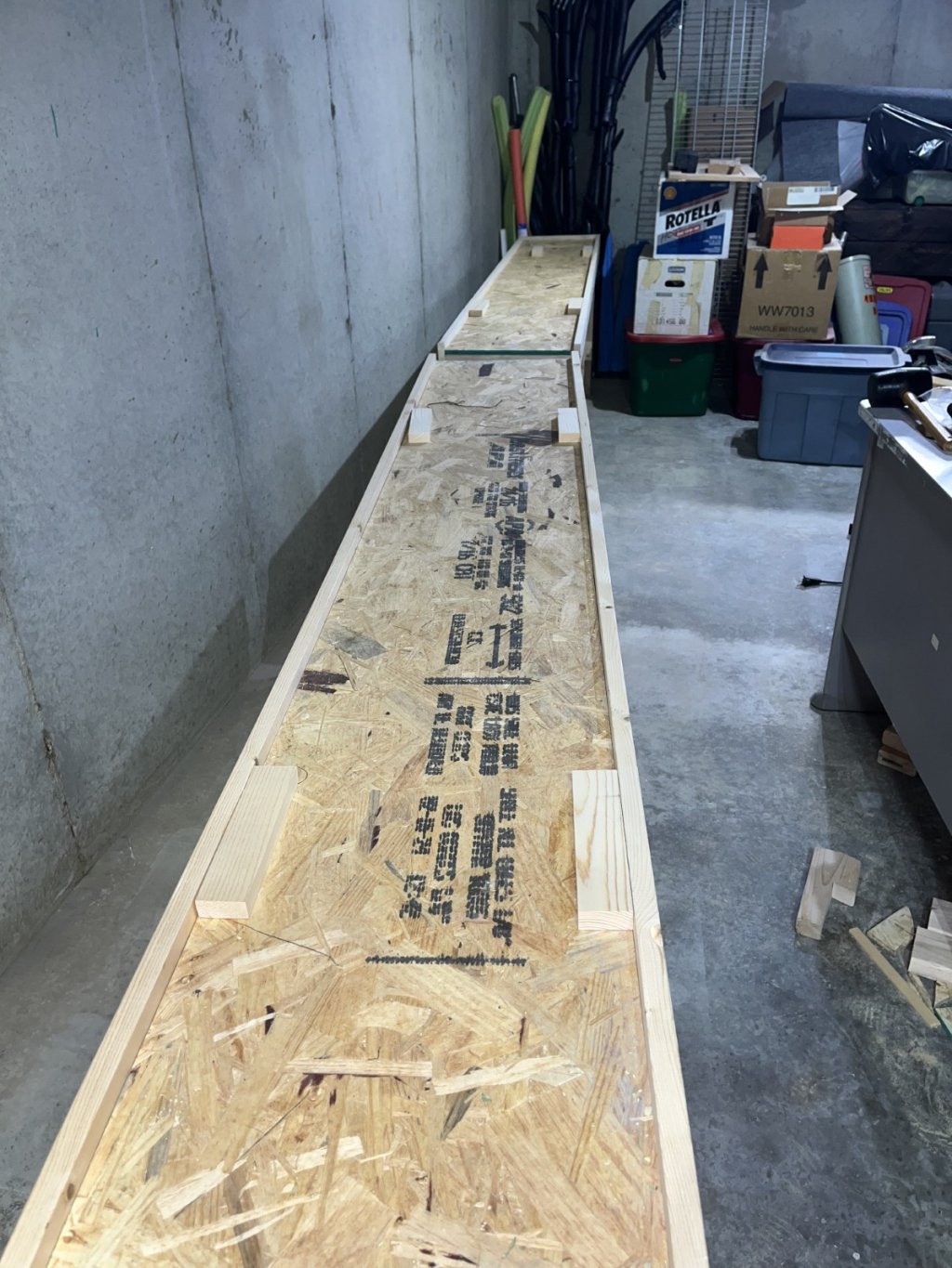

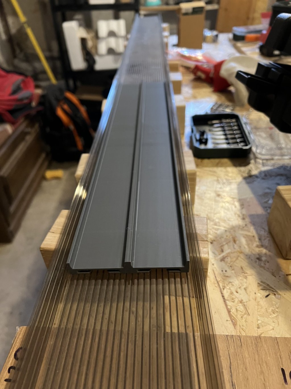

Just as an idea of scale. This is about 200cms long. On top of this supporting beam, I attached some long sections of coroplast. For whatever reason the coroplast I am using 'sticks' a little to the Spoolheads track. It feels a little like static.
The grip between the coroplast and Spoolheads track I hope means that I can I use a temporary adhesive, like blue tack to hold it in place while I do test runs. For the final build, I have purchased some tacks to attach the coroplast to the wooden beams. If more adhesive is needed between the track and the coroplast shelf, I have some velcro strips I hope will do the trick.
Over here, the sheets of coroplast are about 200cm x 1m30 (guessing the width) for EUR 10. I determined the stuff seems strong enough to use a shelf (as long as it is supported by the the beams,
This week I aim to lay down the starting straight, the first corner and the conversion of th track from 2 lanes to open track. This is all Spoolheads track, so I hope to get a solid start, with the Fat Track beneath it for a less predictable finish.

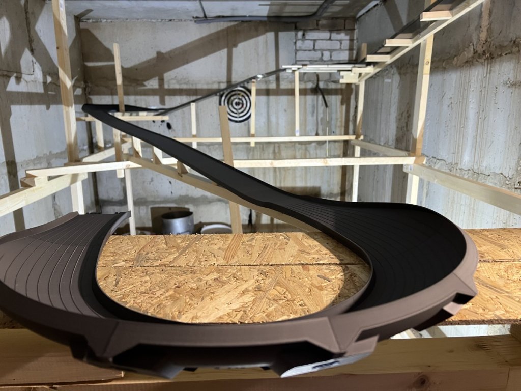

Mike_W 3/7/25
Okay, so the first layout is complete. Testing with 1 and 2 cars went well, but 4 cars has proven a little chaotic, often 1 or 2 cars getting to the finish, with another two stuck on a bend after a collision sidelined them.
I am thinking the best way of helping more cars to finish is to maintain a sharper angle of descent, so have managed to increase the slope running into turn 4. My questions:
  1. I have kept my turns flat, i.e. the track is sloped to the curve, which sits on a 'shelf'. Is it ever a good idea to make the exit sit at a lower height than the entrance? Would this not make the cars more likely to clear the turns? Or does it create too much instability.
  2. Does the stability of the track matter? As I am testing, I wish to avoid attaching the track to the shelf for the moment. But I cannot help conclude that the better performance of the Spool Heads curves to those of the crash racers set reflects their stability.
