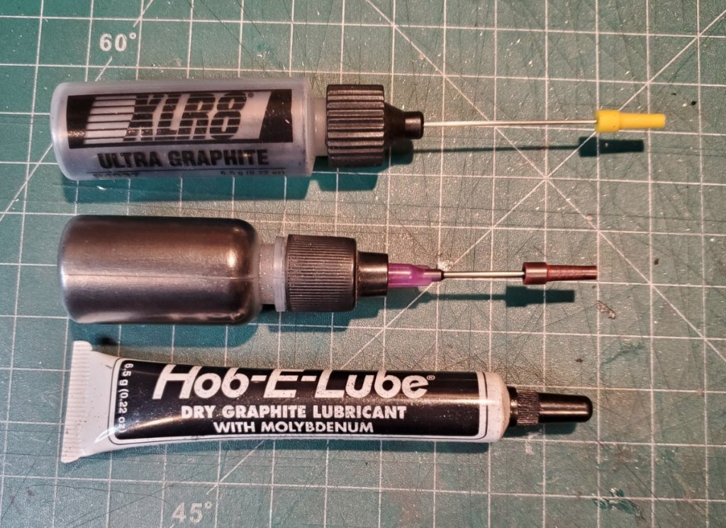

Great discussion! I've been using three types that have already been mentioned: XLR8, Maximum Velocity, and Hob-E-Lube.
I generally start with Hob-E-Lube on cars while wheel farming, then switch to the others with the long applicators after assembly to get into the wheel hubs easier.
I'm not really convinced that one brand is really better than the other. I think the "Secrete Sauce" is just having a great set of wheels.

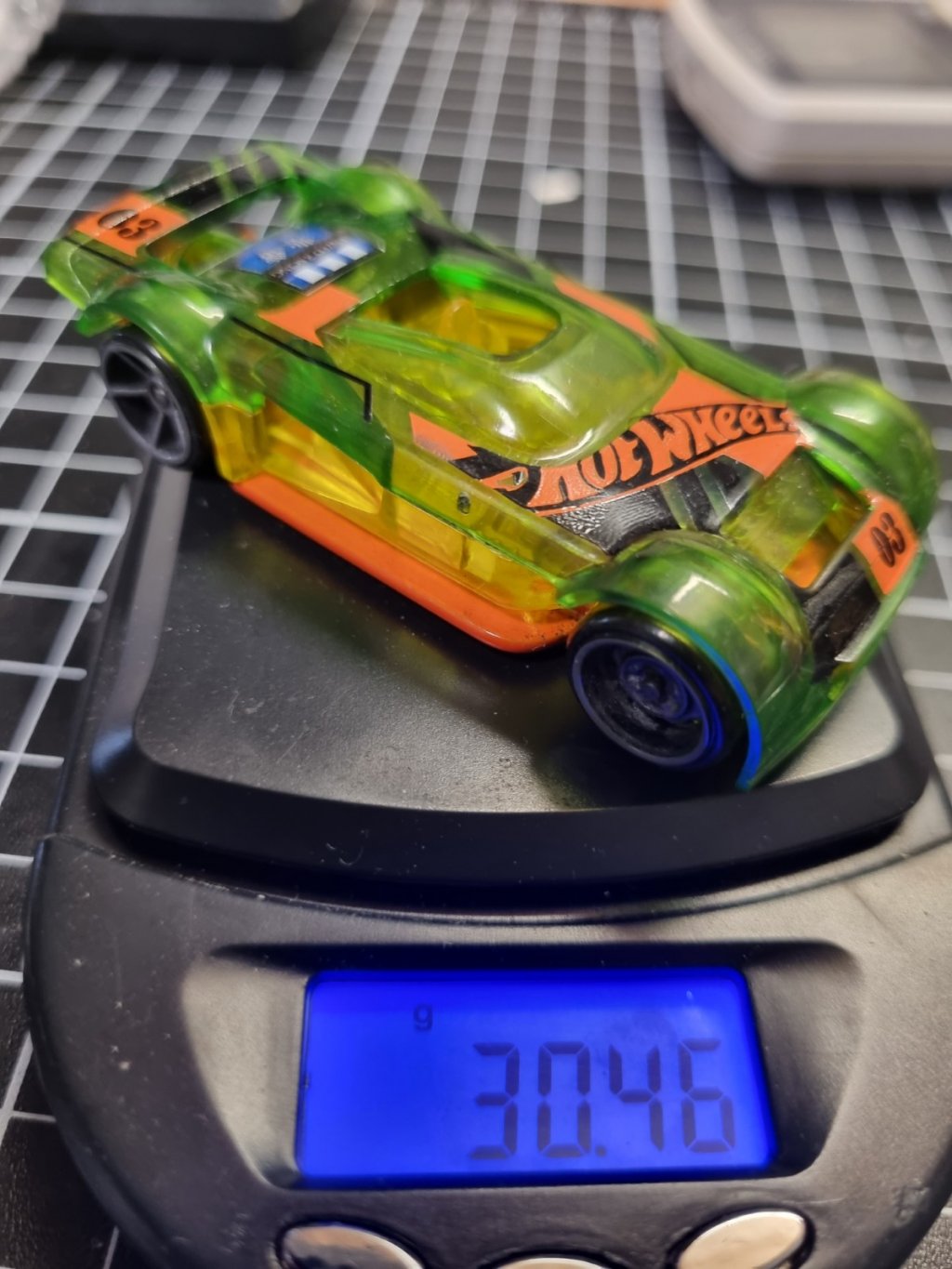

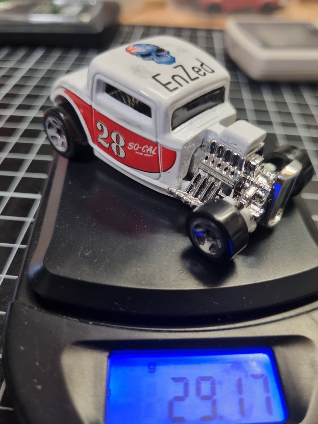

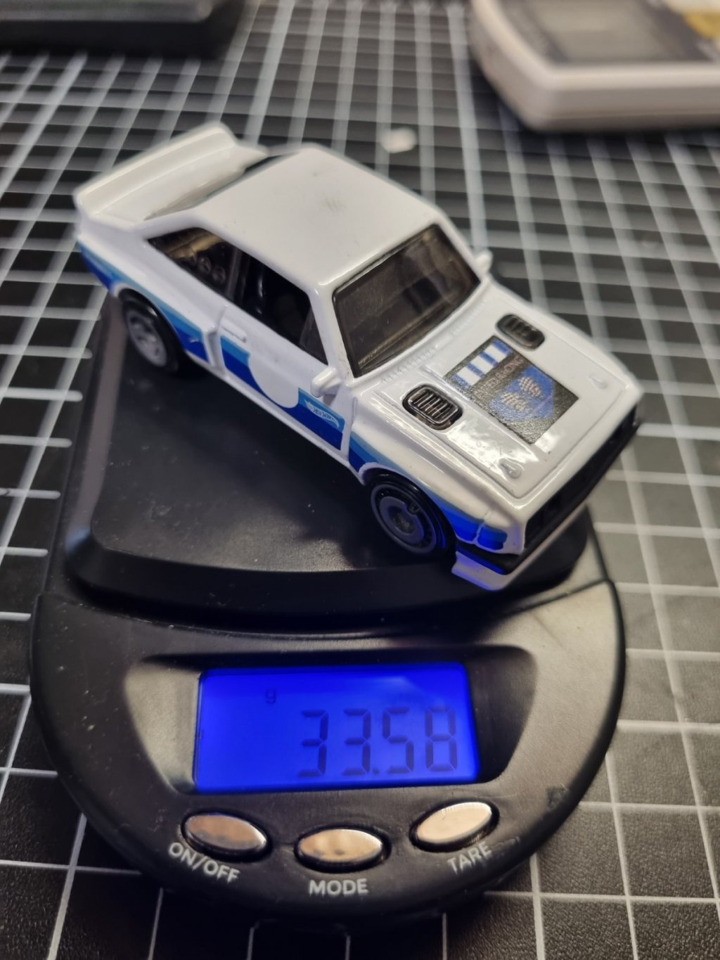

Just a follow up ladies and gentlemen. I bought some extra fine graphite from Ebay and also some isopropal alcohol (?)
Mixed the fine with the course, also made up a 2-1 ratio with the alcohol and ended up testing 3 different mixes. The IPA 2-1 worked a treat! All 3 cars were exactly the same model with similar 'stock' speed. The IPA mix was consistently quicker and the mixed blend was the slowest.
I've sent 3 cars to the 35g tournament (Flips Racing) with all 3 different graphite tests so it will be interesting to see how they go. (The escort has the IPA, the Ford has the ultra fine and the fantasy has the blend of course/fine. Watch this space....
