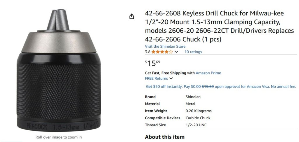

start with something to hold your bits.  replacement chucks for a drill are cheap
and some sharp bits.  buy the bits in sized packs, I buy Gyros on amazon

  • Okay, so i’m about to order the supplies later today, and wanted to ask which ones you get, Cobalt or HSS (High Speed Steel)? And I also wanted to know if the drill chuck you sent me is a specific type you need, or I can just find any other drill chuck? And just to confirm, the sizes are #51, 3/16, and 1/4, right? Also, you were mentioning #51 is for screws, so does that mean you screw the base back together, or can I just glue it back together with epoxy resin? And one last thing, do they break easily? Because I see them in packs of 10+. Thanks a lot, you have been the most helpful! — Revurbo
  • the 51's break easy until you get the hang of it, and the 10 packs are the way to go. I screw all my cars together. — dr_dodge
