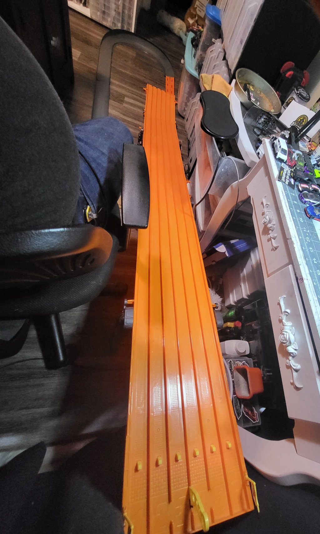

I'm having a dillema with testing the cars sent out to race. Priorly I had nowhere to test my builds before mailing out, now I have a little setup that I don't think gauges my cars' speed accurately. I don't have a lot of room in my apartment for setting up an 8'x4' base for a standard downhill track footprint.
I'm currently using a Hot Wheels 6 lane drag track with either more straight lane exentions(for drag), or a connected Crash Racers 180 followed by two CR straights. Cars that look fast on this setup never perform this way once racing at the tourney.
Any help would be greatly appreciated!
