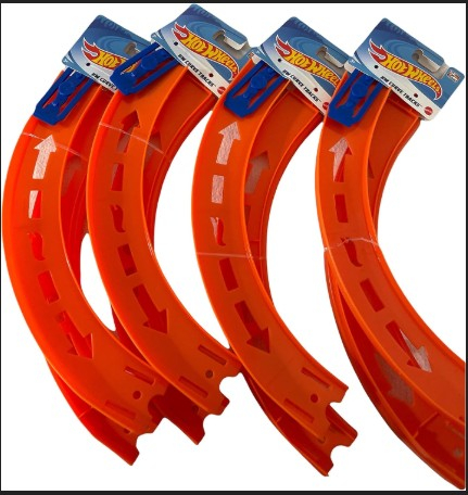

If you desire turns in your track design this could complicate things. Does Mattel even make full racing sets anymore? All I see today are specifically themed play accessories with hardly any space to run the cars
  • dollar tree by me has the "arrow" curves — dr_dodge
  • "Arrow Turns" is a new term to add to my diecast lexicon. Perhaps messaging me a photo would help. Dollar Tree's website was surely lacking there — Chris_Hood

arrow curves
  • Nice! I will have to keep my eye open for those! — Stoopid_Fish_Racing
  • I haven't found any of those. — Dutch_Clutch_Racing
  • only 1 dollar tree out of half dozen carries them. — dr_dodge
  • I had something similar in mind when you mentioned them, grateful for the clarification Doc! — Chris_Hood

  • I have had moderate luck with the arrow corners, I wish they were solid road deck, as some cars can get "disrupted" as they go over the holes — dr_dodge

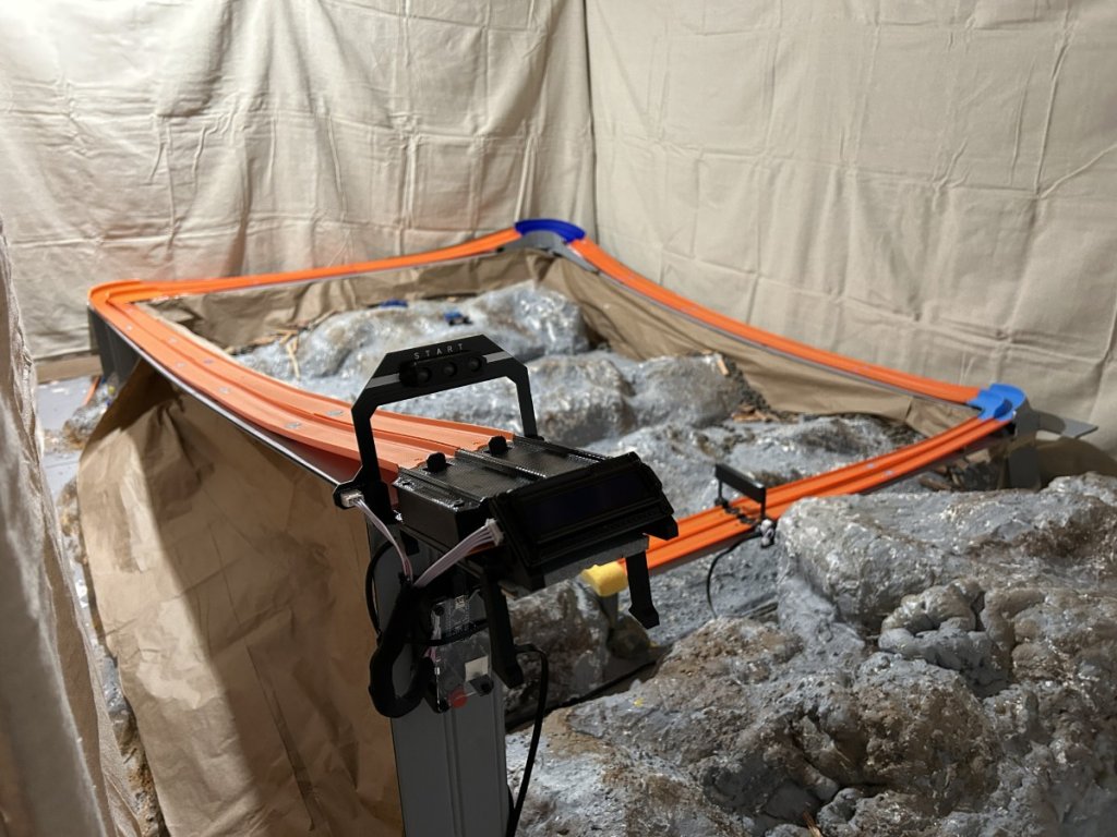

Take a look at my new track just listed: Timber Creek Speedway. I've used standard track from Target and Dollar Tree along with 3d printed fast curves that I sourced from Etsy. Overall length is 20FT. So approx. 22 pieces of mixed length.
  • you have vids up yet? — dr_dodge
  • I just saw a website (very nice, by the way) — dr_dodge
  • Thank you v much! Yes I have a video of today's race on my site/YouTube channel. :) — Ozboy
