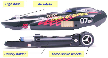

After a little digging, I've finally found the source of the Indonesian dynos. They use the modified chassis/motor/drivetrain from Tamiya Dangun Racers.
These were 1/32nd scale free-running electric cars that were much like oversized HW Sizzlers. From what I've gathered, they were "all the rage" in some parts of the world but were discontinued by Tamiya about 20 years ago. They were available in different chassis and drivetrain configurations and many performance mods were available. However, while discontinued, there are still several of these cars and components gathering dust on vendor's shelves right here in N. America. The link below is the best deal I've found thus far.
I've already recieved 1 kit and have more on the way. I'm going to attempt installing 5 or 6 of them in a plastic tackle box.
