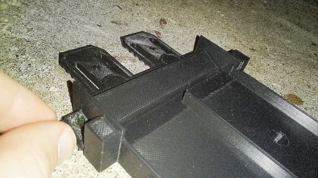

Pictured is the gate with the car. The print quality was alright, though nowhere near 3d's. I also own one of his gates so this review may contain a lot of comparing.

I also noticed that there's no way to start the gate with a string, as the nub is too small to drill a hole in and no hole is present to loop string through. If you're planning to film your races, your hand will be in the footage. You can also see that if your track starts with the cars traveling left-right then you will have to reach around to start the gate.
You can see in this photo that the gate has two little half-Hot-Wheels-blue-connector things to join track - on both sides of the gate. The cars sit much closer to the "ground" than they do in 3d's gate, which can be good or bad. The lanes are also much farther apart, but I haven't tried connencting the gate directly to Augmoto or Crash Racers track.

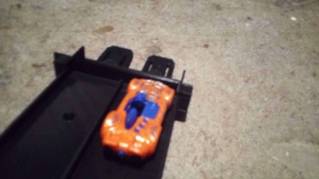

The lanes were a little wide, which is good for fitting different/bigger cars, but I found that due to the way the gate works, the lane divider couldn't be continued all the way to orange track - there was a small gap when the gate was down. This led to some cars drifting out of their lane and crashing when the orange track started. Not good for fairness.
Here you can sorta see what I mean.

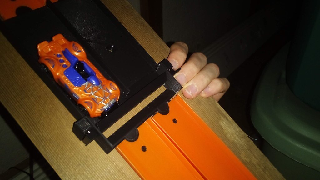

The gate also has two little holes - one in each lane - for screws to fasten the gate to something. I wouldn't reccomend this, however, because when you flip the flap to start the cars, the bottom of the flap rubs on the surface the gate is on. It seems that this part of the gate was meant to be suspended in the air, but it isn't, and there's no way to clamp the gate to anything so that it is.

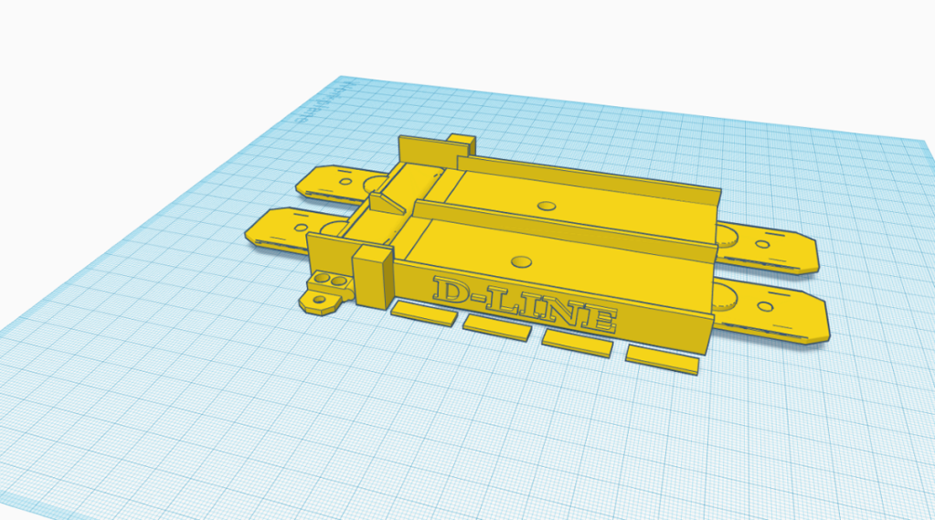

Hello all,
I have re-designed the gate to extend the divider.
I am printing them now for testing.

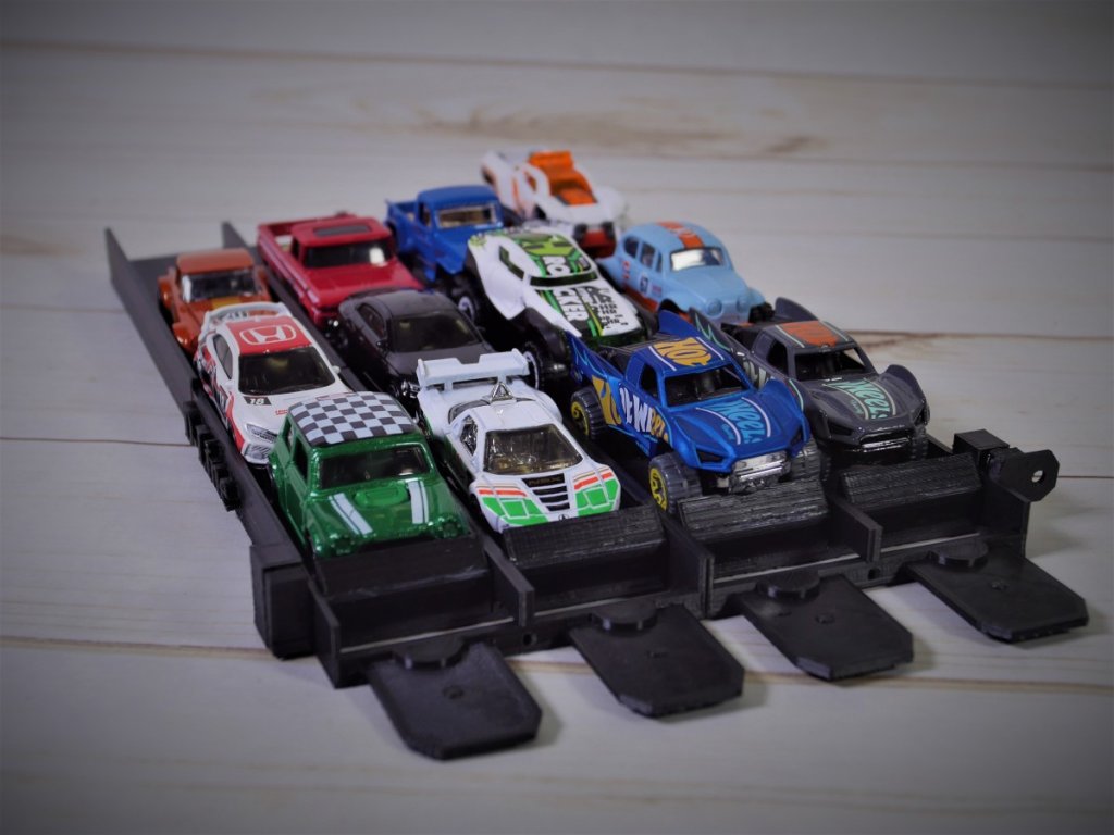

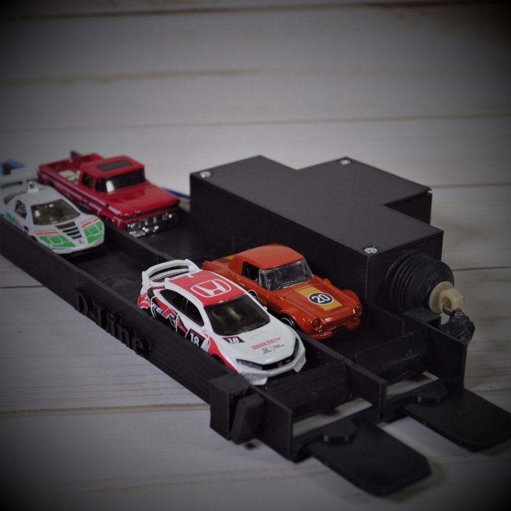

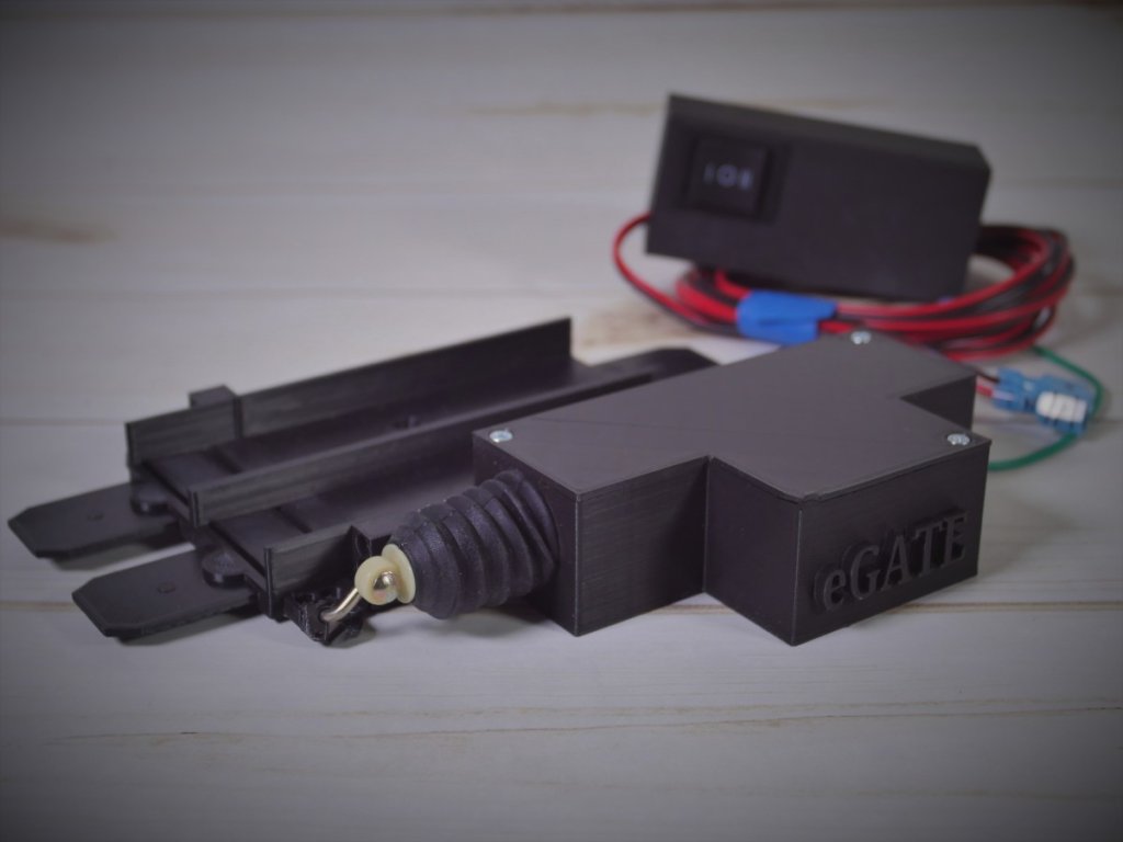

So, the gates have evolved even more. I have added a remote with a 10' cord. I have also provided a 2, 3, 4 lane option.
I have learned from mistakes made. Thank you for your imput.
JLHKRAFTS.COM
- Very cool with the remote start. Just a tiny solenoid in there or whatever? But looks like a wired remote, yes? — redlinederby
- If you're interested in getting an official review, PM me — redlinederby
- Wow that looks cool! — MrFishyFish
- Not a tiny solenoid.. I held back 50 cars with track attached to the back of the gate.. LOL — jlhkrafts
- That must have been a fun run to watch! — SpyDude
