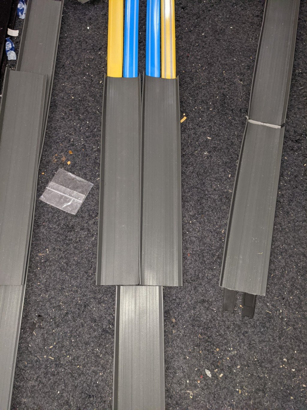

Some other track that has been forgotten along the way is Hot Wheels Nascar Speedway.  Many wrote it off as just another Sizzler's or Fat Track because the Nascar cars were basically Sizzler cars.  However, the track is only 2 wide, not the usual 3 wide.  It is gray in color, and appears to match up nicely to the Adventure Force track in look and size.  In addition to having straight pieces, the set also includes two 'pit stop' straight pieces where the users could cause their Sizzler car to pit and then recharge them mid race.  For regular downhill racing, these would make for some good pieces to break up the monotony of plain straight pieces.  There are also nice 2 wide curves included in this set.
Also, the Hot Wheels Light Speeders Challenge set is another 2 wide open track system produced by Mattel.  It is black in color, but is mostly made up of the same type track pieces as the Nascar set.  It does include some 2 wide curves as well.  There are some cool additional pieces like a 2 to 1 lane merge piece that I haven't seen anywhere else.  A complete set also includes some single lane track that is different than the usual Hot Wheels single lane.
One last forgotten track set by Hotwheels is the Super Changers Drag Strip.  This includes what looks like 3 wide track with higher side walls.  It comes will long straight away pieces that connect with a similar system to that of regular Hot Wheels single lane track.  The connectors fit in a middle rail under the track.  This track is black in color and seems to be much harder to find than the other tracks.  I have some on the way, so I'll be able to let you know just how compatible it is in the coming weeks.  But overall, the higher walls look as though they could be beneficial in keeping your cars on the track.  Although, they could hinder filming.  There are no curves included in this set, as it is purely a drag strip.
Just some other track sets to think about including in your searches.  Hope these can help you out.

Turns out the Light Speeders set I mentioned, while chock full of great two lane pieces, is not compatible with other 2 lane track.  The pieces have a middle connecting piece, where most all other 2 lane tracks have two tabs to connect the track, and not the single one in the middle.  The only feasible way to make an awesome track using these pieces is to buy multiple sets.
As for the Super Changers Drag Strip, it is an amazing source of straight 3 wide track.  There is a total of 40 feet of straight track included.  Unfortunately, that's about all you can do with the track.  While it is 3 wide, it is not 100% compatible with Sizzlers track.  It, too, is only joined by one connector in the middle.  There are guides on the sides of bottom of the track that are just too tight to get it to fit with fat track without some sort of manipulation or cutting involved.  There is no way to connect this track directly to turns.  It would entail a transition to the fat track and have the fat track connect to the turns.  However, there is no going back from fat track to this track because the Changers track is just slightly thinner.  If your cars are running along a rail, there is the possibility that they will hit the Changers track in the transition.  But if you're looking to do a 40 foot 3 wide open race, this is an awesome track to work with.  The walls are higher than any traditional track sets, so it is highly unlikely a car will skip off the side.  And while a plastic track, it has a different feel than the fat track, and doesn't seem to invoke as many 180's on the track.
I finally got around to pulling these tracks out with the intent to set up some major racing.  You can imagine my disappointment when I found these flaws.  But I had to make sure to relay this information to my fellow racers to make sure no one else ran into these issues and everyone knew exactly what to expect before buying.
