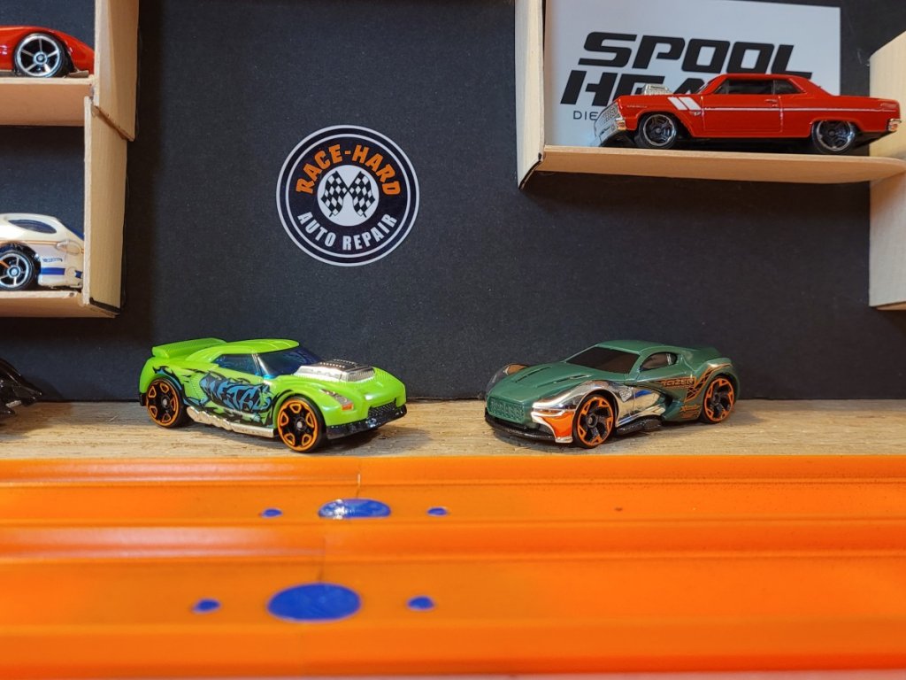

Someone posted on here about Metal Machines. I'm not sure who it was but me being curious, I bought 6 cars at big lots dusted all 6 and to be honest I  found speed with these 2! The one on the left weighs 26g  and  it's in the top 24 of my ranks of 30.99g and below. The one on the right weighs 32g and it's in my top 24 ranks of 31 to 40.99g. I really didn't think I'll find speed with these castings.
Some of them can be fast!
  • First time having Metal Machines. Both have plastic body and base. — Zizzer_Prime
  • I have wondered about plastic chassis and body being better... you have no high cg to speak of and can add weight where you want it almost exactly... — Stoopid_Fish_Racing
  • Pardon, how could these be made with plastic body and plastic base? It's my understanding Zuru have metal bases throughout the series — Chris_Hood
  • Not these castings. That's why one of the cars is extremely light. 26g. — Zizzer_Prime
  • Incredibly strange. Wouldn't that make the only metal bits the axles then? I'm hardly qualified as an expert on Zuru — Chris_Hood
  • Hey Chris my apology. Yes they do have metal base. I just opened one up and I'm going to start modifying one. — Zizzer_Prime

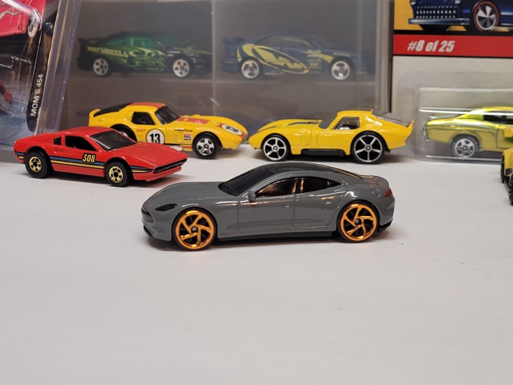

Karma meets Metal Machines! Just a mockup for now. Both front and rear axles are not glued yet. Definitely needs some modifications on the fender well but I like what I see!

  • Very nice! Yes I saw your car at Jungle Falls! Faster than mine! Good luck! — Zizzer_Prime
