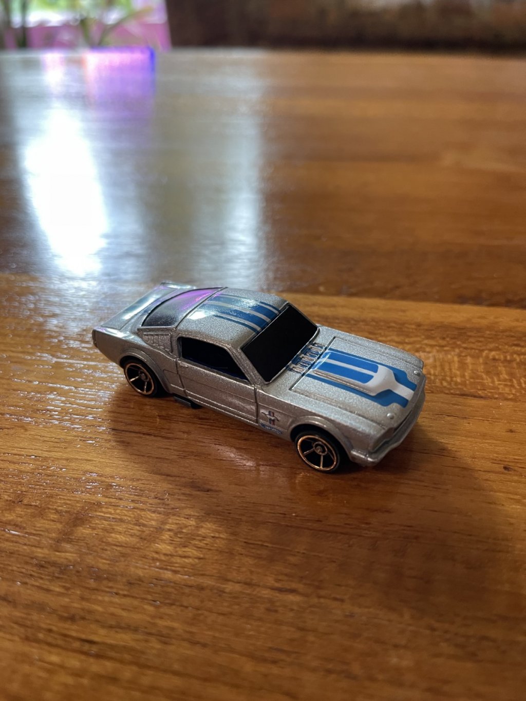

The Car:
Entered into MCM American Muscle, qualified 19th overall. Did not advance past the first round. Proved to be more adept at finding "shortcuts" than winning races. Granted, it was my very first race and I had to somehow compete against BlueLine and R-Lo -- but still it wasn't an impressive performance.

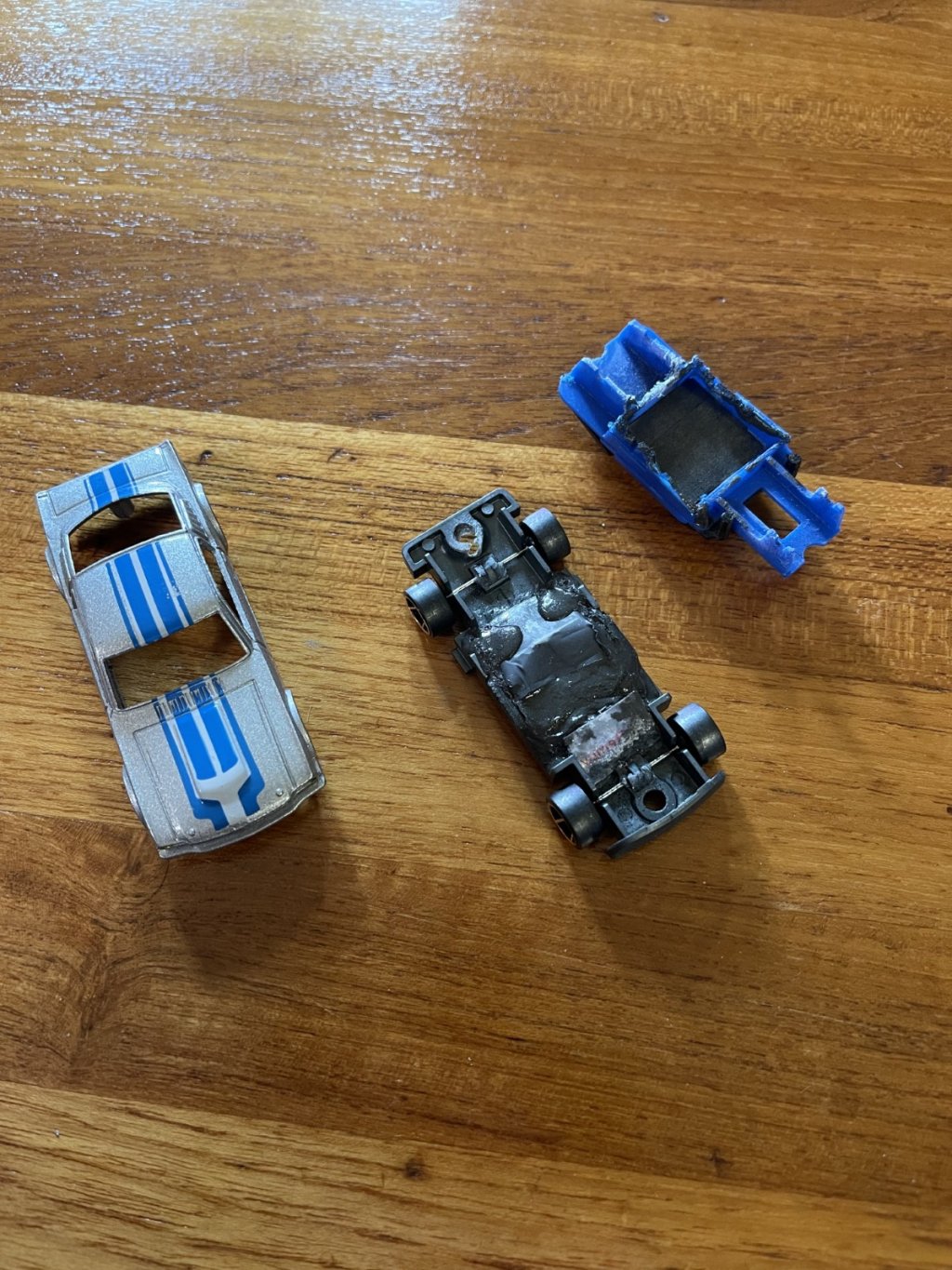

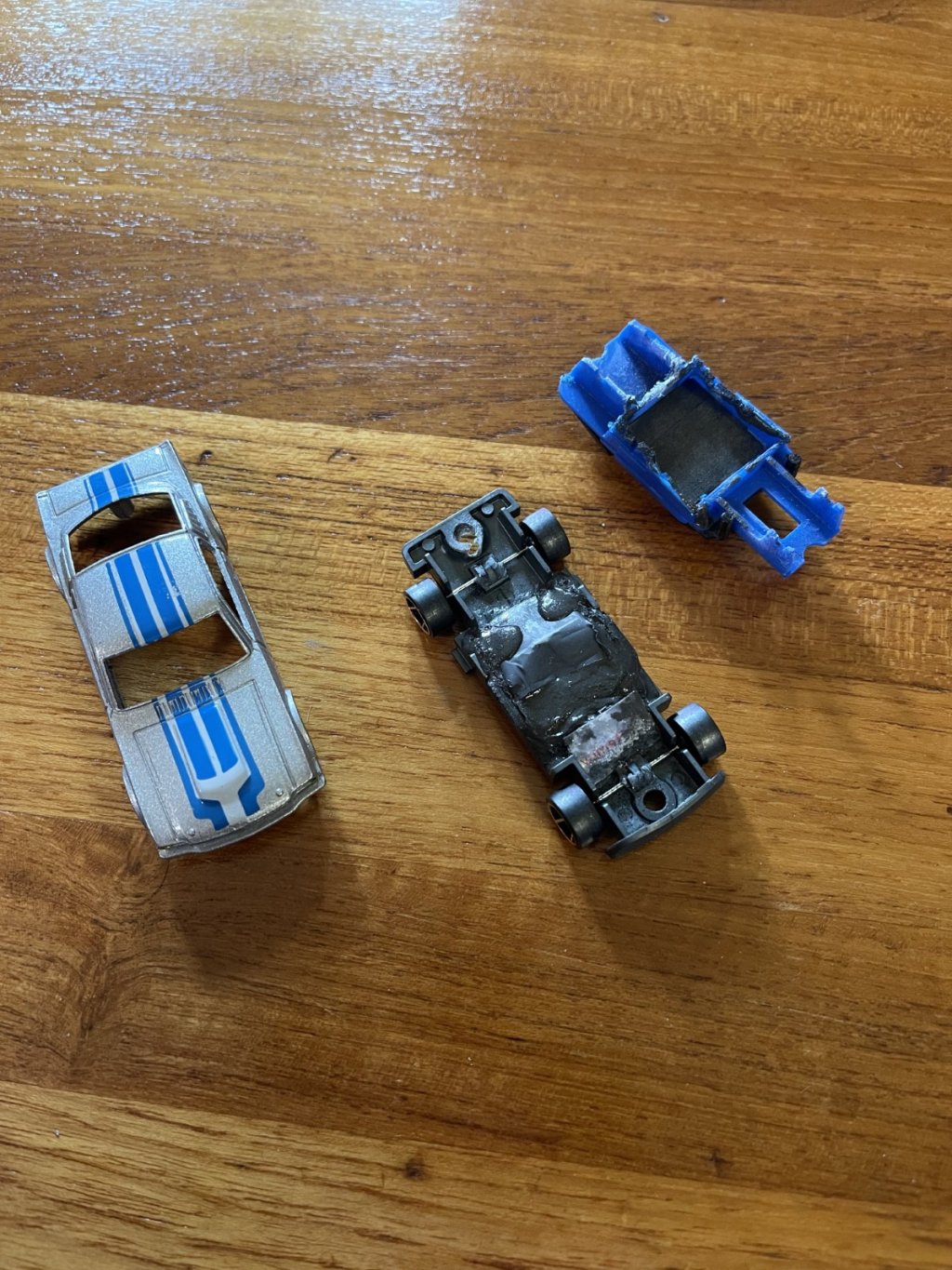

Car's internals. Behold and bewilder, at how horrid it is. Tried to use the interior plastic (sans seats) to reduce how much the putty "crept" towards the wheels. Also tried to use scotch tape and some random plastic as barriers between axles and putty. Both barely helped.

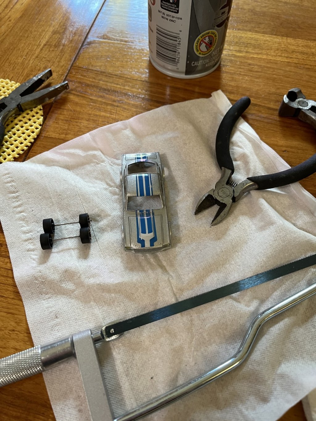

Step 1: I started by taking a mini-hacksaw to amputate the sections of the car that contained the axles from the section that contains the putty. This serves 2 purposes: removing the possibility that the tungsten "creeps" to the wheels/axles and permanently ruins them--but it also makes the next step possible.

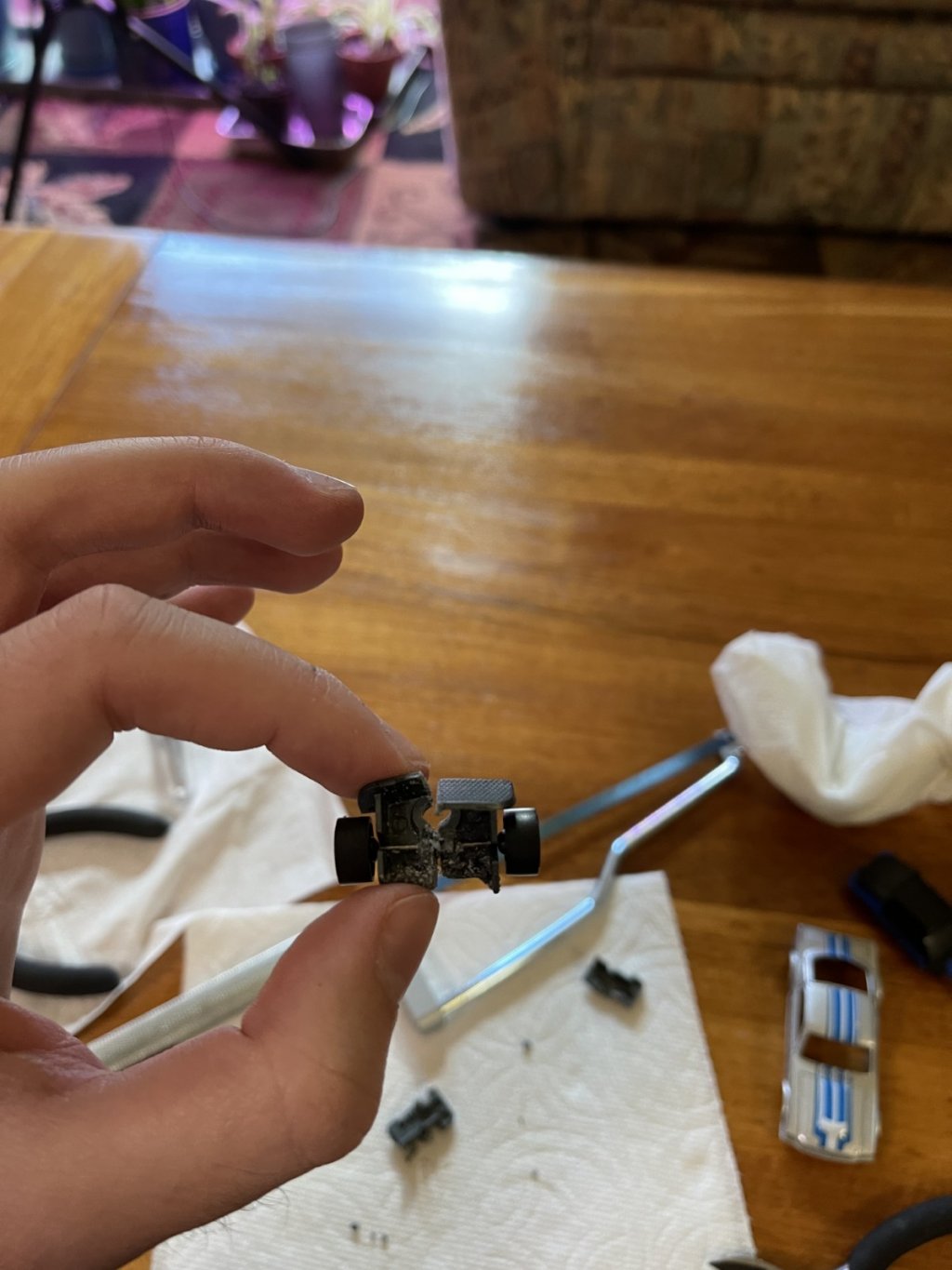

Step 2: Use mini- hacksaw to cut these sections in half from the back (and probably cut a bit of meat off your fingers, too--be careful). You might have to come in from the front/back as well to totally cut it in half without cutting the axle. After this step, the only thing connecting the 2 parts of the chassis is the super glue gel holding the axle down.

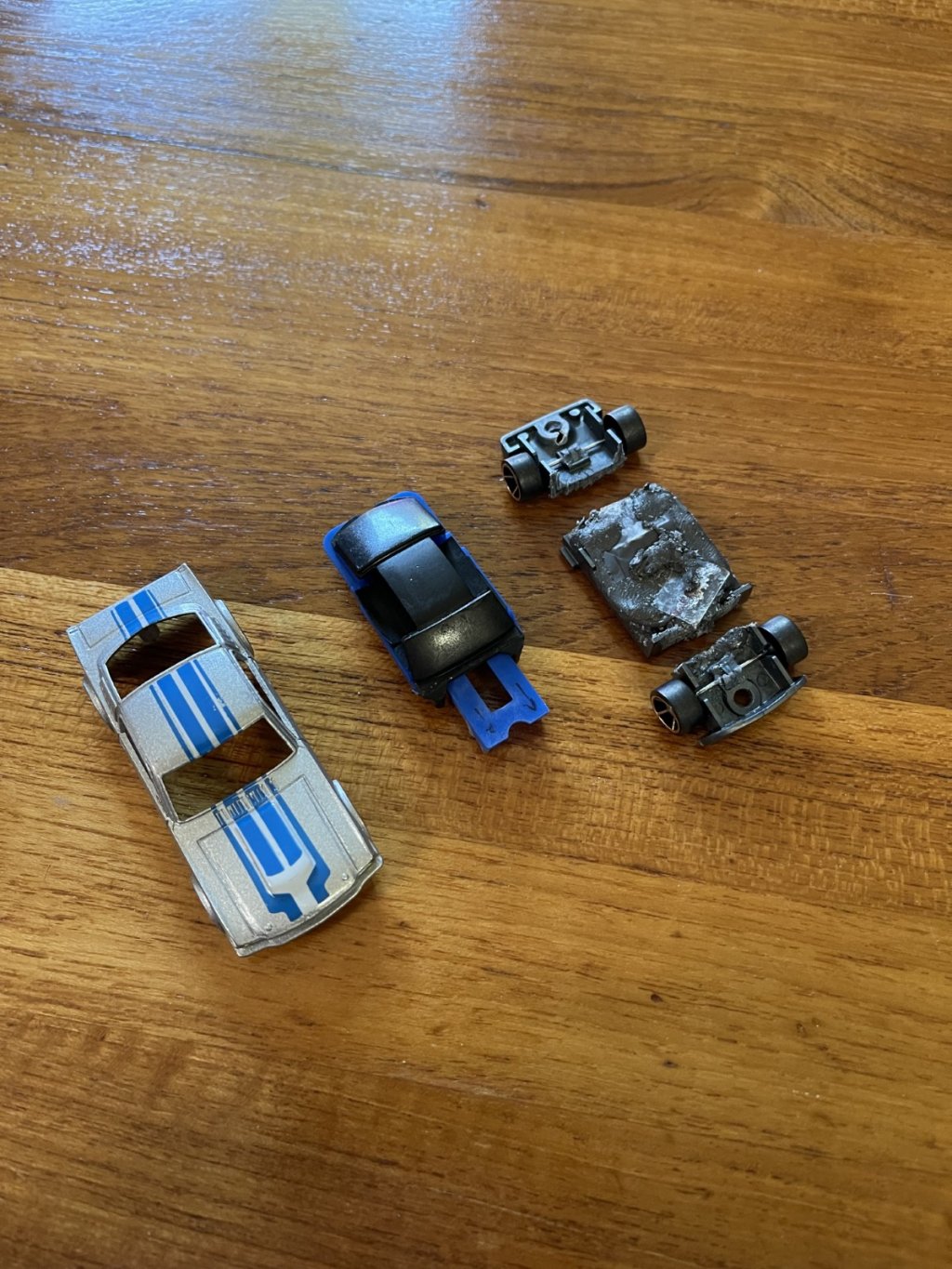

Step 3: Then you twist the chassis like so. This allows you to have easier access with cutting pliers to the cross-section in the middle of the lump of adhesive. With some luck, the super glue gel is brittle enough that cutting them on both ends frees the axle. Cut them vertically, if that wasn't clear already. You can try to skip to this step without giving yourself the cross-section and pain with the mini-hacksaw, but it really isn't easy--trust me, I tried.

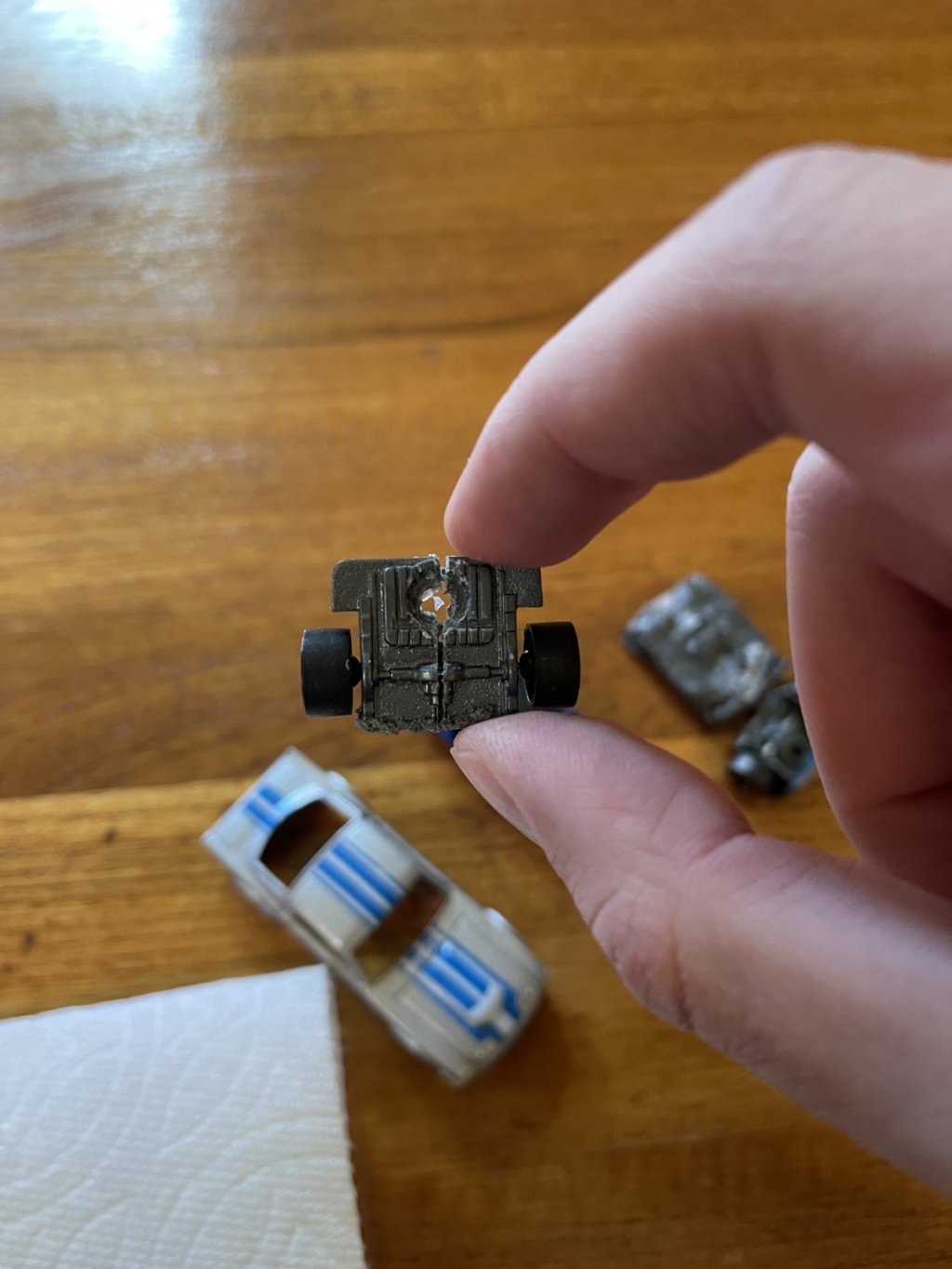

Step 4: Taadaa, your axles are free. I blasted them with compressed air to try to get rid of any potential FOD from plastic shavings or dried super glue crumbs. It's inevitable the speed of these axles gets reduced ever so slightly by FOD in this process, but at least they live to race another day--without putty or super glue ruining them.
Bonus rage bait--what putty creep looks like when it ruins your wheels. It seeps out through the sides between the body/chassis to "grab" the wheels, more often than not.
