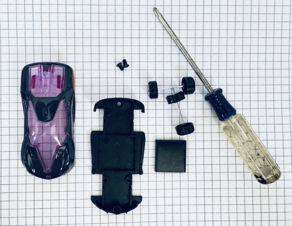

These are interesting. How about a cheapo diecast that's held together with screws, has easily replaceable axles pinched between the body and chassis so they pop right in/out, and in place of an interior a metal weight with plenty of space to add much more if you want? Well, that's a Turbo Wheels "diecast racer".

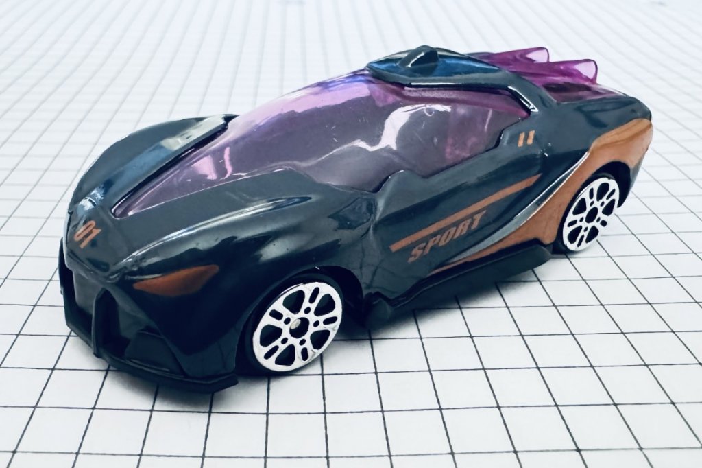

After seeing them at one of the Dollar mini-malls and being intrigued by the packaging and not afraid to spend $1.25 on probable junk I went all in and bought 3 packs. After ripping one of the packs and checking out the car I was disappointed to see it was a plastic body/chassis combo and wondered where's the metal? After taking the body/chassis apart I laughed out loud when a small metal block fell out. Looking a little closer I thought 'well heck, with no interior and a flat chassis there is plenty of room for weighting this car"'  Toss the junk axles/wheels for a prepped set, screw it back together and in less time than it takes to drill a pair of posts I could possibly have a contender.

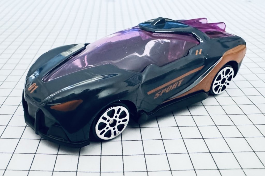

The car weight on this one checked in at 27g and I was able to jam enough lead wheel weights under the body to get it to 55g with hardly any effort. Spend a little time fitting weights I could see this thing hitting 75g.
