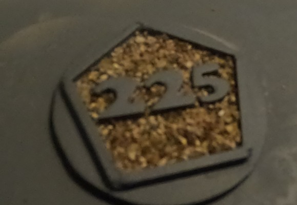

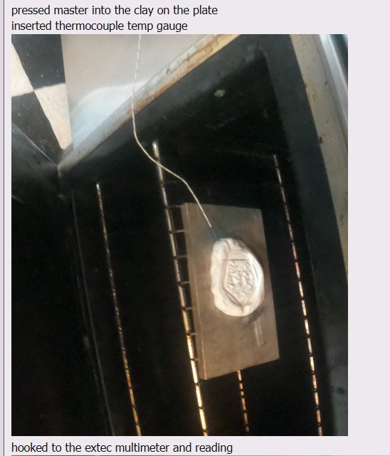

made a master first of in this case a logo
wood and sifted play sand coarse

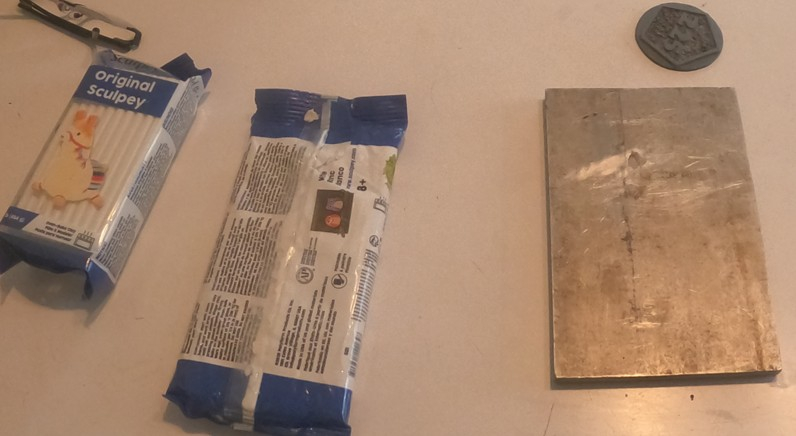

then took this stuff
bakey clay off of amazon
you can see a 1/4" thick aluminum plate
and the logo master

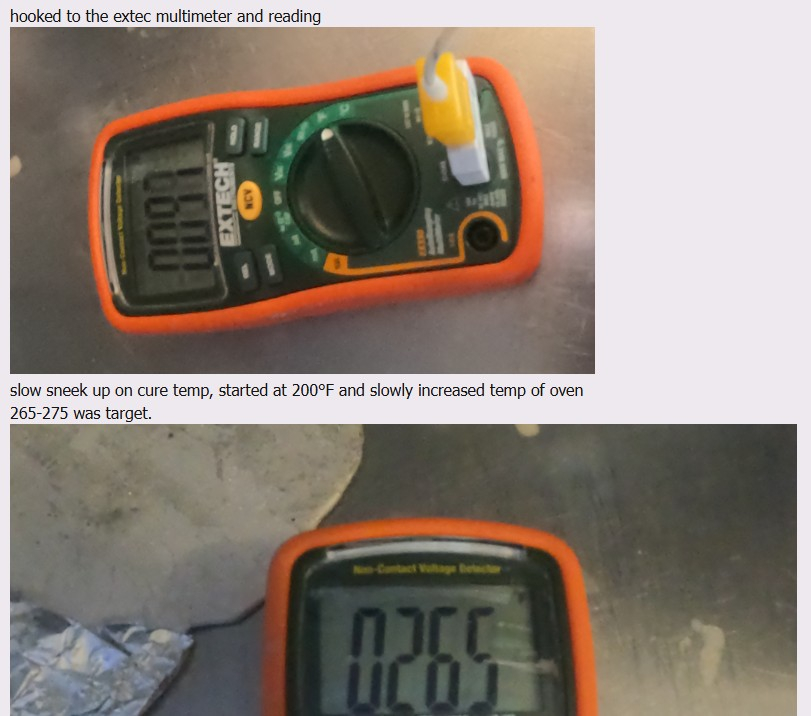

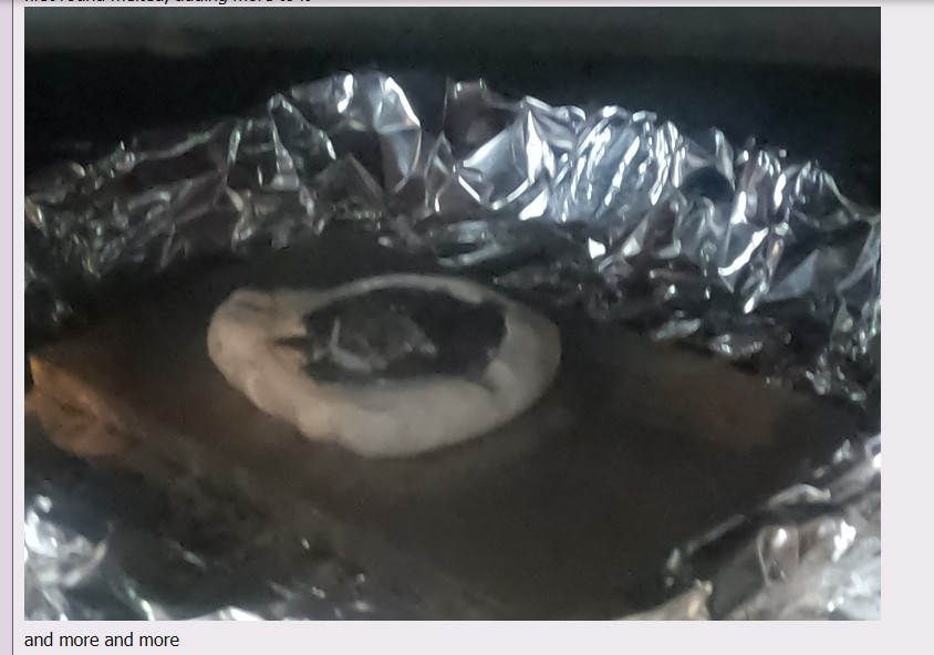

according to the clay mfg cure temp was 265-275

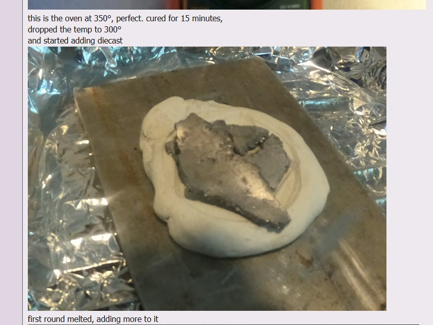

took 20-40 minutes as I lowly snuck up on it, then 15 min at temp

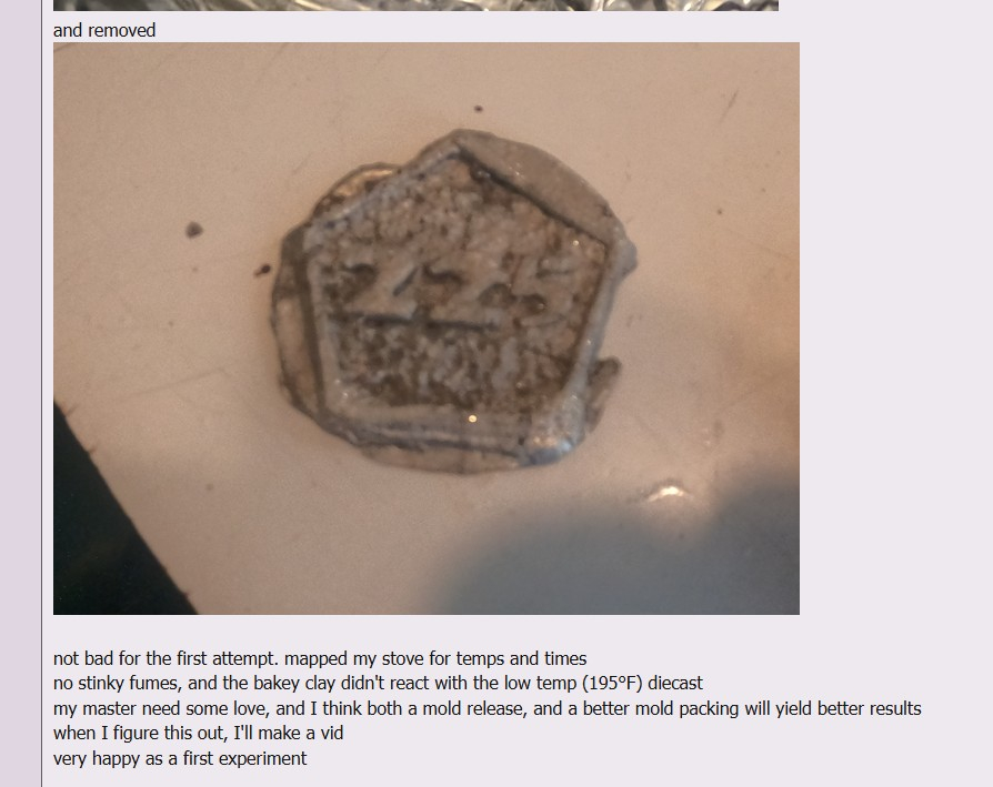

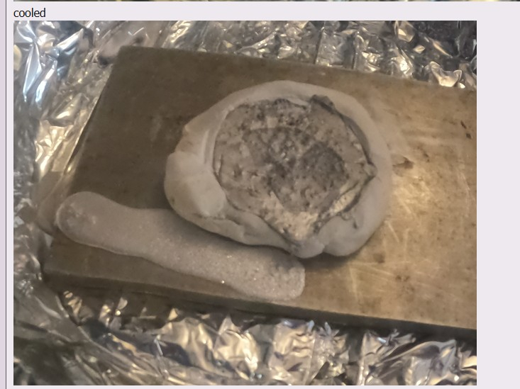

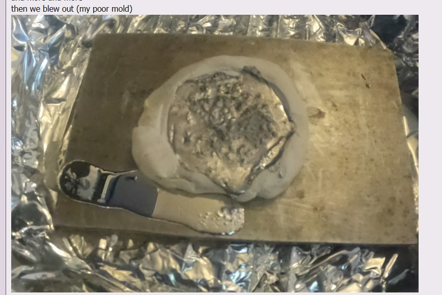

added diecast to the hot mold
so, even though it's hard to see, it reproduced the master in great detail.
I had air voids from pressing it into the clay.
but the hot mold on the aluminum plate worked wonderful.
