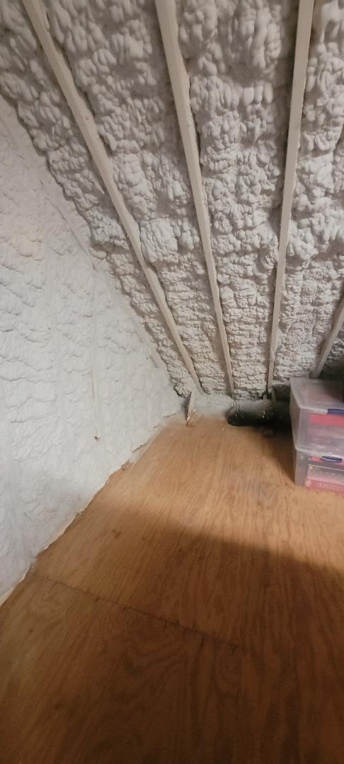

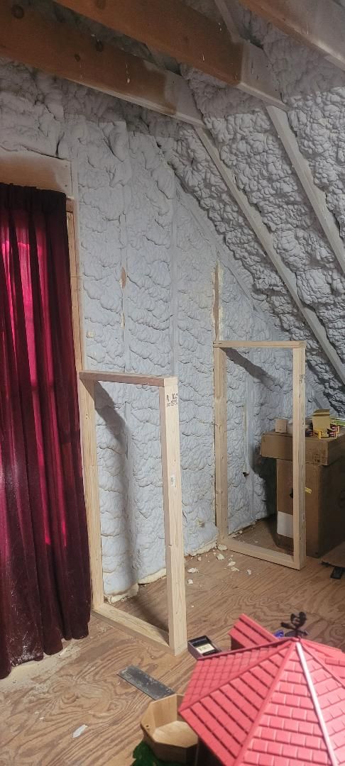

The only place I had to build was the big storage room in my attic.  It is unfinished but we did do spray foam insulation so extreme temperatures are not an issue.  Another plus to building my track up there is it inspired us to get rid of a bunch of stuff that we no longer need!

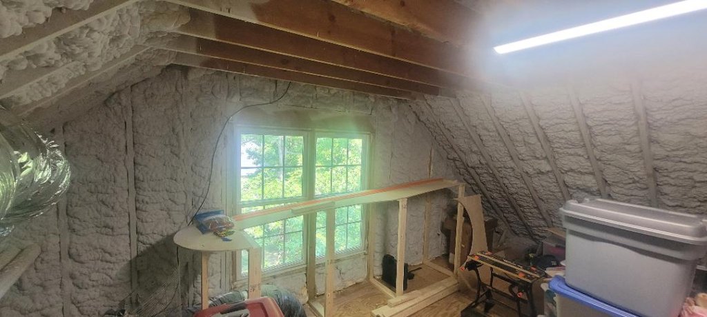

I attached a pic of my area.  The track will run along the wall towards the camera.  It will do a 180 and go back towards that corner in the pic.  There is actually more space now from when I took the pic so those bins are out of the way.   I will do another turn down near that corner and come back towards the camera to the finish of the track.

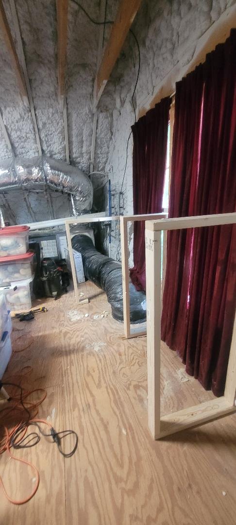

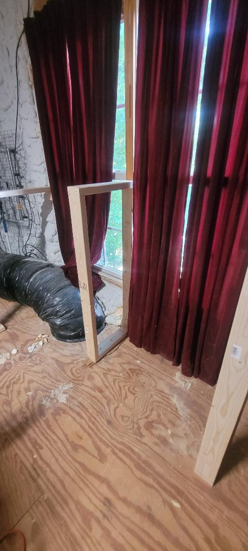

I got 4 supports in for the top row of the track.  The starting gate will be on the support to the right.  I originally had the supports higher up but it seemed too high.  Plus with only 30 feet or so of track, it was going to finish almost 4 feet off the ground.  Seemed a bit too high.  I lowered the supports down 18 inches and it looks much better,

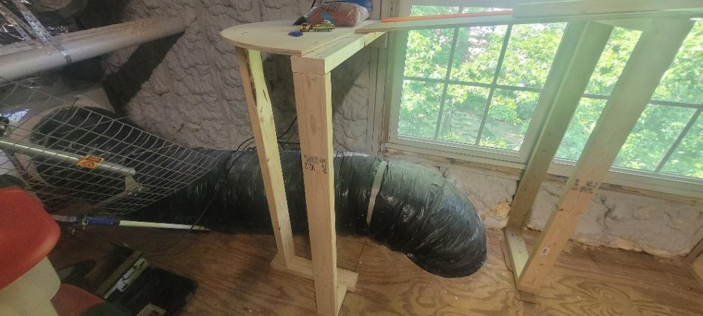

In pic 2, the 3rd support is in.  With the window there, I had to secure it to the floor and then under the window to the center joist.  It is pretty solid and with plywood screwed down to the top for the track bed, it should be nice and secure.

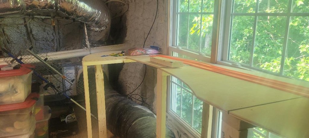

In pic 3, you can see the final support where the 180 degree turn will be to head back towards the starting gate.  I built it over the air duct and will try to keep that open in case any work ever needed to be done on that.

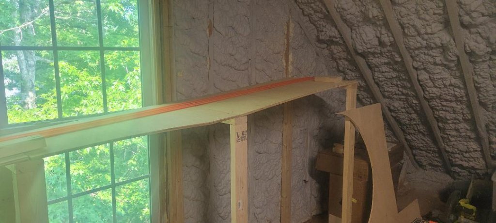

The track bed is down for the top section of the track, using 1/2" plywood.  I bought two pieces of 2' x 4' as those measurements were almost exact fits for the supports I built. I also wanted one 4' x 8' sheet of plywood.  That wouldn't fit in my vehicle so I had them rip it in half.  Unfortunately I didn't realize that would lead to a little more work for me on the track but I think it worked out in the end.
The overall look so far.  After I finished with the top layer, I got a couple of tracks out to begin the testing phase!  Also, the terrible purple curtains are down.  I will put up something over the windows so it can be incorporated into the background scenery.

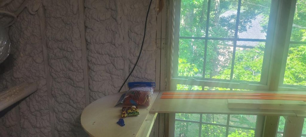

This is going to be the start area.  Testing will determine the height for the start gate and any elevation changes through the top part of the track
This pic shows where I trimmed the plywood to make it slightly narrower in this section.  This will create more room for the track after it does the 180 degree turn and heads back towards the start

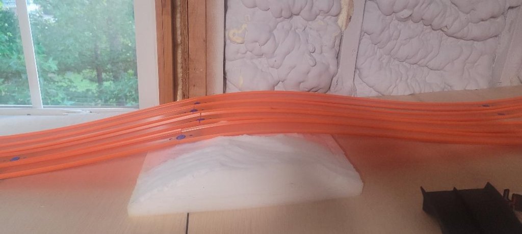

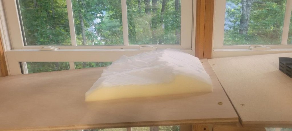

I bought a 3" thick foam sheet from Home Depot and made a couple of bumps.  This is the first one and it will go under the orange track as you will see in the second pic.  The second bump will go under the polywall, just past the first one.  On the first bump, I am going to dig into it a little bit so the track settles down in to it, making almost a track bed.

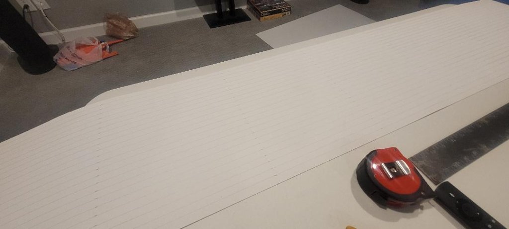

In this pic, I am marking out the lines to cut polywall strips to use as lane dividers after the orange track completes.  I am only going to use the four lanes of orange track for about 4 feet or so.  I cut the polywall with a utility knife and that worked great.

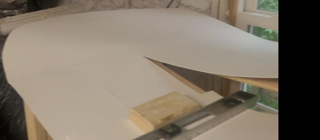

This is the 180 degree turn.  I cut out a semi circle leaving the right and back side higher to create a bit of a bank.  I will be gluing the foam piece down tonight to the plywood.  The foam was a bit of a pain to cut and isn't perfectly smooth but thankfully the polywall is just rigid enough to hide the imperfections of the foam cuts.
