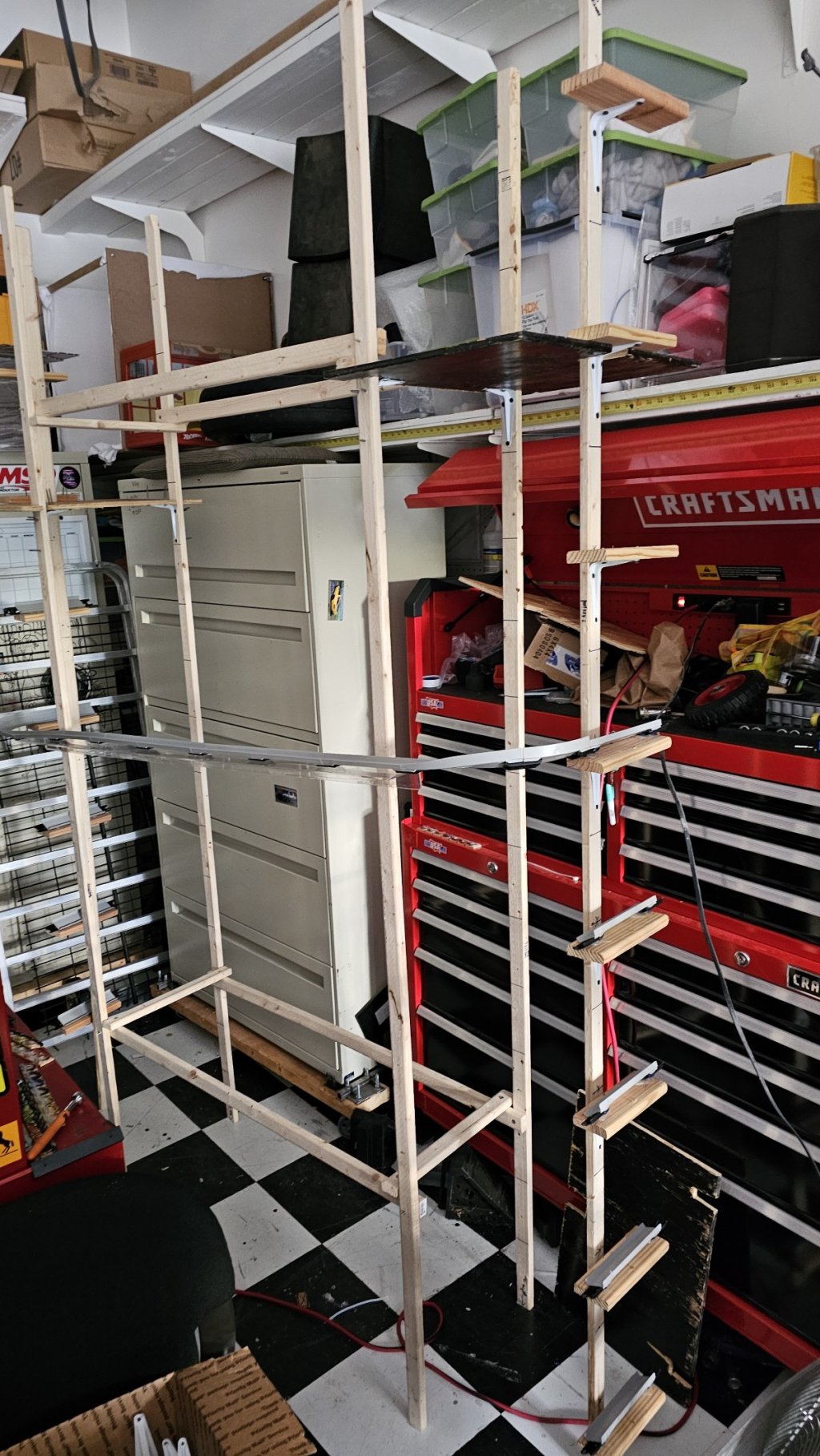

New Track. Widowmaker Tower of Doom - Single lane time trials.
In progress....over 100 feet of track in a small 5 foot by 2 foot floor space area.
All track will be Hot Wheels Turbo Trax gray hard plastic.
For a fun casual track, it maximises the available build footprint. I'm assuming around an eight foot height based on the straight sections being five feet long.

- interesting — dr_dodge
- Great if you have a very small space...with a high ceiling. Looks good! — ManiacMotorsports
- Holy crap, this thing’s real? — alva1370
- That is a great start! Can't wait to see the end product! — JBlotner42
- I would suggest affixing the bottom of the four poles to a solid platform, a rectangle of OSB plywood or similar, to help mitigate the frame swaying as the car hits those turns — Chris_Hood
with every drop, the car gets faster, and faster....
as chris said, filming will be a challenge,
you coud do a "big 0" but tought to film from the inside
also look up tiny cars (big O) as to the challenges thru that many drops
my testing leads me to believe it should be,
drop, flat, curve with drop into 1/2 straight drop, then flat, etc
controls the car speed, more "gas it, lift for corner, out and gas it again

good luck, do small sections first, and test, test, test

I'm dizzy just looking at that thing...good luck
Can't wait to see some cars run on that corkscrew.

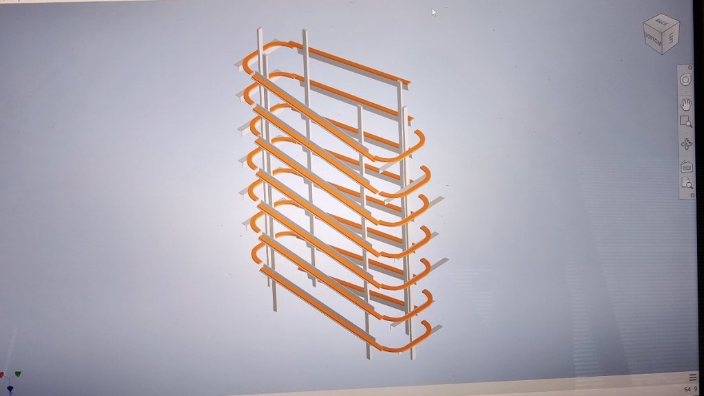

what CAD software is that you used?

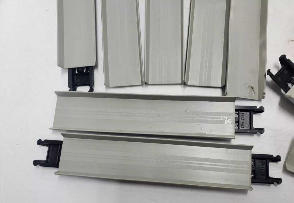

- how many sets is that? — dr_dodge
- About 10 sets total i bought on ebay....i still have a bunch more left than shown here. I will modify the track with curves going through the middle as well. I was mainly testing speed here....i have 6 inch drop between turns. I am going to try to remove the straight piece in the turns as the sidewall height is lower than the curves and causes issues. — WidowmakerRun

- Nicely done with the revisions. — Midwest_Diecast_Raceway
- This is Magnificent. It's also a rollercoaster not a hot wheels track. ;] — LordSyosset
- That grey is very cool! — Midwest_Diecast_Raceway
