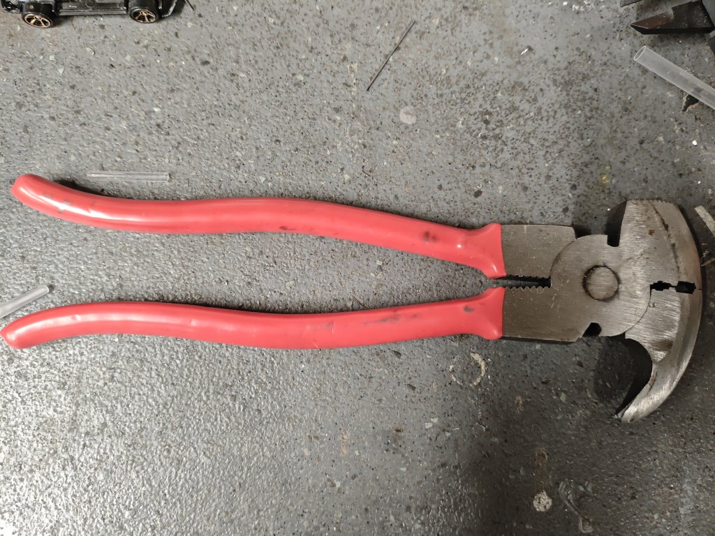

When using piano wire, what is the best way to make the end so the wheel does not slide off?  Anybody?
DXPRacing 5/26/26
  • Hey there I’m sure there are many ways to do this what I do is cut a piece of music/piano wire about a half inch longer than needed. Then I have a large vise grip pliers adjusted way down tight. I then insert the wire about 1/8 inch into the tip of the pliers jaws. Using both hands I squeeze the vise grips to locked position. This mashes the end of the wire flat which will retain the wheel on the wire. Getting it properly fitted once both wheels are on the axle is another trick after which you carefully mash the other end. Great workout for hand strength. — AbbyNormal
  • If you want more details just DM me — AbbyNormal
For Crimping the end of wire or pins use Fencing Pliers, get a cheap set off Amazon as you're only Crimping wire and not using them for their actual purpose so it won't matter much if you don't splash out on a big brand set.
  • Have two pairs, works Great on Barbwire fencing! — Bent_Rod_Racing
  • I've tried using these, but never seem to get a decent crimp on the end of the axle. — SpyDude
