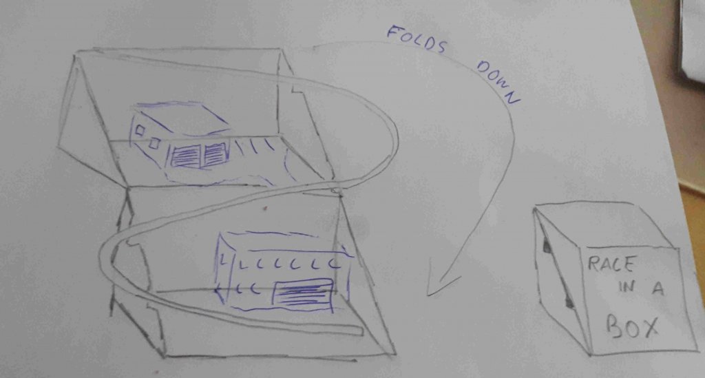

When looking around I saw a picture of the old 1979 Hot Wheels Service Center. And I remembered, that I loved to play with a very similar playset when I was a kid...
Unfortunetly I do not have enoughspace to build a permanent racetrack...but wait...the service center was foldable and a touch of genius in creating long lasting fun...so lets race it.
In the following days I thought about the way to build it, measurements, weights, materials:
- it will be build out of plywood (have enough leftovers)
- it should be foldable like the original
- it should be easy to transport (if needed with a parcel service)
- to fit the regulations for cheap transport it should measure max 120 x 60 x 60cm, <5kg
- there should be place to store some cars and race 2-4cars at a time
-if possible: it would be nice to combine two "race in a box"-tracks to have a longer racetrack
First (very professional) drawings showed a box. Therefore this kind of track is now named "race in a box"

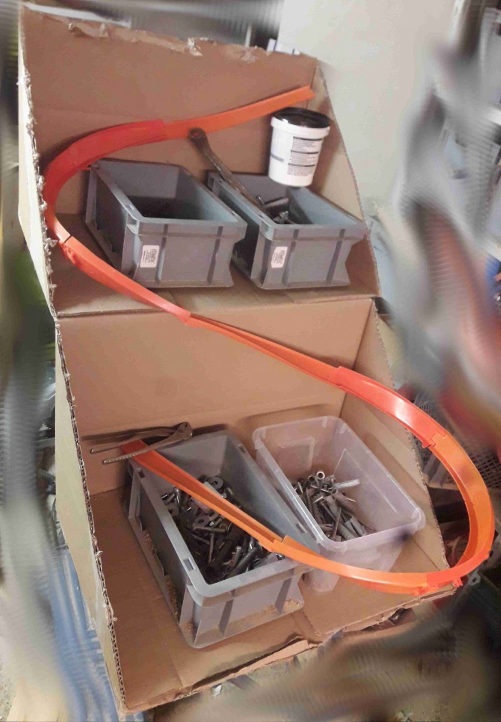

Today I tried a model with some hot wheels-parts and it might work:
As I am pretty busy there will only be little progress, and if the Idea does not work it will be a nice fire later, but the next step is to build the plywood-box.
It would be funny to have a world tour, sending the track with a parcel service or some other stupid stuff next year...

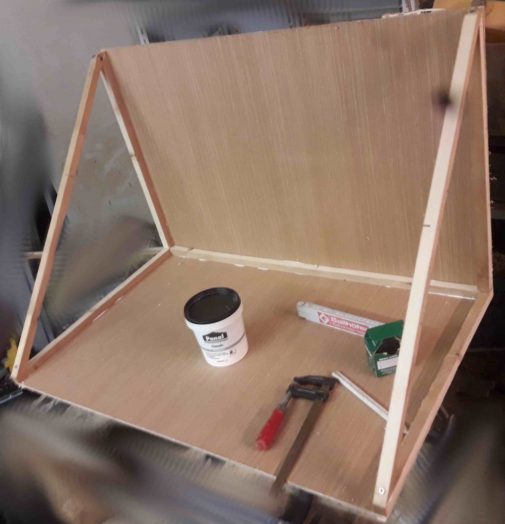

Zapfo2000 10/5/20

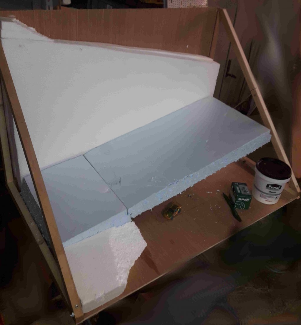

Today I was able to make some progress, but: I failed!
I failed in building a really small and lightweight box:-)). "Unfortunatly" now there is enough space for twice as much racetrack as I planned, the box will be 84xm x 55cm x 55cm in the End, still easy to store.
First half of the box:
 With some support for the track:
Now the white glue has to dry...keep you up to date...

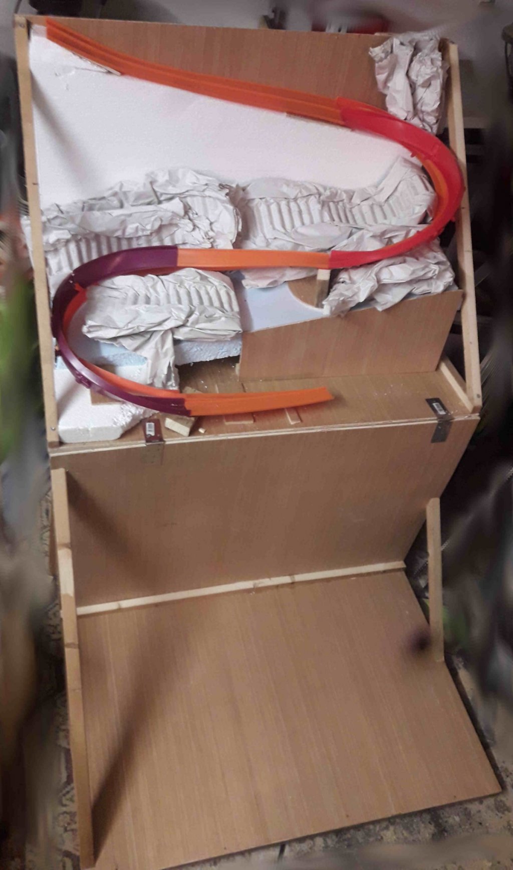

Zapfo2000 10/14/20

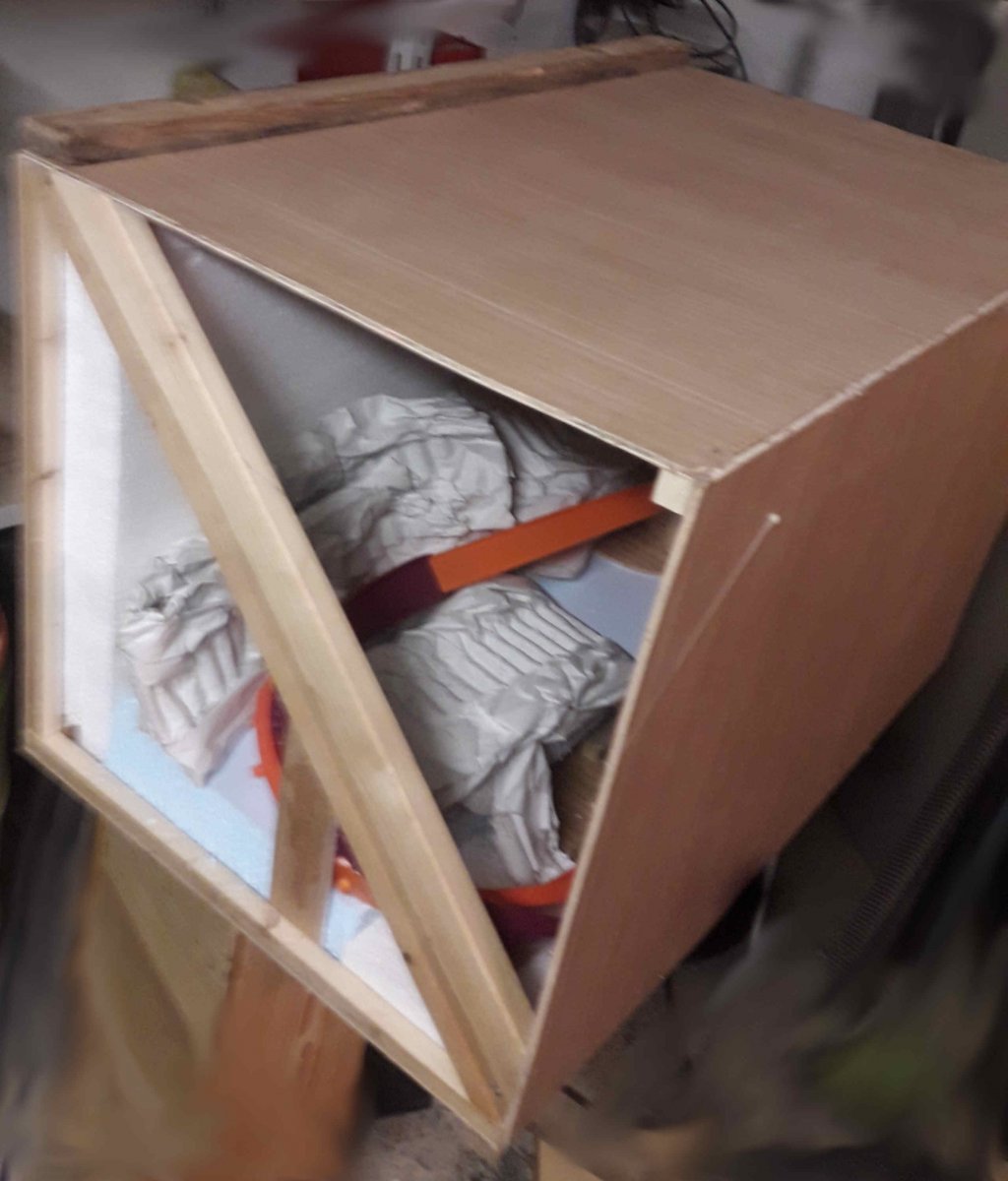

Today I was able to spend some time on the track. Or better: on the box.
There is pretty much space for some more tracks. I needed some attempts to place the hinges the right way, but now it works fine.
And it really folds, you only need to store one box...
Next step is adding the sides and starting with the second part of the tracks.

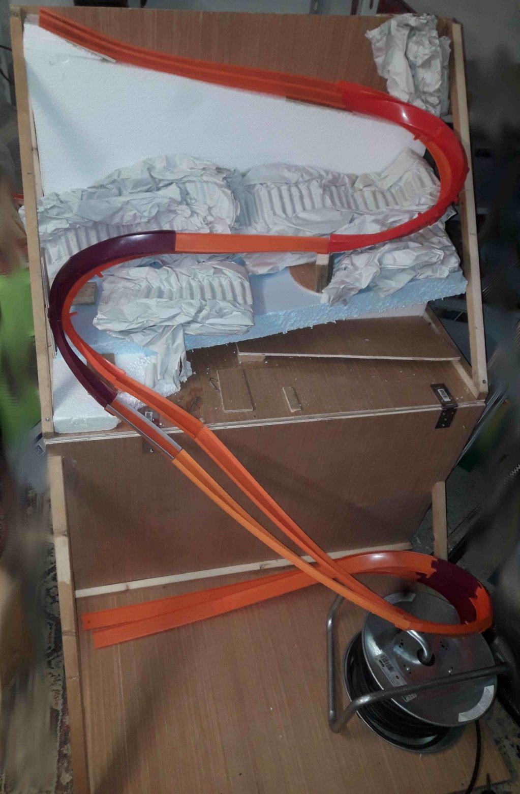

Zapfo2000 10/16/20

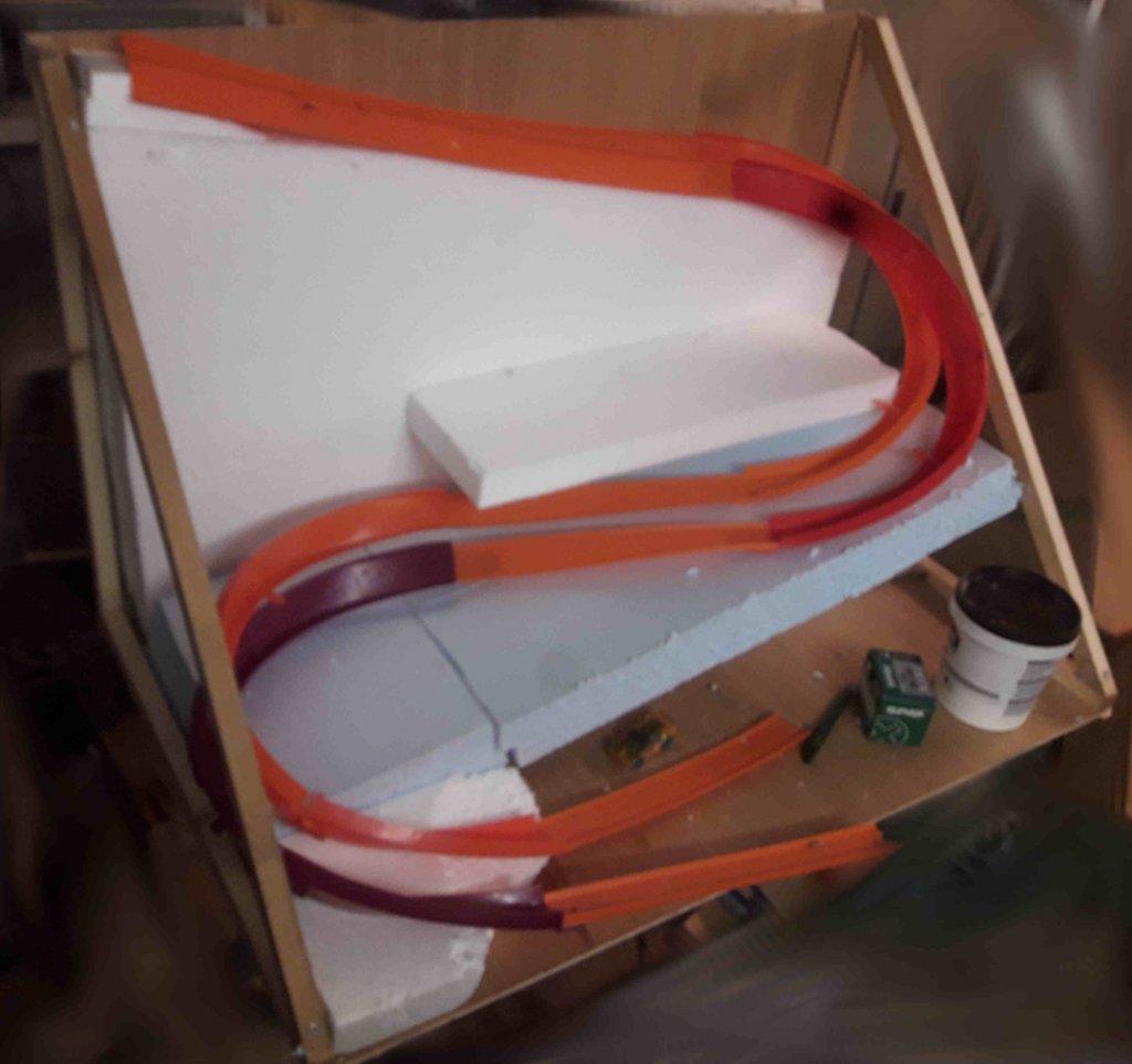

Only a small update:
This might create a little jump in the middle and it will be possible to add track at the begin and at the end of the track...

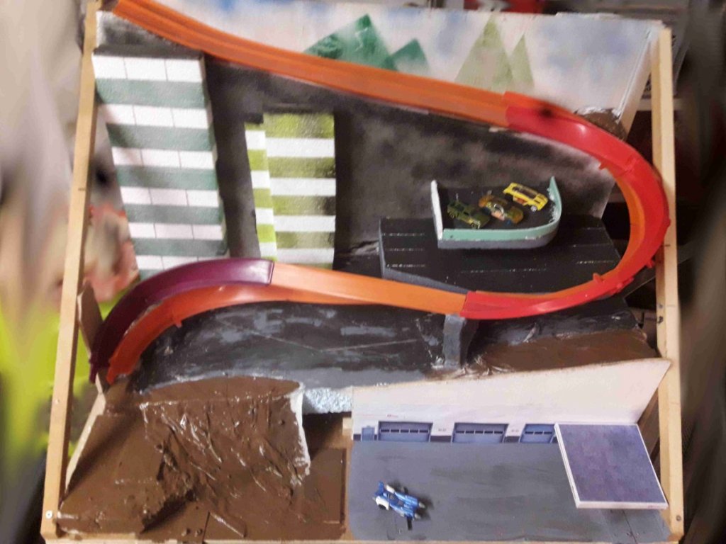

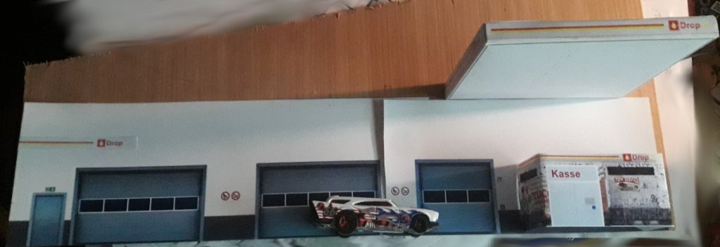

Zapfo2000 10/26/20
First test to build the gas station for the service center. Everything printed on paper and later glued to some pieces of foamboard.

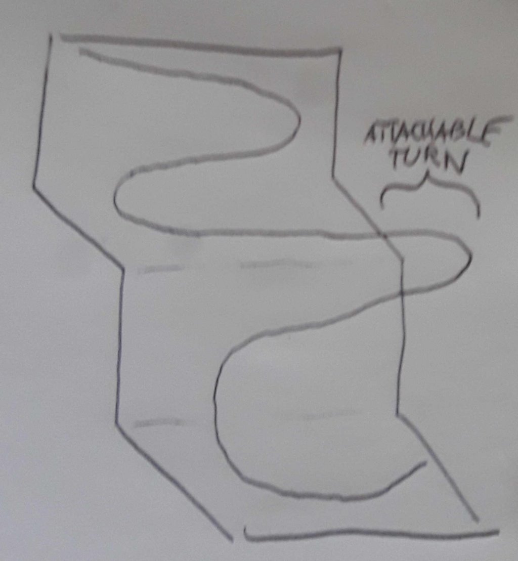

The upper level is now nearly finished. But there are some issues at this point:
The transition from the upper to the lower level can not be build like I showed in the pictures above, "the Whump" would be to nasty for most of the cars. So I remembered the "service center" I owned when I was a kid. The turns were attachable and were placed outside the box when playing with the set and stored inside the rest of the time.
Therefore I will try to build the next turn this way and use them as a transition between the levels. Printing the parts of the turn with a 3D-printer would be great, but as I do not own one so far, I will use HW-turns.
What are some other lessons learned so far?
- first test your track, then build your box! It is much easier that way...
- the box dont have to be that high. The racetrack is getting fast and steep..
- keep the weight in mind. I only use 4mm plywood, some wooden strips for reinforcing the box and some styrofoam for everything else. No plaster or stones...
- maybe it is easier to build only a one laned track with a timer when you have limited space.
But the most important fact: its fun!!!
