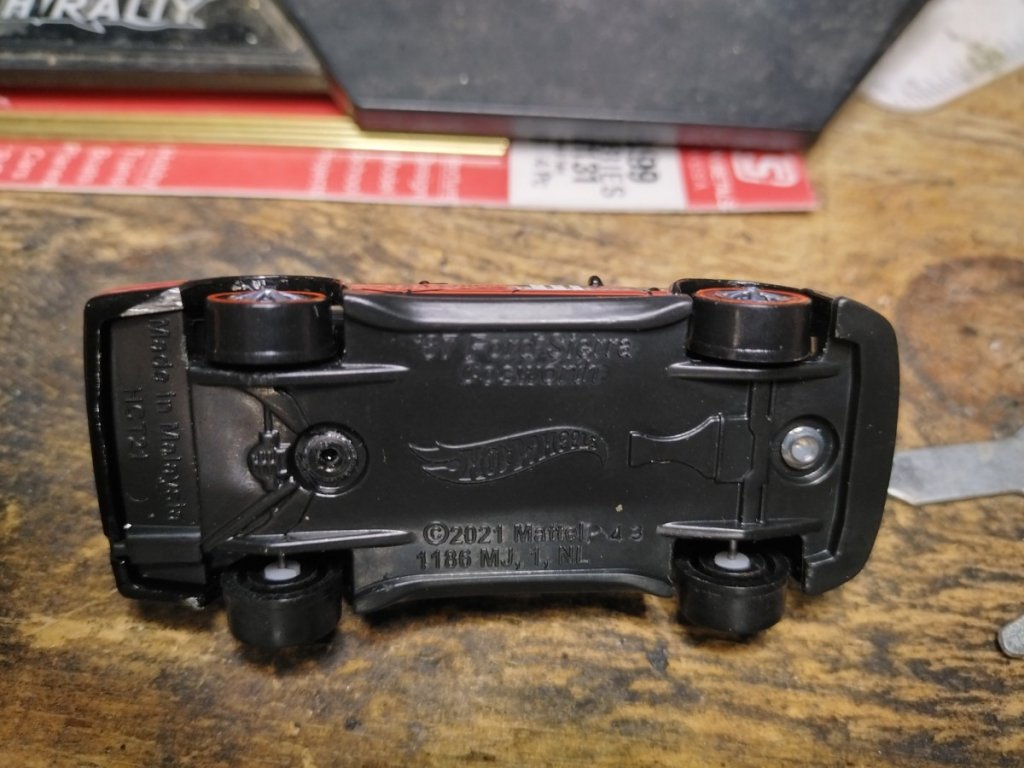

  • How did you swap wheels without drilling it? — SpyDude
  • Cut wheels off axle, snap the bearings onto axle end and push wheels on. Bearings have a slot to fit over axle, when wheel is on it compresses bearing and slot closes to keep from coming off. — Redline_Salvage_Inc

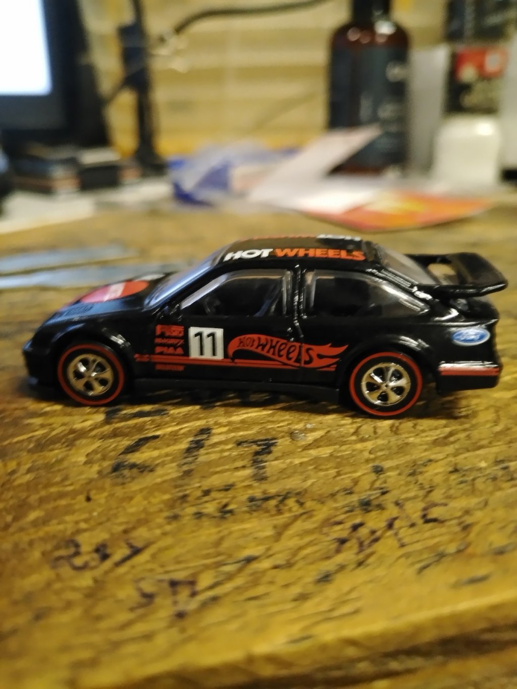

Hot Swap bearings are awesome, kit out any diecast car with Redlines. A restorer and customizers dream, but as far as racing, maybe not so much. On this mainline Cosworth they seem to have locked down on the axle and turn as a unit(both wheels turn). I'm thinking this is where the micro drill bits I forgot to mention earlier come into play. I didn't polish or graphite anything on it. My track is closed at the moment for some road bed improvements, work should be done tomorrow so will throw it down the mountain then and report back.

Like RedlineSalvage, I found out the hard way that these make incredible, but unfortunately, perfectly static display pieces.
But look at that.
  • They could roll if you use tubes and cut own axles to length, but entire axle and wheels would rotate as single unit. Not good for racing but would be a "roller" by definition. — Redline_Salvage_Inc
