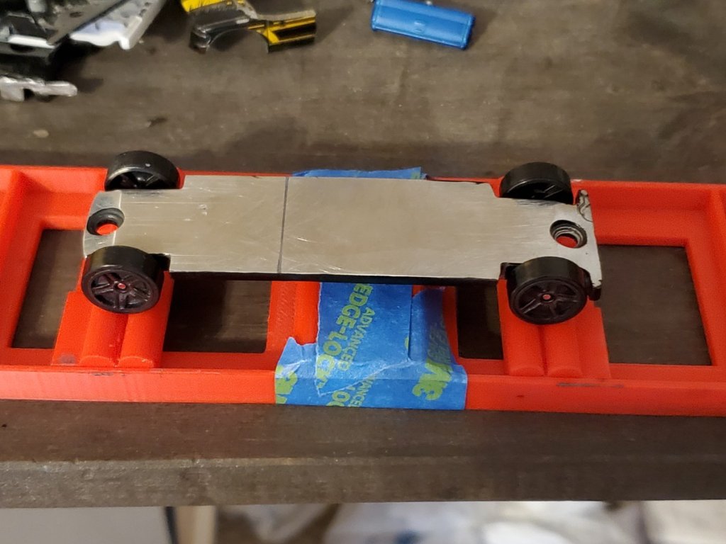

I use the RLD jigs now and will be making a RedPill jig here soon to try out and have in the arsenal. I'm building a long wheelbase mod for an upcoming BlueLine race and needed to tape two RLD jigs together to get the length I needed. Worked perfectly.
Matt

Sorry Redline, I meant to post this a long time ago and just now thought about it (in response to him wanting to see the use of two of his jigs taped together for longer wheelbase mods)
Matt
- Nice! Guess I didn't consider super-long chassis in my design. Maybe I should offer a "special edition" jig that goes longer, ha! — redlinederby
- Shoot so long as they are "square" when made, then this method works a treat! — Mattman213
