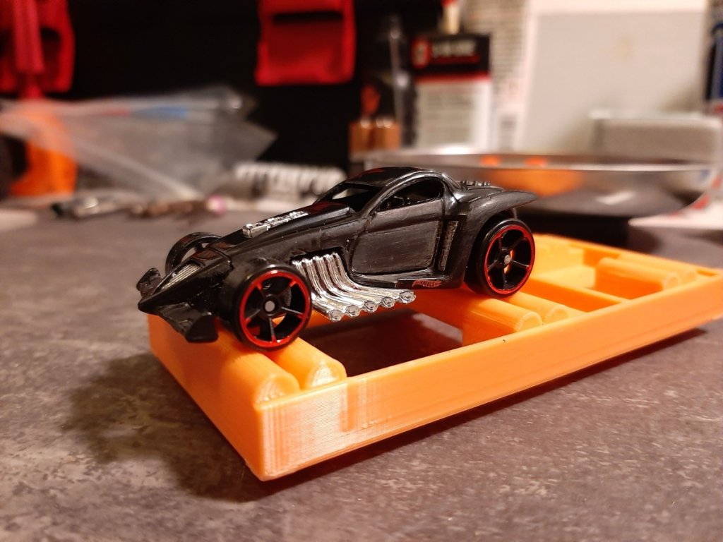

Reassembling my first true modified car that'll end up going to the Rookie Rally. It started as a Burl-Esque, which a coworker gave me for my birthday recently. I removed the front fenders, added a little weight (there's not much room inside this one, and I didn't want to lose the interior), and scored those nice looking wheels from a donor car. The axles aren't fixed, and I haven't run it down the track yet. But they spin REAL nice. And I think it looks killer. What do you think?

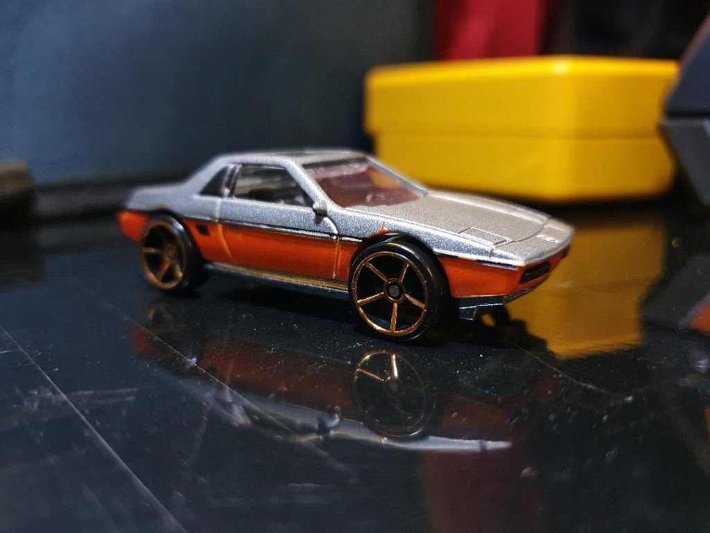

Here's what I started with:
Only had one rivet on the bottom of the metal chassis so that was nice. Drilling was very clean and made for a nice surface. It started out at about 41g so I didn't need to add much weight at all. This was important being a small car.
I don't have a wheel farm and don't even know where to begin for that. I picked up this guy because I knew the wheel size was just the right fit. It wasn't the biggest FTE and it wasn't the tiny FTE. I considered going with small FTE in the front and medium FTE in the back but I didn't think I'd like the look and felt the difference wouldn't be too great to just keep both sets at medium.
Fortunately, the one I was able to find had a great rolling set on it and was able to get those off pretty easily. The difficult part was get them onto the Fiero. Being all metal, the clips holding the axle were also metal. I had to remove the OG axles with wire cutters. I then made the decision to snip the metal clips so I could get the axle in there. Since there are 2 clips on one side and 1 on the other, I was able to take off the single clip and slide the new axles in the side with 2 clips. This held them in place nicely within the groove. I had no jig so I tried using pencils, markers, anything really but they all weren't working like I'd hoped. As I found out, the axles were able to seat nearly edge to edge in the groove and the eyeball test showed they were almost perfectly straight. So I just went with it and JB Weld went right on.

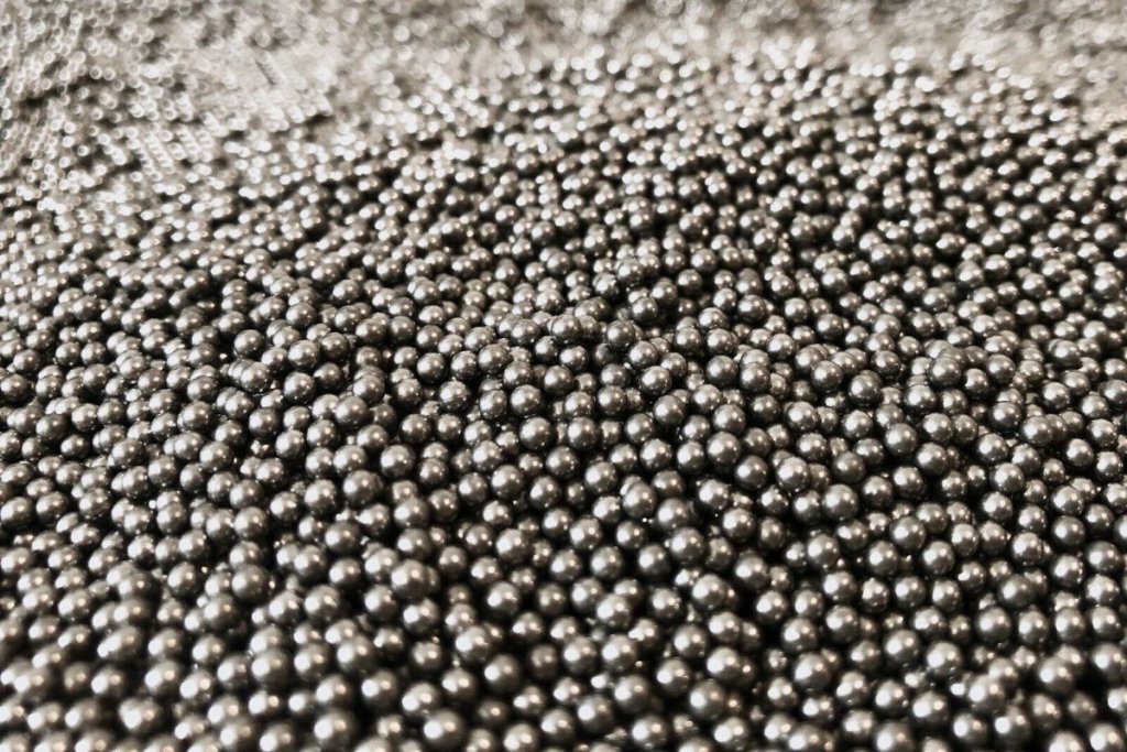

I then added these little guys - Tungsten, 2mm in size each. They all fit perfectly in the trunk of the car and held in place with JB Weld. A good distribution without having to mod the interior much puts most of the weight on the axle itself.
I was constantly layering weights and JB Weld as I went, pushing the weights down as far into the weld as I could. I would weigh all the parts together after every layer of weld/weights. I finally got it to 56.6g and stopped there. I then immediately placed the pieces together and clamped. The chassis had a metal post where a rear rivet normally would be. This poked up into the JB Weld/weights mixture in the trunk, something I accounted for. After being clamped down and curing, I had a mechanical connection and didn't necessarily need to do anything with the front rivet area. However, being 0.4g under weight, I decided to add some of the weights (so small it fit perfectly in the drilled out portion) and added enough to get to 56.8g (about 3 weights). I then topped it with JB Weld and smoothed it out so it looked nice. That brought me to 56.9g and nothing hangs below the base of the chassis.
Overall this was a really fun exercise and I look forward to seeing how it does on the track and what my future mods look like!
- Nice looking castings. And I just realized my collection is lacking in the Fiero department. — redlinederby
- Thanks! I have a dozen so I have...not enough. Was my first car growing up - though it was 20 years old when I got my license lol! — pupulesurfer
- That is a LOT of tungsten - where did you find it? — SpyDude
- Sorry, I wasn't checking often here. eBay of all places! — pupulesurfer

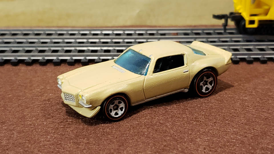

Wow, I guess I'm a rookie even compaired to most of the rookies that will be participating. I've only modded and sent in two cars (Rustbelt Racing) so far. I doubt she'll win but I'll send in The Mistress and see what happens. What's the normal way to cover the fee, Paypal?
- Nice car! Always loved the 70-72 series. — Peter_Bee
- I wanted to make one like I had in HS, but that was a '79 and didn't have the spoiler. I still like how this one came out. — LionHawkRacing
- Well, I put some stickers on it and sent it out. It's not a champion, but I'm hoping not to come in dead last. :P — LionHawkRacing
