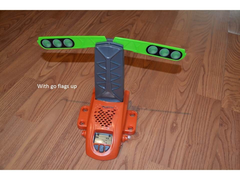

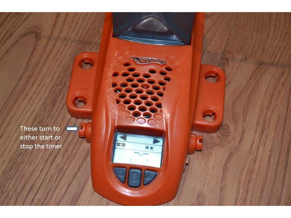

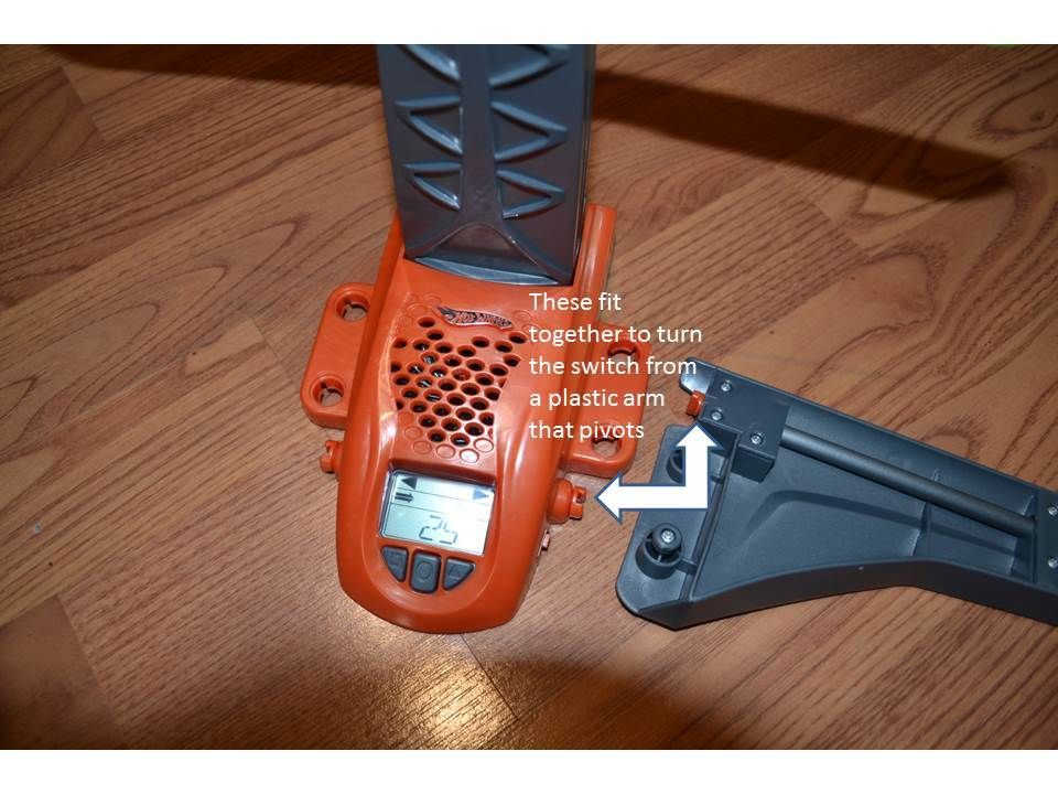

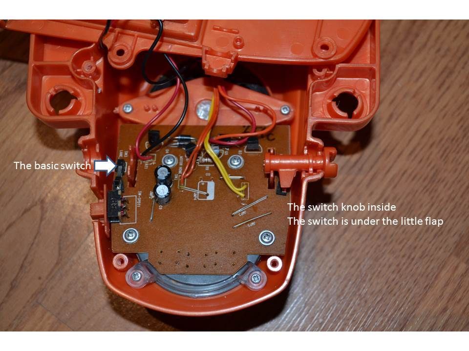

There are no complicated light beams or anything. You run or ride over a plastic bar that turns a knob on the unit. Now that I've opened it up I have figured out how to make it work. It's a very simple switch that stops the timer and shows a false start in lap mode. Here are some before pictures, I'll post after pics an video when complete. This will work great as a 2 lane timer, Hot Wheels should produce this. I paid $13 cdn. I'm just going to add switches that are wired to the unit on the start gate and at the finish. If you have any suggestions please post.

I get it now...simple mechanics with some extra electronics, typical Mattel...but all the better for hacking and modding. I'm no EE but looks simple enough that you could pull out the guts and put it in a different case for a diecast finish.
What does the LCD show? Time difference...what does it claim to measure?
BTW, nice photos and annotations...very clear to understand.
