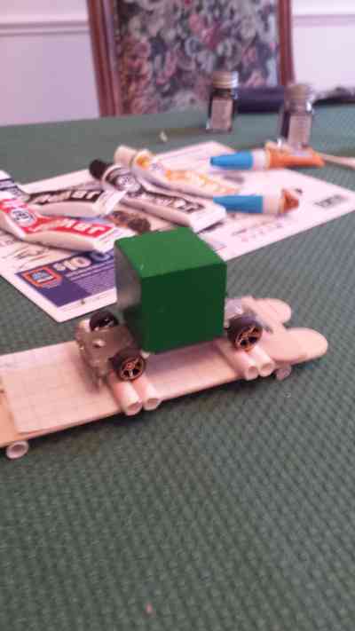

Just a prototype, going to be making major improvements on more stable/stout models here shortly.

The fun part for sure,we have success!!Got this boy back together ,55 g,one of my fastest cars now..
Yep it is all about the fun,great to compete,but even more fun feeling like you took a dud and made it into a fun car..
Sorry had to post a couple pictures...:>)
