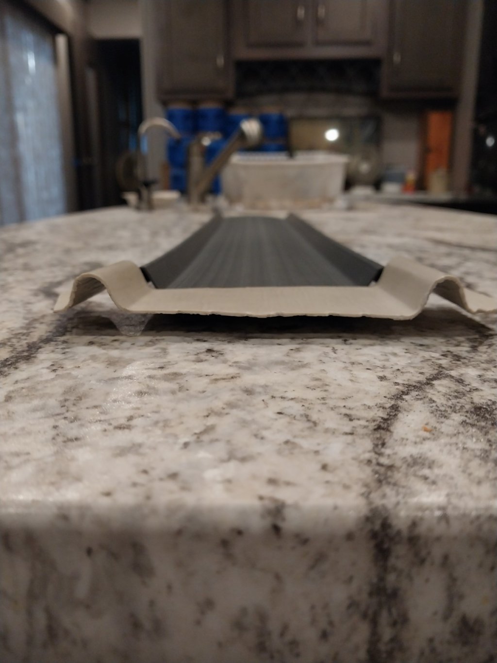

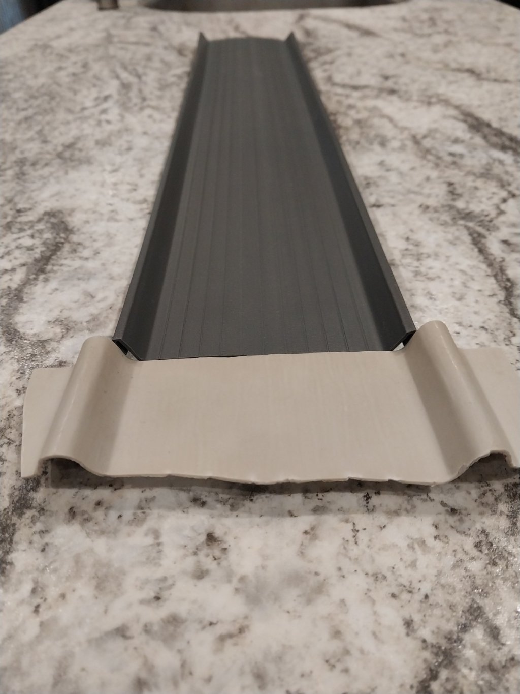

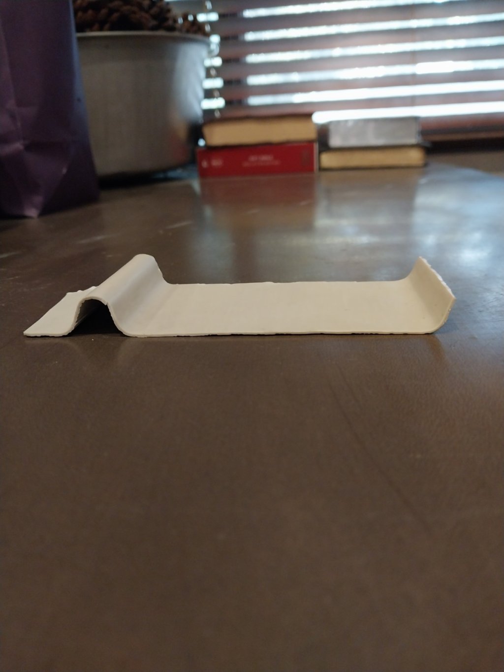

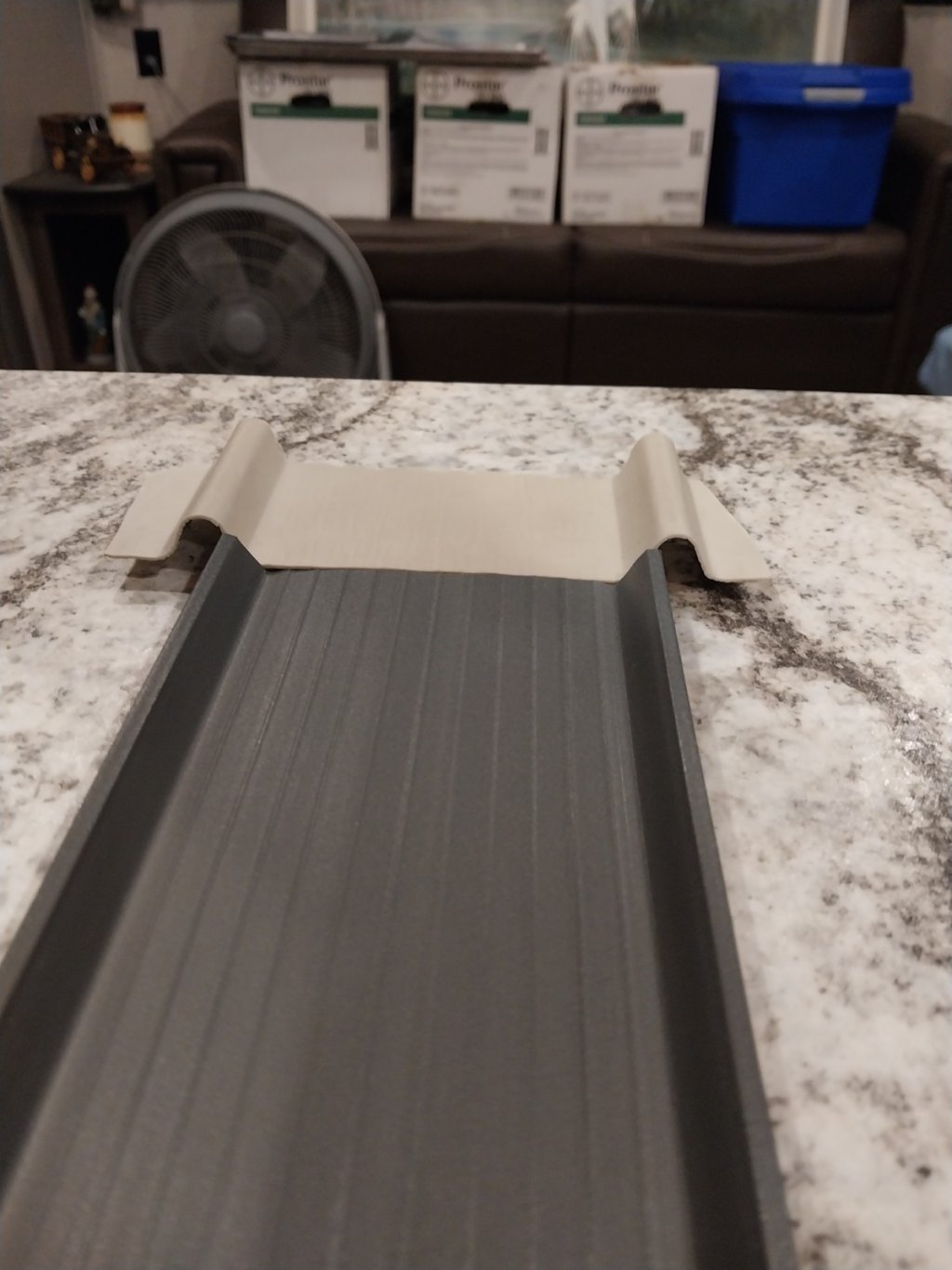

I've been testing vinyl soffit for my open straights, I'm liking it and believe it's gonna work fine. Depending on how you cut the sides or walls a 12'x12"×4" piece will give you 12 to 36 feet of open track for about $20.00. It's a 1/4 inch wider than crash racers but that's an easy fix and the seams match up really nicely.

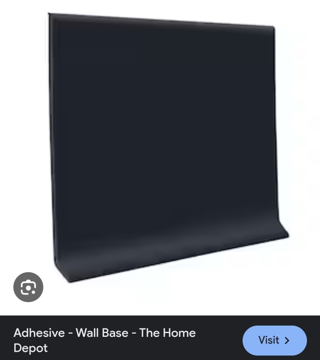

For a second I thought that was the same stuff I'm using, but I looked up vinyl soffit and that's not what I have; I have some thing that is like rubber and bendy but I have no idea what it's called. I was at Lowe's a few months ago when I spotted it stacked on the shelf with no packaging. It looked like 1/64 road so I grabbed a whole bunch of it.
  • You mighhave found some cove base. I wonder how the wheels will like that rubber. — AllEight

  • What you end up with depends on what you start with and how you cut it. A 12'x12" piece cut like mine or what I call with walls will give you one 12 foot run. If you go with what I call sides you would get two 12 foot runs, that's 24 feet of track for around $20.00 With the test I've run I don't believe ribs will be needed. If I was buying new I would go with 12'x16"x4" that would give me two 12 foot runs with walls for around $25 No special brand. — AllEight
