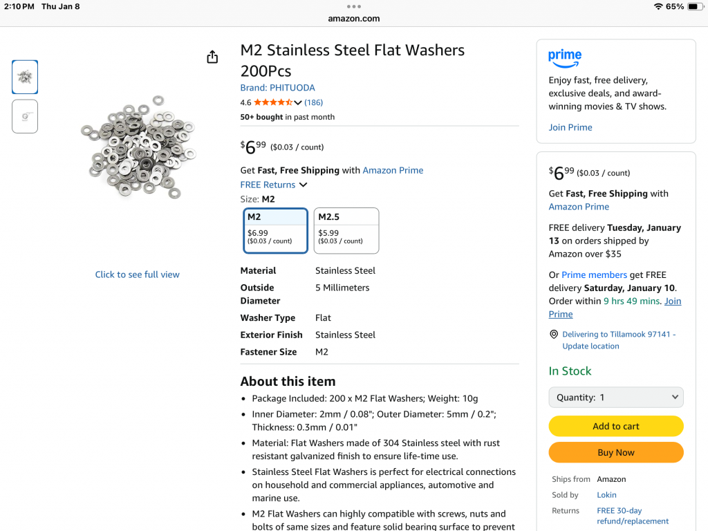

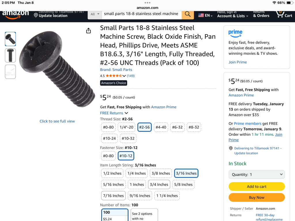

AbbyNormal 1/8/26
I'll PM you some links to Amazon for screws and washers that fit perfectly

AbbyNormal 1/8/26
Just to follow up these screws will self tap just fine - depending on your drill bit size you may need a small drop of oil in the hole. I've recently moved to a slightly bigger bit and the screws go right in. Unfortunately I'm out of town this week. The bit size is one up from a  1/16 bit
  • 5/64. I do the same...just screw the machine screw in. Zamac is soft enough that a tap isn't really necessary. — Ruckus_Racing

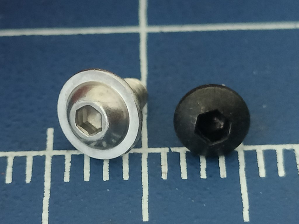

FastEnuff 1/22/26
I've been using these 2mm hex screws with built in washers.
  • They look like they’d do the job! — Road_Runner_Rumble
  • They work well. I use the 3-4mm length. The built in washer is the same 5mm OD as the washers I was using. — FastEnuff

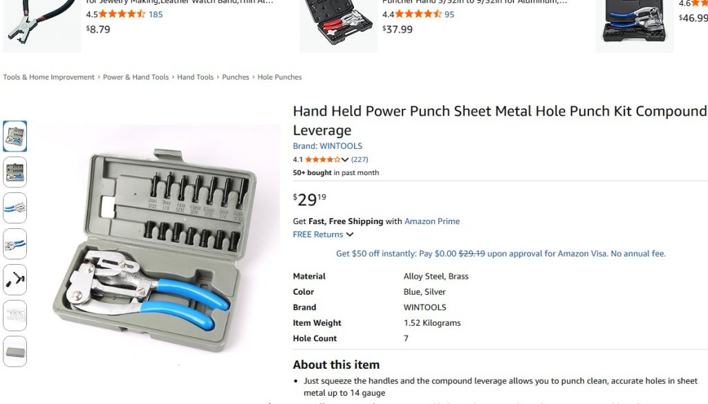

well, since I am a nut, I make my own out of brass flat stock
drill the hole the same as your post,
then figure how wide you need it
and use this
It will change your life...lol
I never buy washers, pop them out of scrap
does alum, steel, brass,
but it always fits your screw
