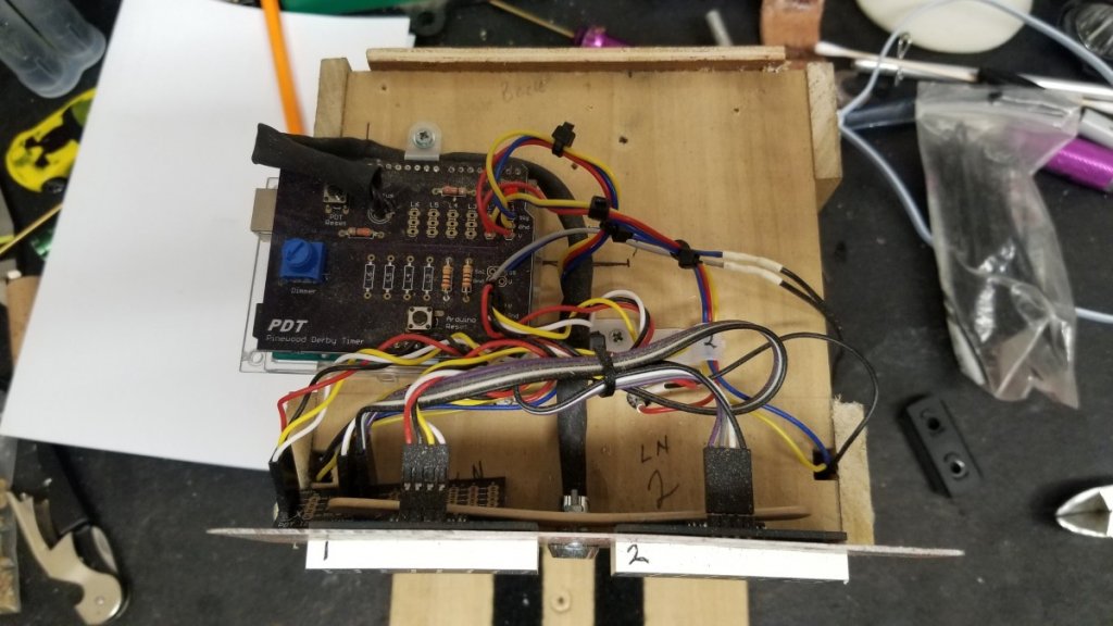

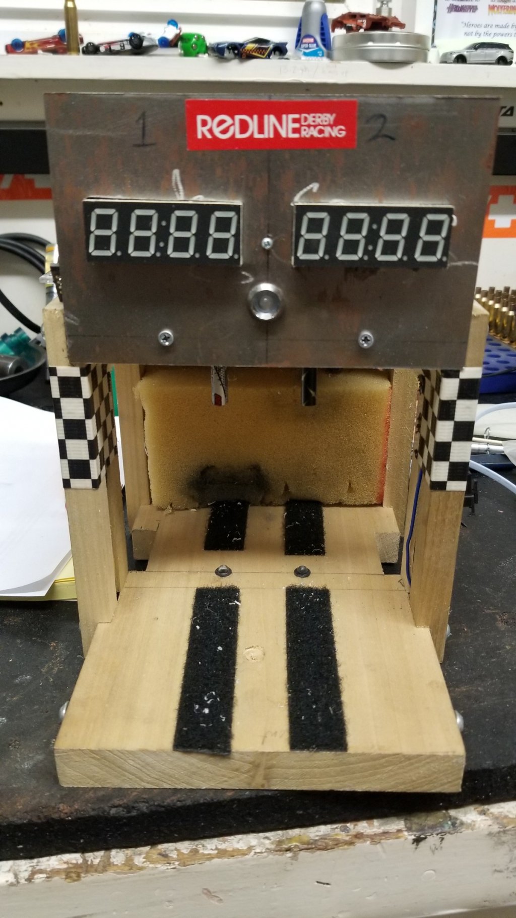

Go_Time 3/22/21
Ive built a couple of timers using dfgtec.com.  They sell all the parts you need to build the timer (except the Arduino). You will also have to build the actual finish line structure.  It looks very complicated at first...but the instructions and diagrams are very clear and straight forward.  The website also has the program you need for the arduino all you have to do is download it.  You will have to do a bit of soldering...Good luck.
www.dfgtec.com/store#!/Race-Timer/c/59665821
  • Great link...I'll have to check that out. I'm really wanting a timer finish and am just not sure where to start for parts. — redlinederby
