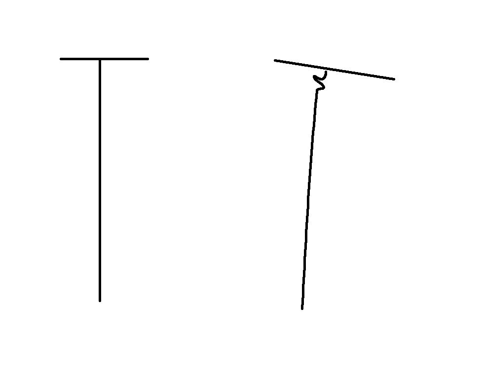

I have found while sorting wheels and axles, (inspecting w/ a jewelry loupe)
some axles are distorted right below the head
They must be friction/pressure flaired and some axles get a bit squashed
they look like this below.good one is straight, and head is square to the axle
I toss the distorted ones

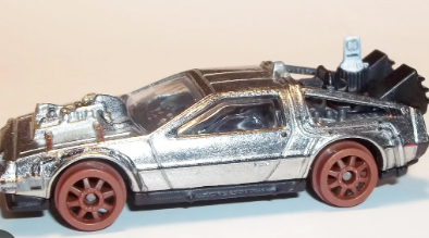

That's a great question Jim and I'm glad you posted the question! This site should always be a welcoming place for newcomers to ask questions and get helpful answers from experienced builders.
I had the same questions regarding cut wheels the first time a saw them in a drag race competition. They look like the wagon wheels from the Back to The Future 3 DeLorean casting.
Reducing the size of the footprint of the wheel reduces contact and friction. The same concept as wheel coning. There are some guys in this hobby that can take a stock wheel and cut it down like this. Either with a drill and blade, or a lathe machine. I tried it myself once without much success.
