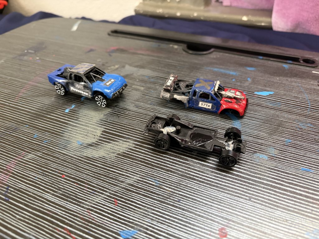

What Tires are Best for a Baja Bouncer?
What Other Plastic Tires Would You Recommend?

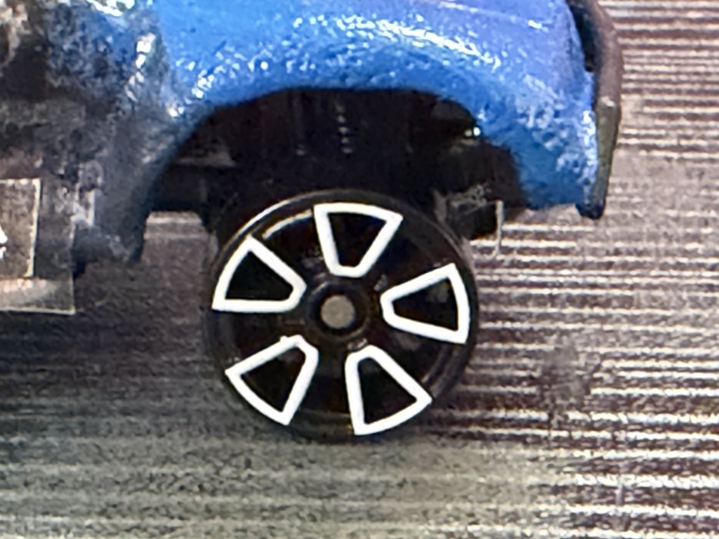

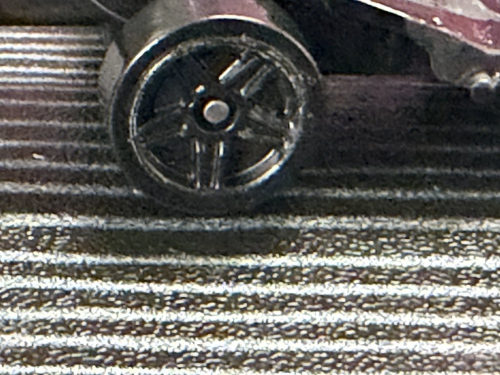

Good wheels come in plenty of different types so when you're showing me TRAP5 versus PR5 that's two examples out of literally millions even within those styles. You'll find gems and duds in both. This is why testing and wheel farming are important building steps. If you insist on TRAP5 (first closeup photo) and will race with a lot of narrow lanes, sand the sides to get rid of those white bits until they're flush with the rest of the wheel

The Trap5 is notorious for climbing the track wall and causing the car to jump the track, it doesn't happen all the time but there us always a chance it does with that particular wheel.
