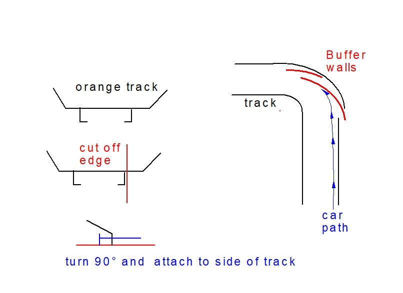

I also had to use buffer walls (nice term) to solve a problem on my jamestown bypass track
I cut strips off of orange track and used the outer wall as an overhang to stop the flyoffs and roll overs
had to use 2
a simple diagram to explain

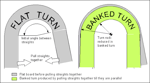

All of mine are custom and everyone is slightly different depending on the space I had for the turn, so i don't have any templates sorry. If you want to add any bank to the turn at all, you want to make the actual turn less than what you want then pull the ends in - see below. This pushes the outside edge up, adding bank to your turn.
  • Much appreciated! I'll try to apply this concept for my banked corners. Can I also ask if you have a copy of a fat track straight on how many cm it is wide and long? — RedBoarRacing
