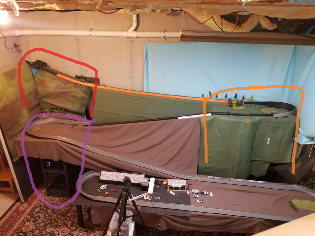

Here is a picture of our track when it was in final testing and before all the pretty stuff was added.  Area #1 is made up of four levels of plastic shelving.  I dont know the brand name.  Picked it up at Home Depot.  I place a terrain piece on top of the shelving that has the starter gate.  The total height is 70 inches.  Area 2 is another 4 shelf plastic shelving unit.  I built another terrain model to sit on top of this shelf unit that has turn one and has an extention that extends off the shelf to provide a smooth transition into the next downhill.  Area 3 has a different plastic shelf brand.  Much smaller.  You can just see the legs of it under the trun.

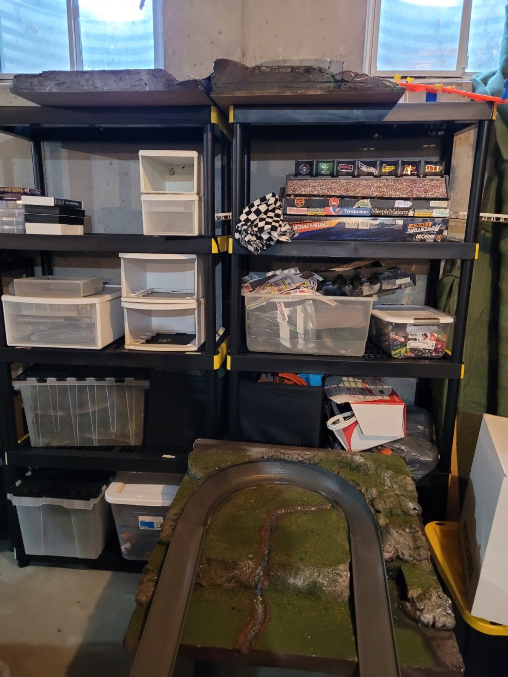

Here are the shelves being used to store the terrain and other items when the track is in storage.

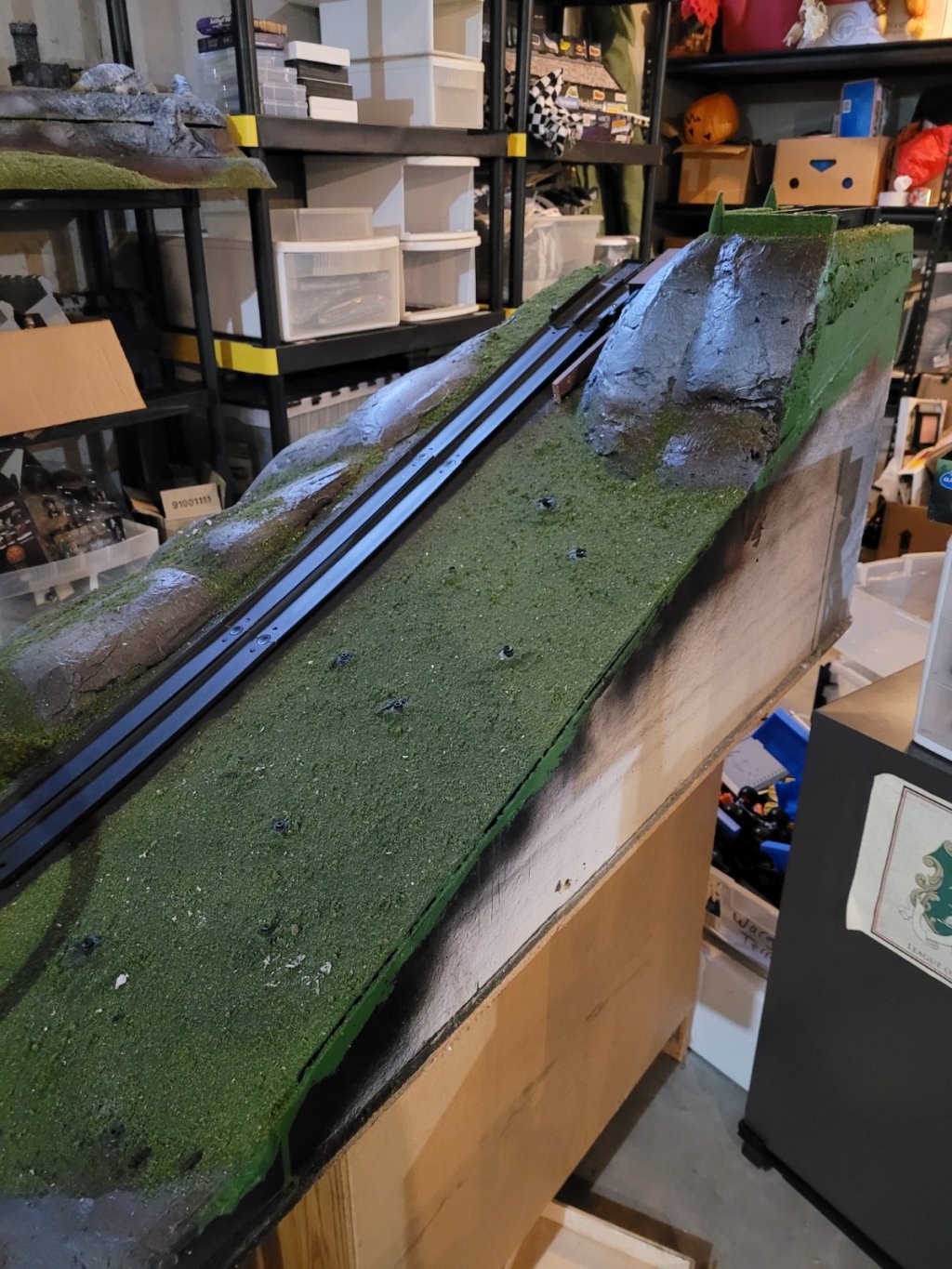

Here is an image of the starting gate terrain model i place on top of the plastic shelving.
  • Tom, Thanks a bunch. This is exactly the info I was looking for. I have a little different idea I want to try for the transitions. If I go with the cut up HCD for subroadbed/track base I should be able to remove some of the door filler and kind of cookie cutter the entrance and exit of the turn then flex and shim the door skin to match the track grade profile I want. I can't wait to get started. — PagodaRacing
