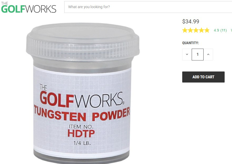

I've been experimenting with Tungsten powder for a while now... I discovered it through the sport of golf, as many golfers add it to the head of a club to improve swing speed and drive force. They drill a hole in the bottom head of a 'wood' and fill it with the powder and cap it off with epoxy. I've been using it in conjunction with gel super glue and baking soda to fill in plastic body molds and castings that have those hard to fill crevices. It definitely allows for a broader range of weight placement possibilities! I've also experimented with mixing the powder with a water-based PVA glue such as 'Elmers' to fill various interior components. I have yet to try the resin technique, but it looks promising! Good stuff... Keep experimenting!

the tungston is expensive.

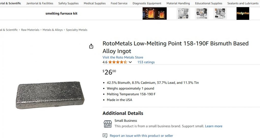

I'll stick with my low temp casting metal
cheaper, pours into plastic lowers, never seeps out
- Yeah I've seen StoopidFishRacing melt this alloy into his builds, a fascinating take on weight addition in tiny spaces where carefully tooling a lead slug can be prohibitively difficult — Chris_Hood
