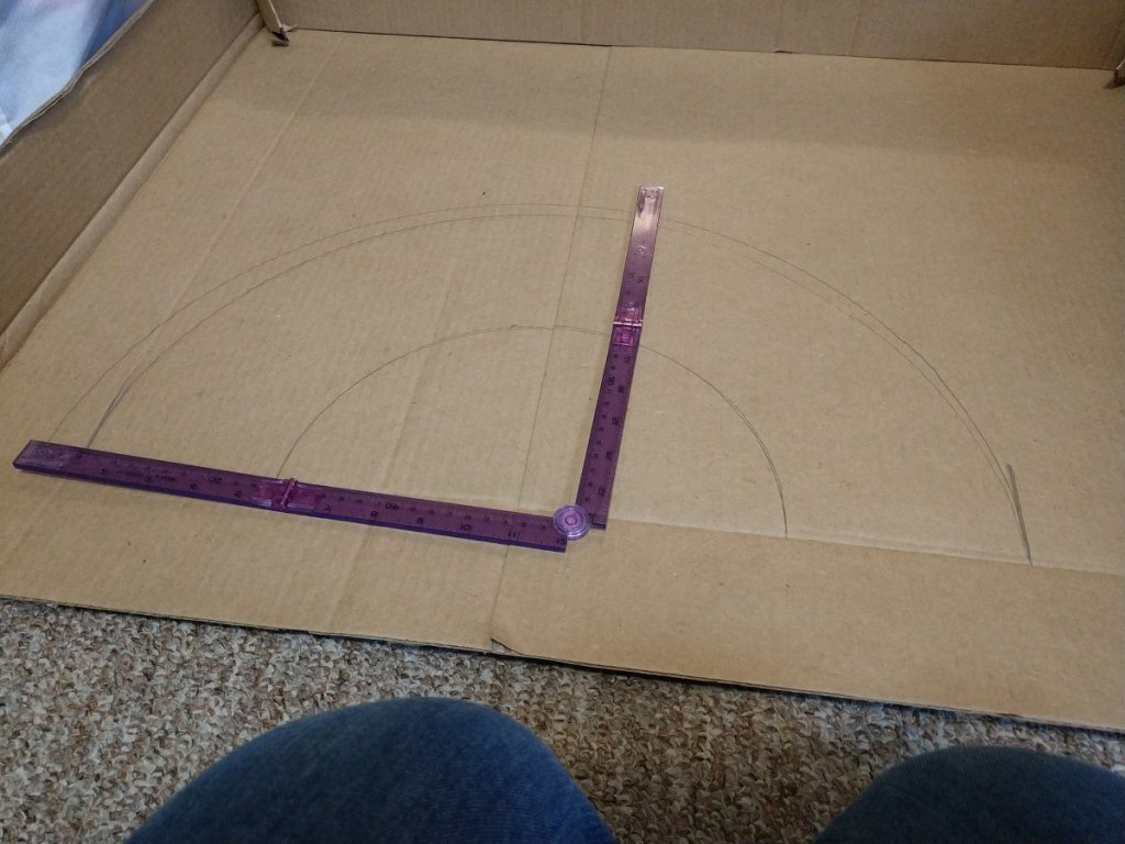

My parents sent AB a big present (Hot Wheels!) in a large Amazon box. It gave us two generous sides of cardboard, so I grabbed the duct tape, ruler, pencil, and the razor to see what could be made of them.
In this house we are fans of Beaverworks and the Chaos Canyon. Both make great videos of their DIY tracks. Thought I could make a hairpin turn like the ones they have.
Take 1: My first attempt was to small. I cut out a few semicircles, glued them together, and taped on a big wall. They attached to my fat track without a problem, but the cars that didn't like the setup.
The turn was too sharp. The cars (including the duck) crossed from track to cardboard no problem, but ran right into the wall. None of them made it around the horn and out of the turn. As you can see, ole Duckie made it to the edge but had already lost all momentum.
